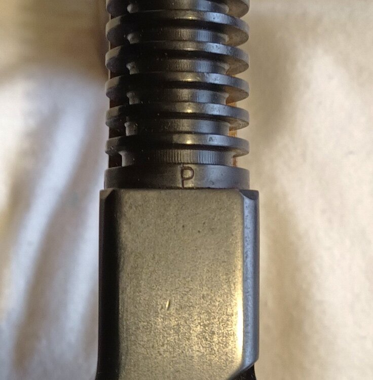

TD. Posted April 24, 2025 Report Share Posted April 24, 2025 Patrick Vdv, I am not seeing the picture of the "P" or proof mark stamped on the top of the barrel. I want to see if the stem of the letter P touches both the barrel collar and the end of the receiver. Link to comment Share on other sites More sharing options...

Patrick Vdv Posted April 24, 2025 Author Report Share Posted April 24, 2025 12 minutes ago, TD. said: Patrick Vdv, I am not seeing the picture of the "P" or proof mark stamped on the top of the barrel. I want to see if the stem of the letter P touches both the barrel collar and the end of the receiver. Link to comment Share on other sites More sharing options...

TD. Posted April 25, 2025 Report Share Posted April 25, 2025 Patrick Vdv, Thank you for the additional picture. I have little doubt your Savage Thompson was used by British forces during World War II. The military in Great Britain was asking for more and more Thompson guns when your Thompson was shipped to Great Britain in 1940. Each one was very valuable. No doubt it was put to immediate use. I would guess the original finish showed a lot of wear when the decision was made to re-blue it. I know the fore grip is not original. I would guess the same for the (pistol) grip and butt stock. That said, you have a very nice example of an early Savage Thompson with a New York address. If I lived in Belgium, I would try to buy it from you. TSMG28 is the authority on everything drums and magazines for the Thompson gun. If me, I would not use the West Hurley L drum and find a WWII L drum. You can always sell the WH L drum to offset some of your costs. Generally speaking, the WWII L drums fit and run nicely. One with the "U" marking (United Air Cleaner) on the faceplate would be perfect for your early Savage Thompson. Many other Savage Thompsons do have more markings on the left side receiver. The Thompson submachine guns purchased by the U.S. Army will have "U.S." and "A1" nomenclature markings added as well as ordnance inspectors' initials (for example: R.L.B.) and an ordnance mark (wheel or flaming bomb). Some guns purchased by the British under Cash & Carry will have the W or Woolwich mark inside a Crown stamped on the left side receiver, usually near the GEG stamp. Guns from other Allied forces may have different markings. Welcome to the wonderful world of Thompson submachine guns! 1 Link to comment Share on other sites More sharing options...
Patrick Vdv Posted April 25, 2025 Author Report Share Posted April 25, 2025 12 hours ago, TD. said: Patrick Vdv, I am not seeing the picture of the "P" or proof mark stamped on the top of the barrel. I want to see if the stem of the letter P touches both the barrel collar and the end of the receiver. Is this OK? Link to comment Share on other sites More sharing options...
