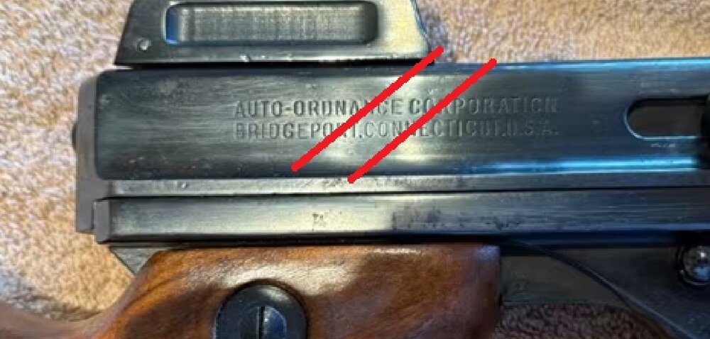

Stampcollector Posted April 29, 2025 Report Share Posted April 29, 2025 Is it a reweld? Link to comment Share on other sites More sharing options...
Motorcar Posted April 29, 2025 Report Share Posted April 29, 2025 35 minutes ago, Stampcollector said: Is it a reweld? I think you are on to something. Polished blemishes on the sides of the receiver, cut thru the ejector port and opposite side in front of the ejector, and by the Auto Ord stampings and nomenclature on the opposite side again. This is why they polished it out bright and reblued to cover up the welds. "Mint".... Link to comment Share on other sites More sharing options...

Doug Quaid Posted April 29, 2025 Report Share Posted April 29, 2025 (edited) I make my living replacing stuff that the government allowed to rust away. One time I held up a nugget of rust to my daughter and said, "This put you through college." Know what I never see? Rust pits in a straight line. But I do see mint, collectable weld defects like porosity in a straight line. At least the guy didn't say it was "taken from a dead German officer." Edited April 29, 2025 by Doug Quaid 1 Link to comment Share on other sites More sharing options...

Chappy Posted April 29, 2025 Author Report Share Posted April 29, 2025 1 hour ago, Doug Quaid said: I do see mint, collectable weld defects like porosity in a straight line. So the GB seller is selling a reweld without even knowing it? Good call and thanks. Like I wrote before, I am happy with my gun but this one looked just wrong. When you find a unicorn, check the horn. Link to comment Share on other sites More sharing options...

shadycon Posted April 30, 2025 Report Share Posted April 30, 2025 13 hours ago, Doug Quaid said: I make my living replacing stuff that the government allowed to rust away. One time I held up a nugget of rust to my daughter and said, "This put you through college." Know what I never see? Rust pits in a straight line. But I do see mint, collectable weld defects like porosity in a straight line. At least the guy didn't say it was "taken from a dead German officer." If welded they did a good job replacing the lettering. My thought is that it was severely rusted and buffed/polished. Link to comment Share on other sites More sharing options...
Doug Quaid Posted May 7, 2025 Report Share Posted May 7, 2025 On 4/30/2025 at 8:26 AM, shadycon said: If welded they did a good job replacing the lettering. My thought is that it was severely rusted and buffed/polished. I cannot say for sure just from the photos, but that "disturbance" of the surface seems to be in a straight line. That is a common thing to see on rewelds. It's often very obvious, but in this case it's faint. The guys who rewelded Thompsons back in the day seem to have had problems with weld porosity, which isn't surprising because there are about 30 different things that cause it. The weld porosity looks like rust pits, but the give-away is that they occur in a zone that is straight. Of course, it could just be a coincidence. Link to comment Share on other sites More sharing options...
Doug Quaid Posted May 7, 2025 Report Share Posted May 7, 2025 (edited) That being said, if the gun isn't a reweld, it's still on the very bottom of the heap of WWII guns. Maybe the seller doesn't know the difference, but calling that a "mint collectable" is kind of hilarious. The good news is that it doesn't have drum slots cut into the mag well. You see that on some M1 make-overs. It might make a nice shooter if the proper M1A1 parts were put back on and it was parkerized to get rid of that badly done blued finish. If it's not a reweld, it might be worth $20k. Just my 2 cents on it. Edited May 7, 2025 by Doug Quaid Link to comment Share on other sites More sharing options...
