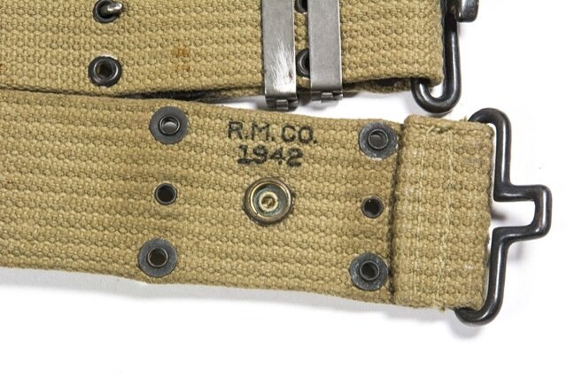

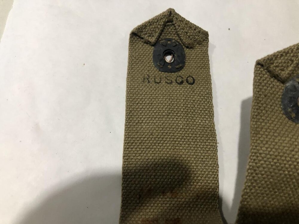

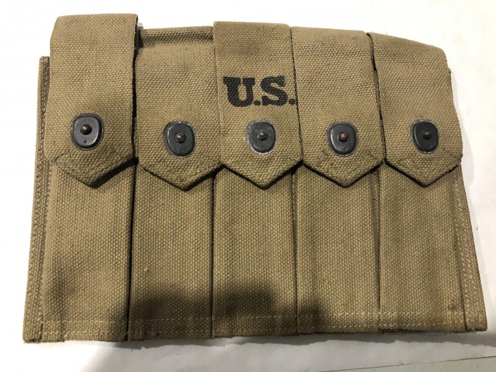

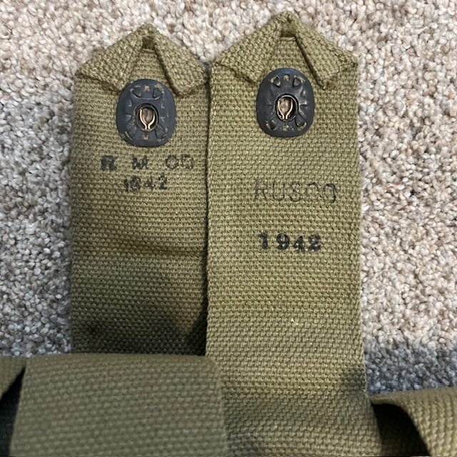

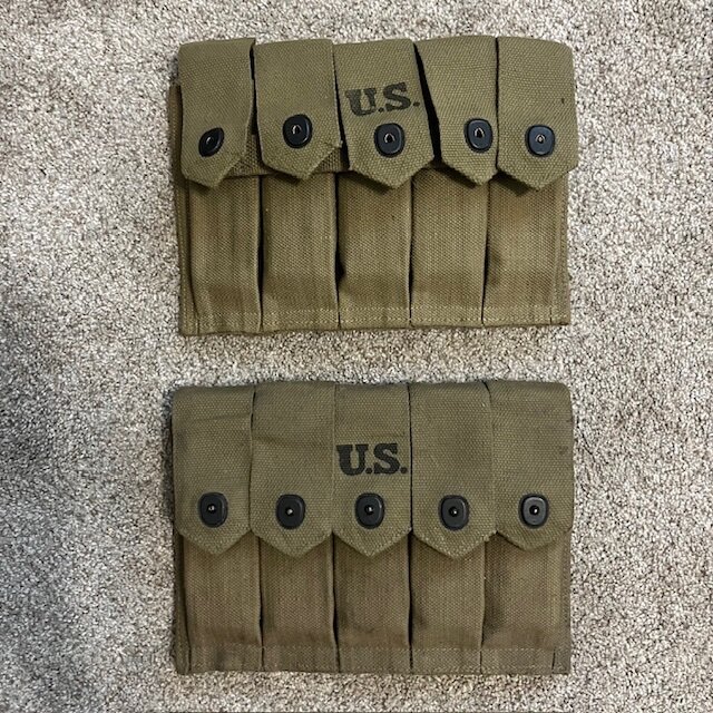

M40scoutsniper Posted April 30, 2025 Report Share Posted April 30, 2025 I am always on the lookout for TSMG goodies. Especially canvas WWII items. I recently have seen multiple RUSCO XX pouches on Ebay. However, they are not marked in the usual fashion I see them marked by Russell. They are marked much like their M1936 pistol belt with the “R.M. Co.”, instead of “RUSCO”. I was able to snag one of these pouches and wanted to share some pics and see if yall had run into this production variant. The last photo is an original photo of some Rangers taking a break in Italy. If you look closely you can see the XX mag pouch of the fella standing all the way to the right has a Russell pouch with the “US” on the center flap. Link to comment Share on other sites More sharing options...

TD. Posted April 30, 2025 Report Share Posted April 30, 2025 M40scoutsniper, Thank you for posting. There are so many World War II reproduction style magazine pouches in the marketplace that everything now looks fake to me! I have never seen a 5-cell Thompson pouch marked "RUSCO" on the inside of a flap with a date mark. Perhaps this style is referenced in the new Thompson Encyclopedia series in a volume I do not have. I look forward to comments from other forum members who collect canvas gear. Link to comment Share on other sites More sharing options...
Taliaferro Posted April 30, 2025 Report Share Posted April 30, 2025 I agree with Tom, I think that by 1942 Russell MFG was using the R. M. Co and date codes as were required by the US ordnance department. The RUSCO marked 1942 appears to be added later. Why someone would bother doing this is a mystery. Tracie Hill Link to comment Share on other sites More sharing options...
Bridgeport28A1 Posted April 30, 2025 Report Share Posted April 30, 2025 Shhhh, the next batch of newly marked pouches will be R.M. Co and date. Link to comment Share on other sites More sharing options...
RoscoeTurner Posted April 30, 2025 Report Share Posted April 30, 2025 1 hour ago, Bridgeport28A1 said: Shhhh, the next batch of newly marked pouches will be R.M. Co and date. May as well talk about it, the "dress up" crowd is always pushing manufacturers to make this stuff more and more authentic every day. Link to comment Share on other sites More sharing options...
halftrack Posted May 1, 2025 Report Share Posted May 1, 2025 (edited) Look at the lift dots. Usually the quality of those will help ideny repro vs authentic. Edited May 1, 2025 by halftrack Mis read Link to comment Share on other sites More sharing options...
Bridgeport28A1 Posted May 1, 2025 Report Share Posted May 1, 2025 I expect the US RUSCO 1942 marked 5 cell pouch was formerly an unmarked WW2 five cell pouch that came back with the Russian/Ukraine Thompson parts kits and cleaning rods. Marked US pouches have higher asking prices, marked pouches have turned into a buyer beware category unfortunately. Link to comment Share on other sites More sharing options...
rpbcps Posted May 1, 2025 Report Share Posted May 1, 2025 (edited) After reading this topic, I thought I would dig out my RUSCO marked 5 cell pouch, see attached. As you can see the pouch in my collection is marked RUSCO, not R.M. Co, BUT has no date on it. Intersted to know what those forum members who know more about pouches than me, (which is not a lot), think about this one? Forgot to say, love the photo showing the Ranger, sitting on case opposite the Sgt., with his XX cell pouch holding a couple of 30 rnd magazines. Edited May 1, 2025 by rpbcps added ref to Ranger picture Link to comment Share on other sites More sharing options...
halftrack Posted May 1, 2025 Report Share Posted May 1, 2025 After comparing the above photos to about 10 examples I have (both original and reproductions), I have no doubt that the pouch itself is original. The lift dots are original and I have yet to see any reproduction manufacturer come close to matching the back crimping of originals. That being said, the pouch may be original but the markings are suspect. Link to comment Share on other sites More sharing options...
