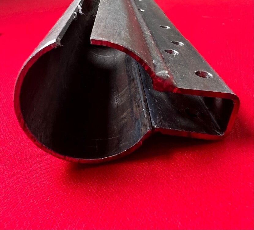

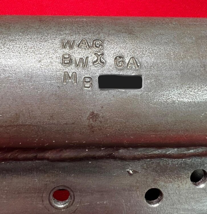

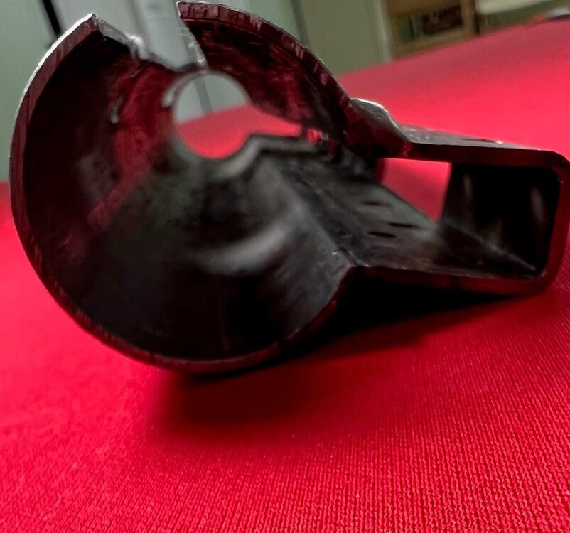

hkg3k Posted May 15, 2025 Report Share Posted May 15, 2025 (edited) With this discussion of Pearl K receivers and how they're made, just like factory...I wonder if anyone has ever had (or aware of) issues with the weld(s) between the registered Wilson tubes and lower section misaligned, cracking, breaking or otherwise require repair? For myself, I had an "MB series" (Stembridge movie gun) back in the day. It was a good, solid performer without any functional or structural deficiencies. Seeing where some of the K prices have climbed...I wish I had hung onto it. Edited May 15, 2025 by hkg3k Link to comment Share on other sites More sharing options...
Remo Williams 1 Posted May 15, 2025 Report Share Posted May 15, 2025 (edited) The 2 biggest issues with a few of the welded guns were too much head space in the trunions and the tube diameter being smaller than the factory Swedish guns. Both gun issues can be repaired by top gunsmiths. If you had a diameter issue with the tube, the bolt could be sanded down to fit. This is obvious when you see a shiny silver bolt. I’ve never heard of a weld failing, but many owners complained about the welds looking amateurish. Edited May 15, 2025 by Remo Williams 1 Link to comment Share on other sites More sharing options...

Jim in Texas Posted May 17, 2025 Report Share Posted May 17, 2025 Interesting photos of the apparent MB receiver with the full-length cut along the bottom of the tube. I would have expected them to have left the tube intact with only cuts where needed – such as Got Uzi appears to have done for his recent Pet project – semi-auto K. I do not know what alloy the various K tube builders used, but 4130 DOM was widely specified for receiver tubes back in the 80’s, even in the softback Minuteman Publications book on Sten Mk II construction. Link to comment Share on other sites More sharing options...
