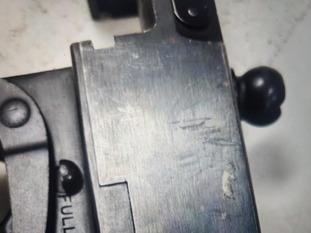

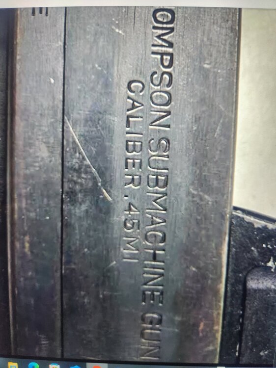

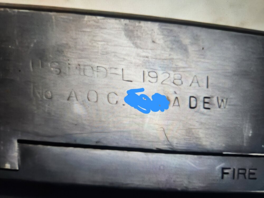

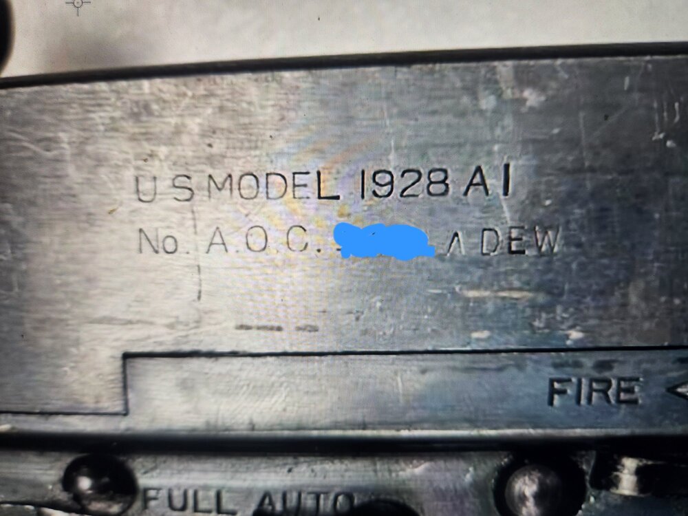

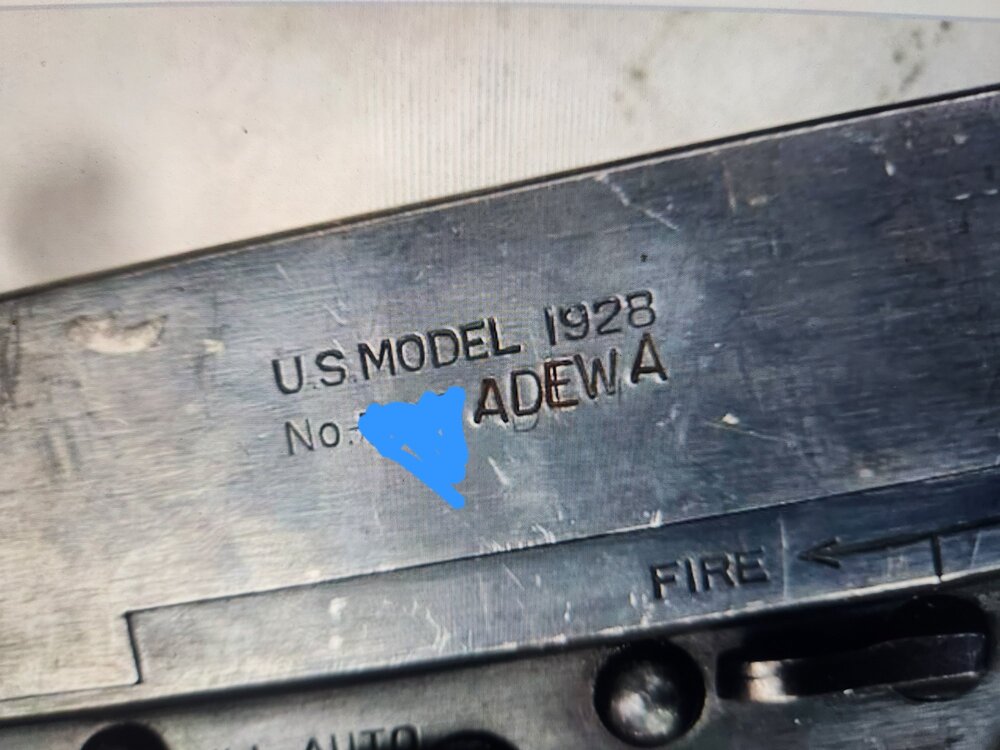

deerslayer Posted May 19, 2025 Report Share Posted May 19, 2025 A new member here asked me to look at his guns and help him post pictures. I believe he said they are form 3 (last transfer to him). They have 3 digit serial numbers with the pictured letters behind them. Anybody seen this before. They may have been movie industry guns. Input would be welcome. Link to comment Share on other sites More sharing options...
full auto 45 Posted May 20, 2025 Report Share Posted May 20, 2025 Tom Davis, these are the ones I had text you about. Dan, I had asked to see the other sides of the guns, but like Tom, I agree they are West Hurley guns. Link to comment Share on other sites More sharing options...
TD. Posted May 20, 2025 Report Share Posted May 20, 2025 There is little doubt these are West Hurley Model 1928 Thompson submachine guns. All West Hurley submachine guns have a letter "A" serial number suffix. The first 199 West Hurley 1928 submachine guns also had a serial number prefix: A.O.C. The first guns also had the "A1" nomenclature marking. The first-year production guns in 1975 were serial numbers 100A to 298A. I do find the "DEW" and "DEWA" markings interesting. I would like to see what is specified on the current approved ATF form. Auto-Ordnance Corporation, West Hurley, New York would manufacture guns with special serial numbers upon request. Hopefully, that is what is happening here. It would be very problematic if a past owner just added letters (or numbers) to a registered serial number. Those interested in learning more about the West Hurley Thompson guns should have my fourth book, Thompson: Colt's West Hurley's & More. 1 Link to comment Share on other sites More sharing options...

Sandman1957 Posted May 21, 2025 Report Share Posted May 21, 2025 They are west hurleys and were drilled and tapped to fire blanks. They were recently sold by a Company in New York. I think they purchased about 30 or so miscellaneous guns including 5 West Hurleys. 1 Link to comment Share on other sites More sharing options...

Rekraps Posted May 21, 2025 Report Share Posted May 21, 2025 3 minutes ago, johnsonlmg41 said: No they are not special. The suffix was added to the serial # when the guns were converted to full otto prior to May 86 by the registrant. This is pretty common. Not everyone wants serial number collectors collecting their info. Yes, these people do exist and one guy sells the lists, not sure to whom, but there is a market for everything. Thanks. Link to comment Share on other sites More sharing options...
TD. Posted May 21, 2025 Report Share Posted May 21, 2025 johnsonlmg41, Help me understand this. I agree there is nothing special about West Hurley Thompson guns (except mine ). However, I do not understand the conversion statement. It appears to me these guns were originally manufactured by Auto-Ordnance, West Hurley, New York in different years as Model 1928 [sub] machine guns and so registered with ATF prior to 1986. My only question is who added the suffix serial number letters. Hopefully, Auto-Ordnance, West Hurley, New York or some other plausible explanation. This is the only reason I want to see the current ATF forms. Or at least the top half of the current ATF form with the weapon description information. Link to comment Share on other sites More sharing options...

johnsonlmg41 Posted May 21, 2025 Report Share Posted May 21, 2025 (edited) edited for clarity Edited June 10, 2025 by johnsonlmg41 Link to comment Share on other sites More sharing options...

deerslayer Posted May 22, 2025 Author Report Share Posted May 22, 2025 Hiding serial numbers for above reasons, and they aren't my guns. Yes, i agree now they are west hurley guns. The hive mind helps you think of all things. The back half of the receiver has the typical "M1" marking. The front doesnt have the semi auto step so these were never converted from a 1927. Link to comment Share on other sites More sharing options...
First Sergeant Posted May 24, 2025 Report Share Posted May 24, 2025 First thing I thought of was: DEW and DEWA are pretty close to DEWAT, but johnsonlmg41's post took care of that. 1 Link to comment Share on other sites More sharing options...
