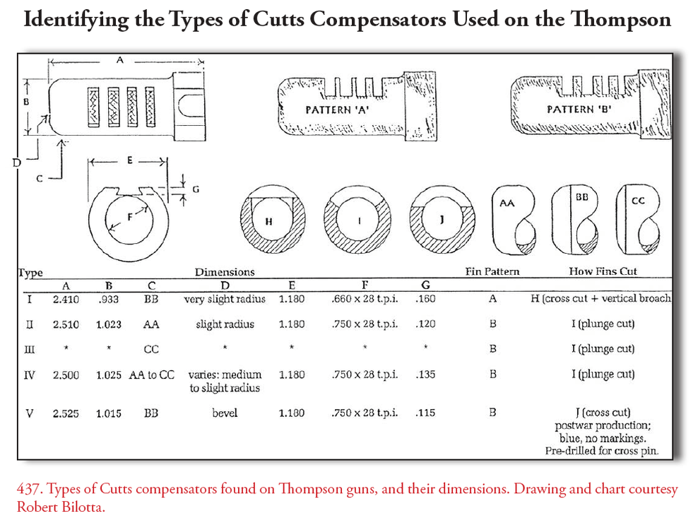

reconbob Posted June 5, 2025 Report Share Posted June 5, 2025 I needed a compensator for a dummy gun. Customer was OK with a repro. I found a "mil spec" comp on GB, but upon receipt, it is not "mil spec" and the quality is not good. The slots in the comp are milled straight across (faster and easier) instead on an arc as specified on the ordnance drawing. Result is the jagged edges in the slots. Photos tell the story. Bob Link to comment Share on other sites More sharing options...

Taliaferro Posted June 6, 2025 Report Share Posted June 6, 2025 FYI. There is a version of the comp that uses a straight cut on fins. Tracie Link to comment Share on other sites More sharing options...

reconbob Posted June 7, 2025 Author Report Share Posted June 7, 2025 The Kahr compensators are OK, but they are not threaded - they are press fit and pin. The I.D. is too big to screw onto a barrel. The comp in the photos is not 1921 Industries. Tracie - Is the comp with the straight cut slots the small diameter M1921 comp? I have one in my sample drawer and it looks like the slots are straight cut. Bob Link to comment Share on other sites More sharing options...

Sig Posted June 7, 2025 Report Share Posted June 7, 2025 Bob David Madlinger is what my contact list has for the owner of this website / Thompson parts maker, it's been a while, not sure if he is still in business. If you read the linked page, you should find he mentions availability of a Type 2 compensator. Good luck https://thompsonbarrels.com Link to comment Share on other sites More sharing options...
Taliaferro Posted June 9, 2025 Report Share Posted June 9, 2025 Hope this helps Tracie Link to comment Share on other sites More sharing options...
Countryboy77 Posted June 13, 2025 Report Share Posted June 13, 2025 On 6/9/2025 at 9:15 AM, Taliaferro said: Hope this helps Tracie Thats Cool! Very Informative. Link to comment Share on other sites More sharing options...
