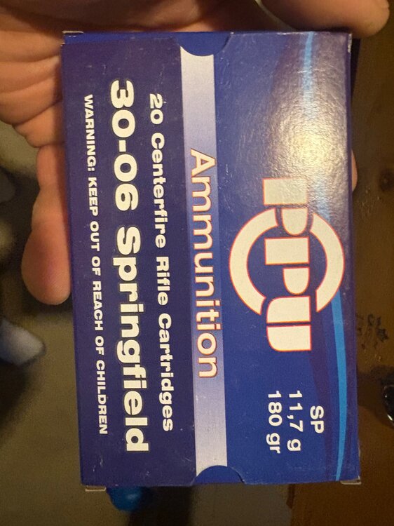

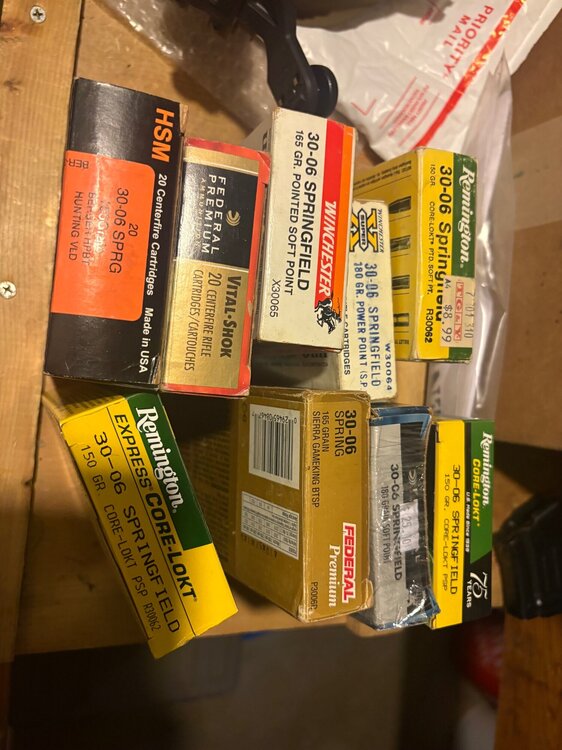

huggytree Posted July 8, 2025 Author Report Share Posted July 8, 2025 It’s a presample royal typewriter 1918a2 I own a few cases of m1 garand ammo I’d like to use up ppu another case of Normal ppu 180 grain and a few boxes of hunting ammo. Seeing it’s a cast gun should I stay away from using the modern hunting ammo? Link to comment Share on other sites More sharing options...
Labanaktis Posted November 24, 2025 Report Share Posted November 24, 2025 Greek HXP M2 Ball is what you want. I have a lot of your interested. Matt Link to comment Share on other sites More sharing options...
