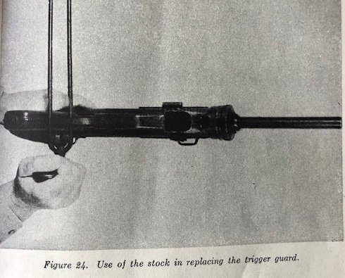

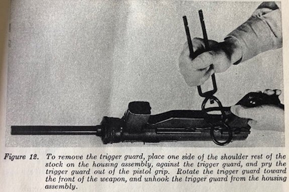

Frank I. Posted August 4, 2025 Report Share Posted August 4, 2025 On 7/31/2025 at 11:45 AM, BillinBama said: I considered cutting a slot, but as you said, it weakens the plate. What to do...... IMHO don't cut or modify anything Removing the ejector housing is no big deal, it's part of routine maintenance. I remove mine regularly when cleaning (have to because of the large backplate). If you don't have a GI manual for the GG you should get one...you just remove the trigger guard and the housing drops right off. The manual shows how to use end of the buttstock as a tool to remove and install the trigger guard. EZ you will probably find a lot of grime/carbon and dirt inside the housing. When I was younger, I could easily remove the trigger guard with my hand, but I use the buttstock now. Link to comment Share on other sites More sharing options...
Rekraps Posted August 4, 2025 Report Share Posted August 4, 2025 15 minutes ago, Frank I. said: IMHO don't cut or modify anything Removing the ejector housing is no big deal, it's part of routine maintenance. I remove mine regularly when cleaning (have to because of the large backplate). If you don't have a GI manual for the GG you should get one...you just remove the trigger guard and the housing drops right off. The manual shows how to use end of the buttstock as a tool to remove and install the trigger guard. EZ you will probably find a lot of grime/carbon and dirt inside the housing. When I was younger, I could easily remove the trigger guard with my hand, but I use the buttstock now. I kidding. The trigger guard on mine is so stiff it kills me to remove it. Link to comment Share on other sites More sharing options...
BillinBama Posted August 5, 2025 Report Share Posted August 5, 2025 12 hours ago, Rekraps said: I kidding. The trigger guard on mine is so stiff it kills me to remove it. Yeah, my arthritic hands found it too hard to remove, I'd seen somewhere that the wire stock could be used, amazing how military guns were designed so parts of the gun could be used as tools. Thanks for all the help, at my age I need it. Link to comment Share on other sites More sharing options...
Frank I. Posted August 5, 2025 Report Share Posted August 5, 2025 The M3A1 stock was designed as a tool to remove the trigger guard, and the barrel. A magazine loader, and one of the struts is threaded for a cleaning brush. In basic training, we were shown how an M16 could be disassembled with a live round. (for routine field maintenance) Link to comment Share on other sites More sharing options...
