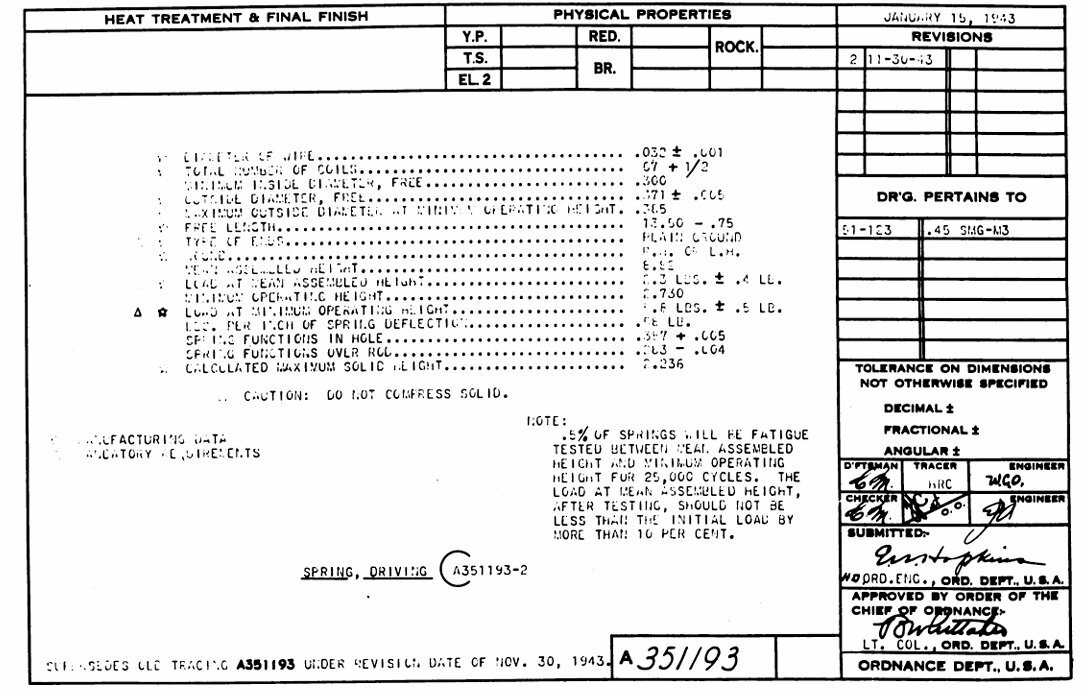

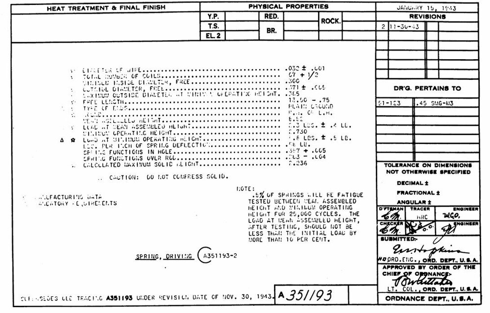

Frank I. Posted August 11, 2025 Report Share Posted August 11, 2025 This is the drawing for the M3 springs dated 1943, there may have been revisions in later years. Some of the data is hard to read. it LOOKs like 67-coils, length 13.5" - .75" Link to comment Share on other sites More sharing options...
APEXgunparts Posted August 11, 2025 Report Share Posted August 11, 2025 Interesting to see that the life estimate is 25,000 cycles. I learned a long time ago from a mechanical engineer that all spring life is expressed in cycles. I have also learned that modern springs can be made from material that will virtually never wear out ( but it is costly to do that ) Modern springs can be made to withstand high heat exposure as well ( again, not inexpensive ) Richard Link to comment Share on other sites More sharing options...

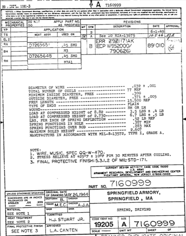

damifino Posted August 11, 2025 Report Share Posted August 11, 2025 Compliments to Mongo for a cleaner copy. With material specs. Link to comment Share on other sites More sharing options...
APEXgunparts Posted August 11, 2025 Report Share Posted August 11, 2025 Wow, dated 1966 as the last rev. Glad to see the sharing of actual tech data. I saved this for when I run out and see what my spring manufacturer can produce. They already make springs for the DoD , mainly firearms related. Richard Link to comment Share on other sites More sharing options...

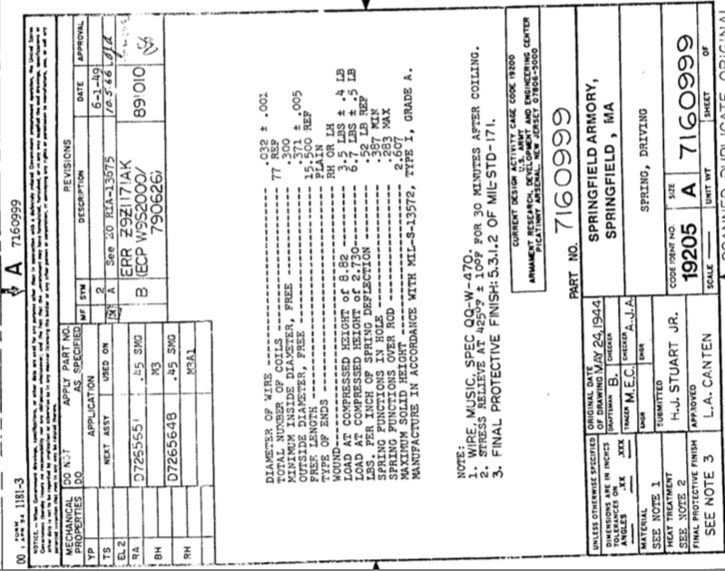

Frank I. Posted August 12, 2025 Report Share Posted August 12, 2025 Nice addition ...I turned it so no one twists their necks Note how some specs changed...PERHAPS to alleviate the problem of the smaller M3A1 backplate beating out the back of the receivers? Link to comment Share on other sites More sharing options...
