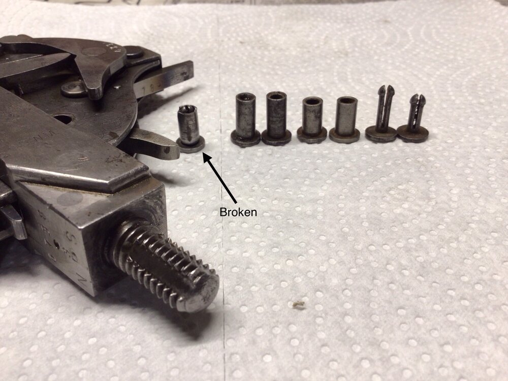

waterdawg2004 Posted June 14 Report Share Posted June 14 I broke a lock pin on my Maxim 08/15. I have spares but they do not fit. The long ones fit the hole but are too long. The short ones do not fit in the hole because too big around even with slight rubber hammer persuasion. Any recommendations would be appreciated. See pic. Thanks for any info. Link to comment Share on other sites More sharing options...
LBF15E Posted Saturday at 06:12 AM Report Share Posted Saturday at 06:12 AM It should be easy to shorten one of your long ones that fit in the hole. They are hardened so you likely won't be able to use a file but you could use a Dremel with a cut-off wheel or grinding bit. Measure your old one with a dial caliper 1st to make sure you don't shorten it too much. Good Luck! 1 Link to comment Share on other sites More sharing options...
waterdawg2004 Posted Saturday at 11:44 AM Author Report Share Posted Saturday at 11:44 AM Thanks for the info, I will try it since I have two. Link to comment Share on other sites More sharing options...
