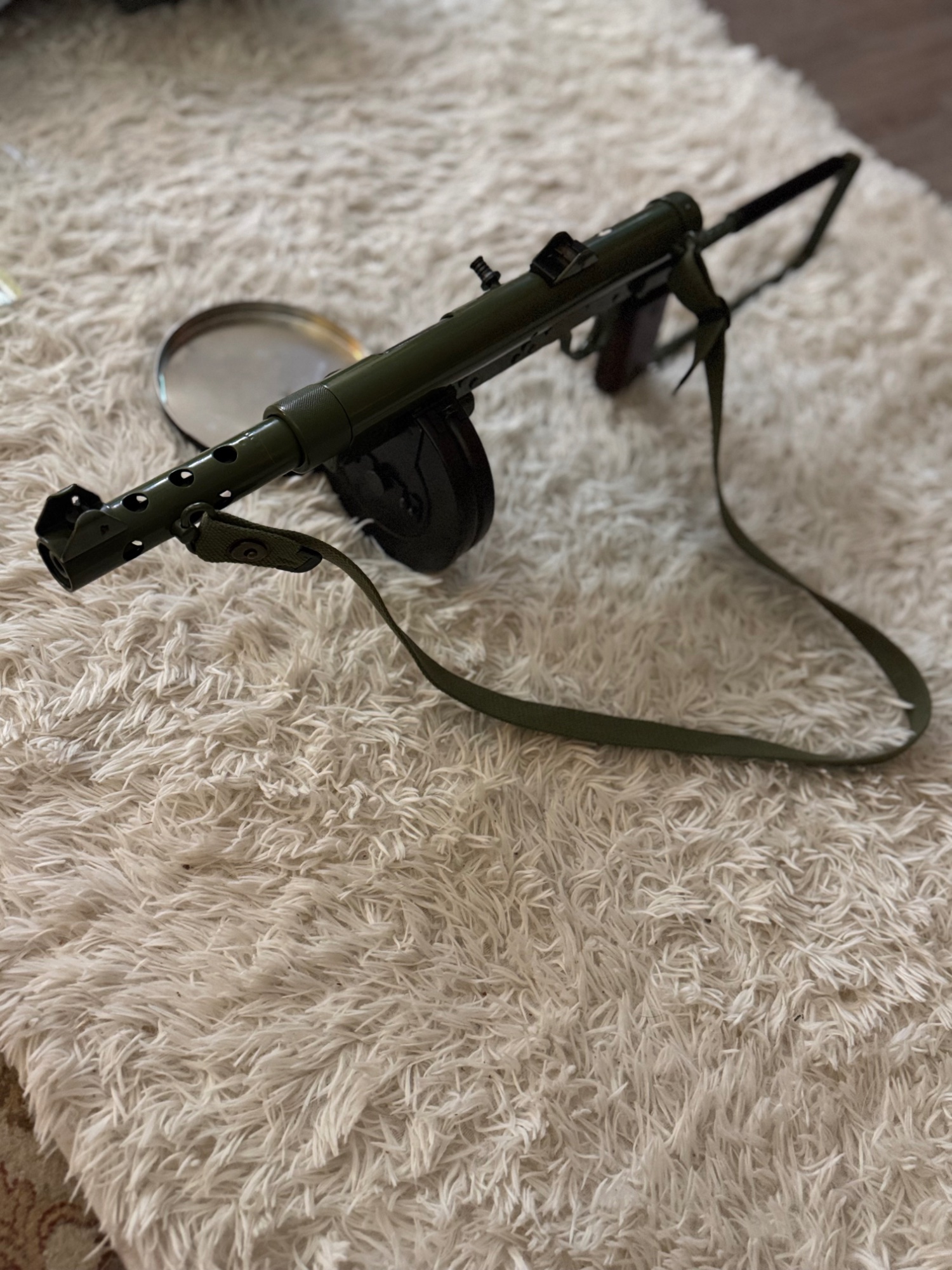

Remo Williams 1 Posted June 29, 2025 Report Share Posted June 29, 2025 (edited) First time that I shot the drum. My last K ( tube gun) had too much space in the mag well and wouldn’t attach. All 5 that I have ran great. Edited June 29, 2025 by Remo Williams 1 Link to comment Share on other sites More sharing options...
Lewisfan Posted June 30, 2025 Report Share Posted June 30, 2025 As previously noted - original Swedish K guns do not take drums. You have to take off a VERY little bit on the receiver where the top of the drum kisses up against the bottom of the gun. Link to comment Share on other sites More sharing options...
Remo Williams 1 Posted June 30, 2025 Author Report Share Posted June 30, 2025 My old one had too much space. I figure either the previous owner removed too much while trying to fit a drum, or the person who completed the original build was off a bit. Some additional good news, I bought several Pike Arms barrels so I could save some wear on my original and they worked great. Link to comment Share on other sites More sharing options...
