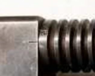

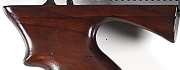

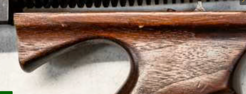

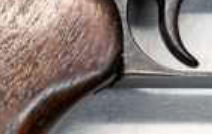

Sig Posted July 1, 2025 Report Share Posted July 1, 2025 19 hours ago, Colt Chopper said: This kit has numerous issues. The original barrel would have been marked with 151, but the barrel pictured is far from original. Barrel has no witness mark. No picture of an Anchor stamp on the rear stock has me suspicious. Both Front Rear grip do not appear correct to me but that is just me. These items are always better purchased after a direct visual inspection. No Witness mark and some mark is clocked above where one should be but not a witness mark Rear grip has an unusual appearance, should be a crisper line coming back from the trigger guard An example of a rear grip with a crisp line coming back from the trigger guard Front grip has an unusual shape F Another front grip to compare Link to comment Share on other sites More sharing options...
