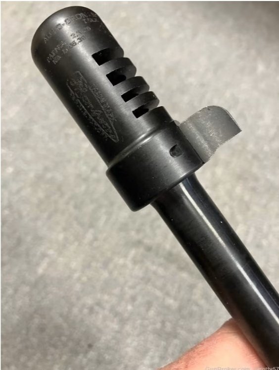

SP Sarge Posted July 1, 2025 Report Share Posted July 1, 2025 Maybe my eyes are going, but does it look to anyone else like this compensator is laser engraved rather than roll stamped? Makes me wonder if the barrel is a new made forgery too. Thompson SMG barrel 1928 1921 M1a1 - Pistol Parts Kits at GunBroker.com : 1114005657 Link to comment Share on other sites More sharing options...
TD. Posted July 1, 2025 Report Share Posted July 1, 2025 The compensator does look laser engraved. Note that the barrel has what appears to be 27 fins. If so, this is most likely a Numrich Arms or Auto-Ordnance West Hurley barrel. Do the counting yourself and let me know if my eyes deceive me. Buyers, be careful out there! Link to comment Share on other sites More sharing options...
mnshooter Posted July 1, 2025 Report Share Posted July 1, 2025 Definitely laser. There is no crosspin, or even a hole; just a blind plunge cut where the hole would be drilled. The contour and color of the front sight is also somewhat "unique". New old stock. Hmmm. Ok. Could possibly have been in storage for... months? Link to comment Share on other sites More sharing options...

reconbob Posted July 2, 2025 Report Share Posted July 2, 2025 Yes, this is good ol' Mckay Enterprises. There is a previous thread about his counterfeit "original Savage" trigger frames. McKay Enterprises/Scotty57 Trigger frames - Thompson Submachine Gun Message Board - MachineGunBoards.com Forums He even goes to the trouble to put one of these frames 1/2 way into some type of wrapper in an attempt to backup the original NOS hogwash. But boy, this barrel is even worse and instantly recognizable as new manufacture - the laser engraving, the fins are wrong, the sight is wrong, the stamp he chose to fake the Savage S is the wrong size (too big) and font. I don't know why he does this. He has a huge modern shop and I can't see that faking Thompson parts would really be worth it, and his shameless lying that these obvious fakes are original parts is really irritating. Bob 1 Link to comment Share on other sites More sharing options...
