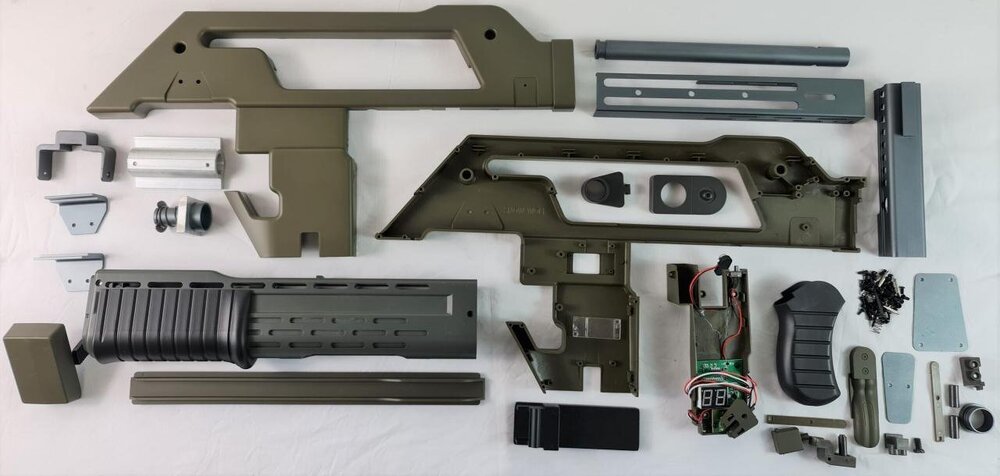

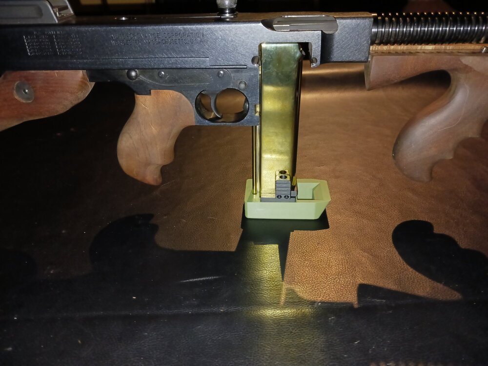

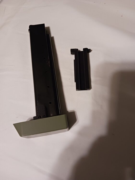

Gold1927a1 Posted September 9, 2025 Author Report Share Posted September 9, 2025 Slowly but surely I'm going to start accumulating the necessary parts for this build. Today the magazine baseplate came in the mail, alone with a guide rail to assist in feeding the mag into the clamshell. Ordinarily these parts are for the airsoft guns or replica builds the movie fans make... but since the base airsoft gun used in the evike/snow wolf pulse rifle is a Toyko Mauri it's nearly identical dimensionally to the real Tommy gun. I was originally going to just reuse most of the plastic parts of the fake launcher, etc but there's tons of real steel/aluminum prop parts on ebay and I think that when all is said and done, it's going to be worth the extra expense for the metal parts. I'm sure there may be some custom fitting but it looks like the aftermarket steel stocks just need a few holes drilled for the collapsed/extended position lockups. As far as the main clamshell, it's strong enough as is but I'll probably reinforce it with jb weld or something. Link to comment Share on other sites More sharing options...
SparksNArcs Posted September 14, 2025 Report Share Posted September 14, 2025 (edited) I'm working on the same thing, but I'm curious where you got the magazine base unit from? It looks really good! I'm using the SD Studios parts to start mine: stock, grenade launcher end cap and eventually the barrel shroud stuff. The expensive part is going to be the SPAS cage, as there's only one guy making them apparently and they cost $300 plus shipping from the UK; he also makes the pump handles to go with the cage. Edited September 14, 2025 by SparksNArcs Link to comment Share on other sites More sharing options...

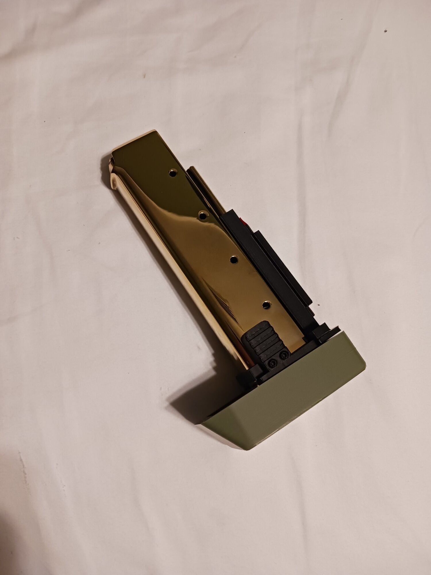

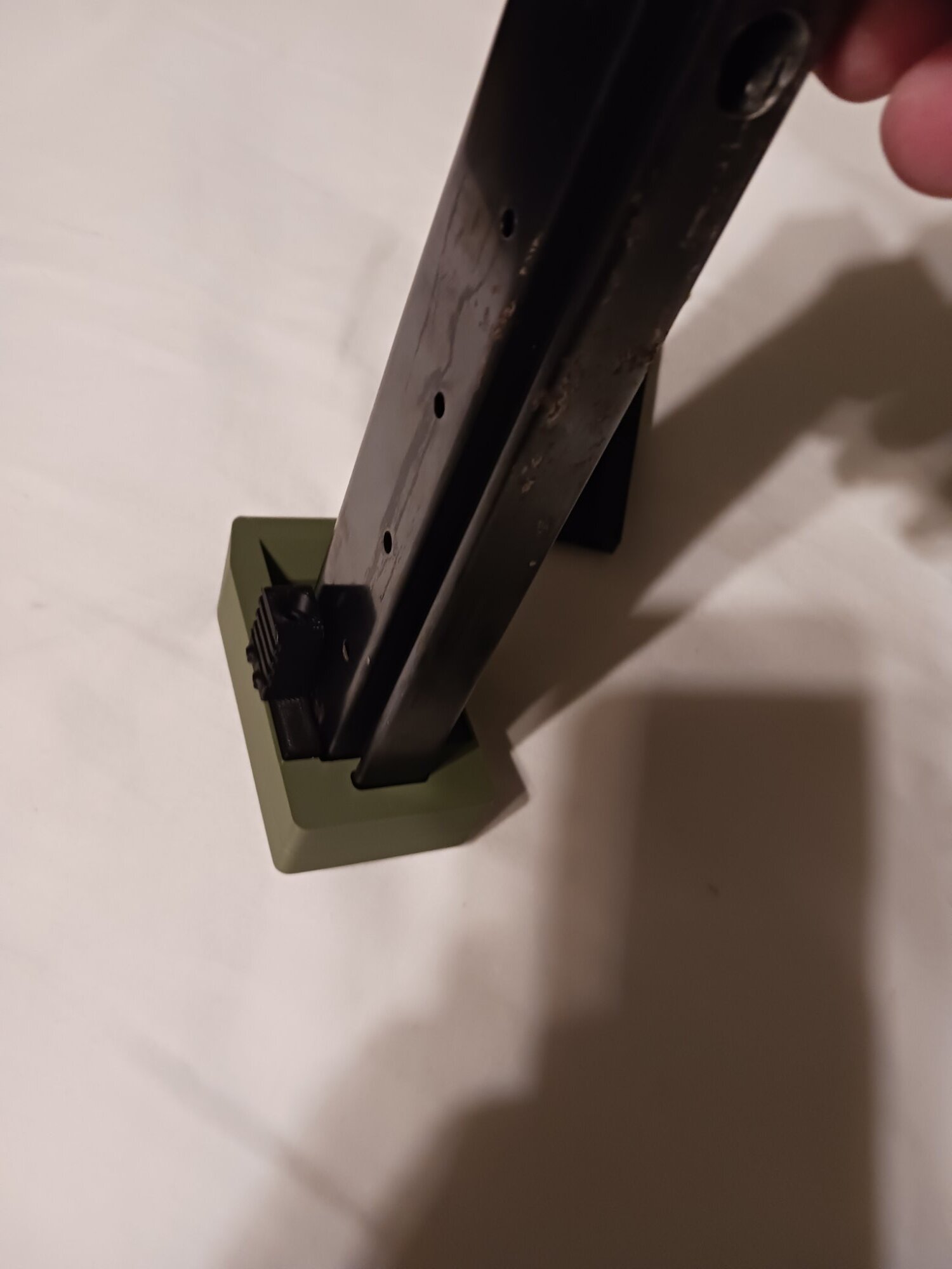

Gold1927a1 Posted September 14, 2025 Author Report Share Posted September 14, 2025 Got it from ebay user vennmodels. Ask him to 3d print the base solid for a real mag. Funny thing is the real mag fits better than the airsoft mag lol. Funny coincidence, I'm going to use all the same parts. If you let the parts sit in your cart for a few days you get auto offers for the parts a bit cheaper. We can work off eachother's ideas on how to make this thing work. I do have a little flux core welder than works great for thin metal, but screw build will probably work also. Any thoughts on reinforcing the clamshell? I already had the airsoft gun for years just sitting around and it feels pretty sturdy. Link to comment Share on other sites More sharing options...

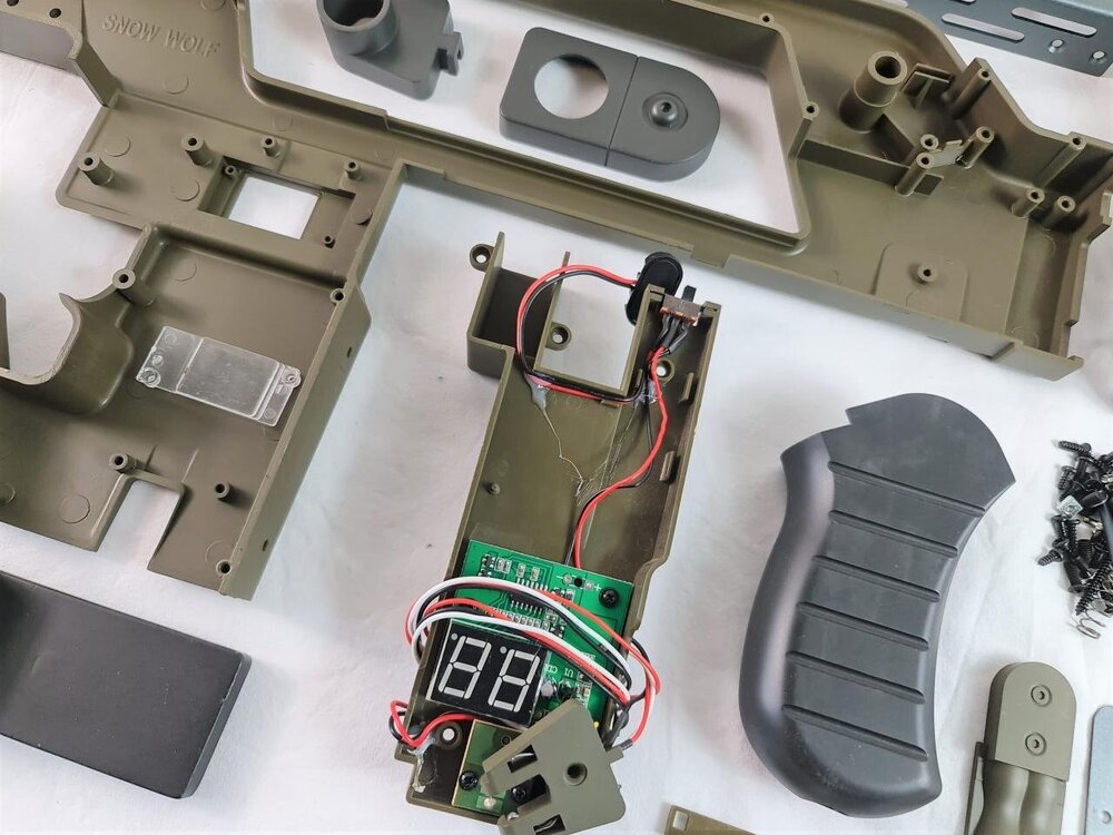

Gold1927a1 Posted September 14, 2025 Author Report Share Posted September 14, 2025 Also you can get extra factory base plates from evike. There is a color discrepancy with the ebay bases but they work well. I'm thinking I can insert a mag and put some jb weld in the bottom of a factory base plate and just stick it on and let it dry. Going to have to take a look at the ammo counter and see if I can wire it to work with real ammo. Link to comment Share on other sites More sharing options...
SparksNArcs Posted September 14, 2025 Report Share Posted September 14, 2025 The original counter circuit uses a photo diode setup that interacts with the electric motor and gear train from the airsoft M1A1 from what I understand, which doesn't do any good in a real firearm. It might be possible to connect a reed switch instead, I'd have to play with it but I've got other projects to work on right now. Another guy I saw online bought a custom 20rd counter and used a magnetic reed switch and a magnet attached to the charging handle to run the counter. Link to comment Share on other sites More sharing options...
