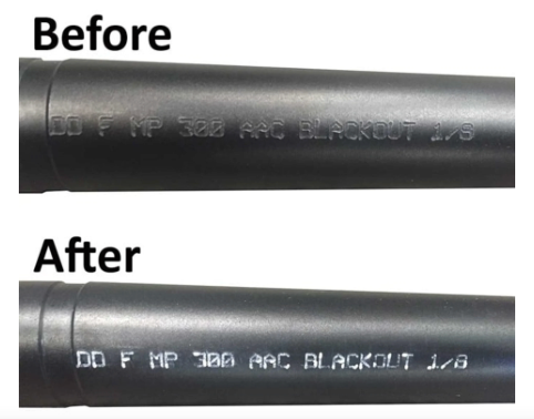

Sig Posted July 10, 2025 Report Share Posted July 10, 2025 As Tracie pointed out, for display, here is an example Before and After, right from the Brownells.com website for their Laquer sticks. https://www.brownells.com/tools-cleaning/general-gunsmith-tools/files-engraving-tools/color-fill-lacquer-stick/ 1 Link to comment Share on other sites More sharing options...

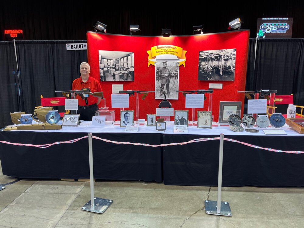

Taliaferro Posted July 10, 2025 Report Share Posted July 10, 2025 Look at this display. Zoom in on guns. You can read the markings. Imagine if you were walking by and were able to read them and stay off the table. Tracie Link to comment Share on other sites More sharing options...

rpbcps Posted July 11, 2025 Report Share Posted July 11, 2025 15 hours ago, Taliaferro said: Look at this display. Zoom in on guns. You can read the markings. Imagine if you were walking by and were able to read them and stay off the table. Tracie Top tip from Tracie, Just ordered one for my upcoming display later this month in the UK. thanks?? Link to comment Share on other sites More sharing options...
