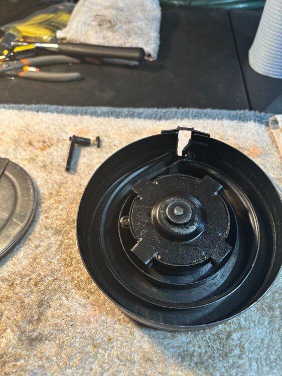

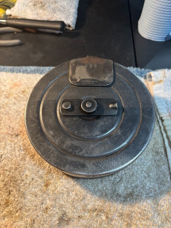

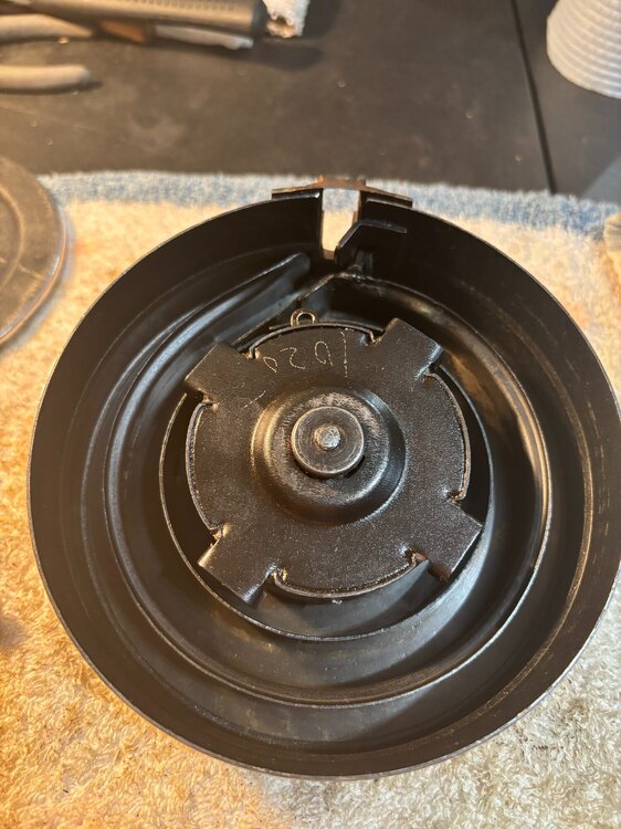

1569709148_PPSHDrum1.thumb.JPG.2e8ac9d6e690b45eadd19f95033d21df.JPG1451324377_PPSHDrum2.thumb.JPG.0d6fbe934856b062bfa578038bf44f40.JPG528784285_PPSHDrum3.thumb.JPG.2137ae24ed6c0d47cedd2a44943a3310.JPG344957045_PPSHDrum4.thumb.JPG.0de1802cfce47c0411e3a49eab062bcc.JPG1160337768_PPSHDrum5.thumb.JPG.e875a212e65255a46b56e15d74b92e10.JPG1644747252_PPSHDrum6.thumb.JPG.f3063720602ee067b8deb4266cac827b.JPG2029459690_PPSHDrum7.thumb.JPG.7e8e9dd6517471f158478ba31d04c7c2.JPGHaving thought about this a bit, I decided to fully disassemble, clean and reassemble my PPSH drums. For those of you interested, here is the process:

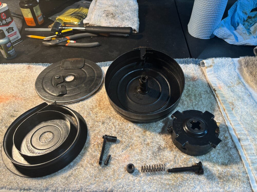

PPSH 41 Drum Components:
  • Front Face Plate w/hinged locking tab
  • Main Body
  • Follower & follower set screw
  • Main Spring Assembly (sealed at factory)
  • Clutch Spline, spring and nut
  • Ammunition Carousel
Disassembly:
  1. After removing the front face plate, rotate the MSA one click counter-clockwise. Remove set screw and follower, set aside.
  2. Holding the drum in your left hand, and applying slight counter clockwise pressure on the MSA, depress the clutch pin from the back of the main body and allow it to rotate clockwise, one click at a time. After 7 or 8 clicks, all spring tension in the MSA will be gone.
  3. Remove the Clutch nut and spring from the back of the MSA, then remove the clutch spline. Set aside.
  4. Rotate the MSA clockwise about 1/4 turn (this will disengage the inner spring from the main body post spring catch), and gently pull upward. The MSA will come off. Set aside.
  5. From the bottom of the Main body, lift the ammunition carousel at a 35 degree angle and remove it. Set aside.
  6. The unit is now fully disassembled. The MSA is sealed at the factory, so it cannot be disassembled.
Clean all parts of excess packing grease (but leave the packing grease in the MSA).

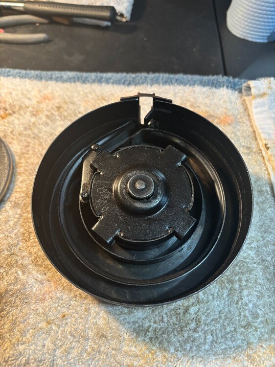

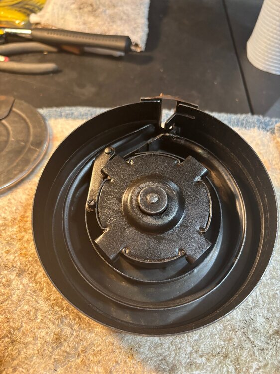

Reassembly:
  1. Replace the ammunition carousel, making sure the stop tab is to the left (12 oclock position) of the stop tab barrier.
  2. Reinstall the MSA, with the small follower hole in the 12 oclock position. Make sure the MSA is fully seated past the tabs on the main body post.
  3. Insert the clutch spline until seated in the MSA.
  4. Holding the clutch spline in place, insert the clutch spring and nut from the back of the Main body. Hand tighten.
  5. Holding the drum in your left hand, wind the MSA 7 or 8 clicks until the small follower hole is back in the 12 oclock position.
  6. Rotate the MSA one more click counter clockwise and reinstall the follower and set screw.

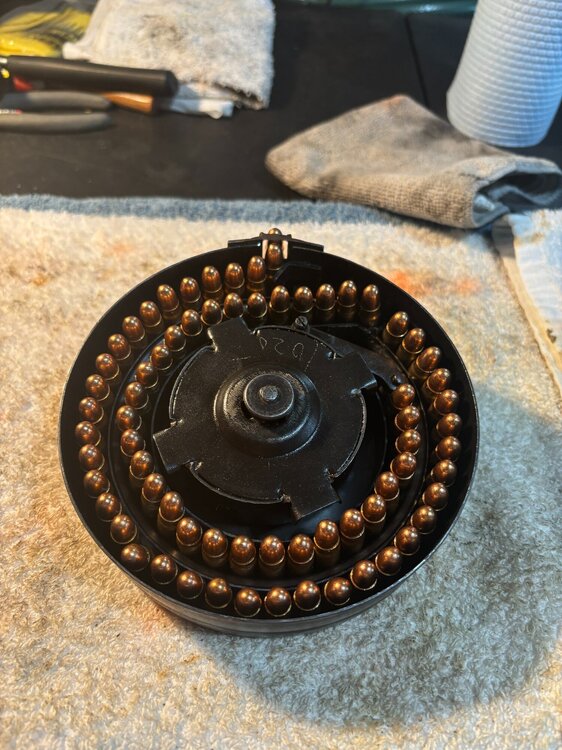

  7. The Drum is now ready to load, rotate the MSA counter clockwise until it stops, load ammo. Tension can be set by striking the clutch nut on a hard surface, or by gently turning the MSA just a tad, and depressing the clutch nut by hand. Either way works.
