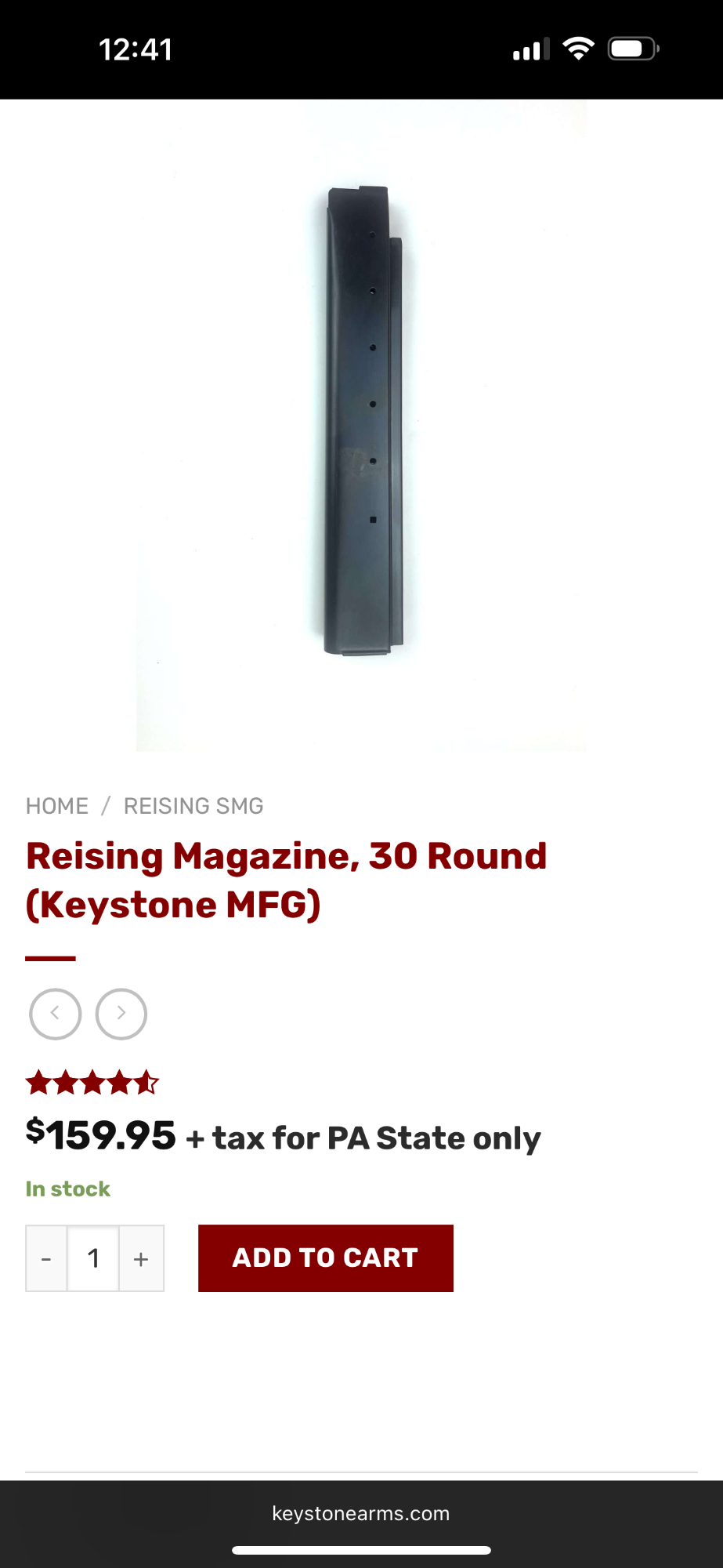

SteelSteed Posted October 19, 2025 Report Share Posted October 19, 2025 Posting on some random Reising threads to let everyone know Ieystone Arms has a new production run of 30-round mags is available. https://keystonearms.com/product/keystone-reising-magazine-30-round/ Link to comment Share on other sites More sharing options...
