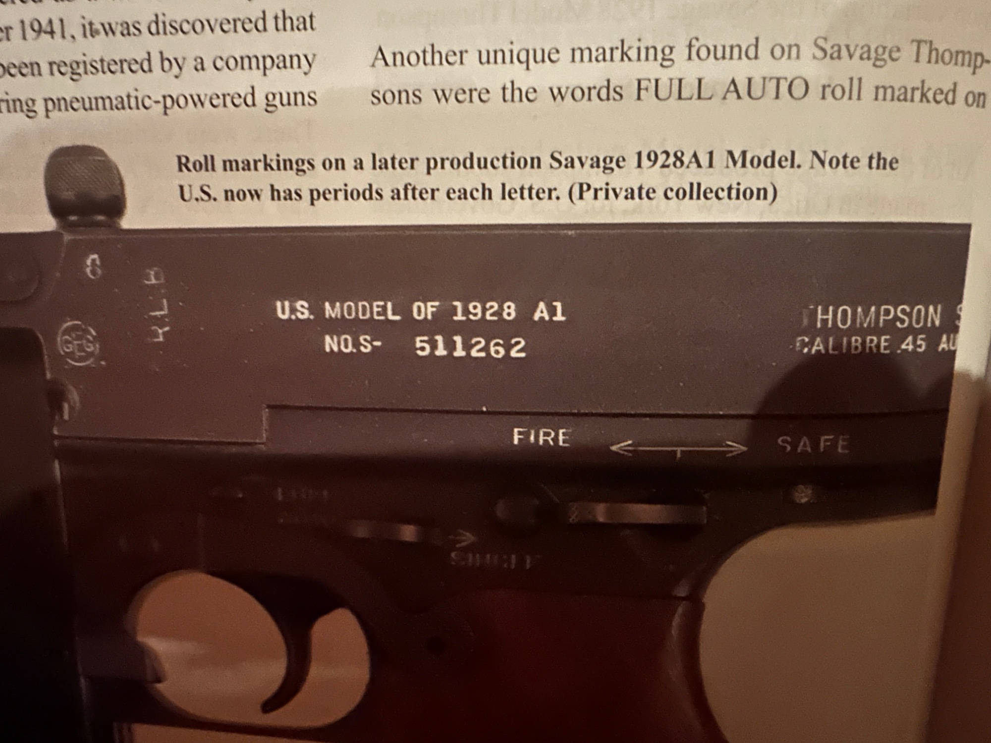

Deavis Posted September 12, 2025 Author Report Share Posted September 12, 2025 American Thunder 3rd ed. Page 134 has a very close relative! Link to comment Share on other sites More sharing options...

damifino Posted September 13, 2025 Report Share Posted September 13, 2025 The six looks like an overstamp on a five. Maybe Friday on the Savage assembly line, and Joe grabbed the wrong stamp, whoopsie, then got the six and a light strike on the zero. Ya never know. Link to comment Share on other sites More sharing options...
Deavis Posted September 13, 2025 Author Report Share Posted September 13, 2025 (edited) FOIA request submitted! Since I was filling one out I did one for my M1 as well. The one I posted from American Thunder is only 102 serial numbers off of mine. It has a knurled actuator. If the story on gun broker is true it was a REWAT, perhaps they did the sight and the barrel at the same time? Edited September 13, 2025 by Deavis Link to comment Share on other sites More sharing options...
TSMG28 Posted September 13, 2025 Report Share Posted September 13, 2025 Deavis, Yes, it is likely that the rear sight and barrel were changed out when it was re-activated. That is also likely the time it was blued. Most DEWAT barrels were welded closed during this timeframe, so were scrap and needed to be replaced when reactivated. As has been mentioned, originally it probably had an unfinned barrel and L rear sight. Congrats on your new toy. Link to comment Share on other sites More sharing options...
Deavis Posted September 14, 2025 Author Report Share Posted September 14, 2025 (edited) Looking closer at #S-511262from the book, I realized it is also the cover girl! Note finned barrel and Lyman rear. I wonder the history on that one? Be interesting to know if a FOIA was done on it? S-511162 is listed in the book as (Private Collection). If anyone knows that possessor I’d love to hear it’s story as it could shed some light on mine. Edited September 14, 2025 by Deavis Link to comment Share on other sites More sharing options...
