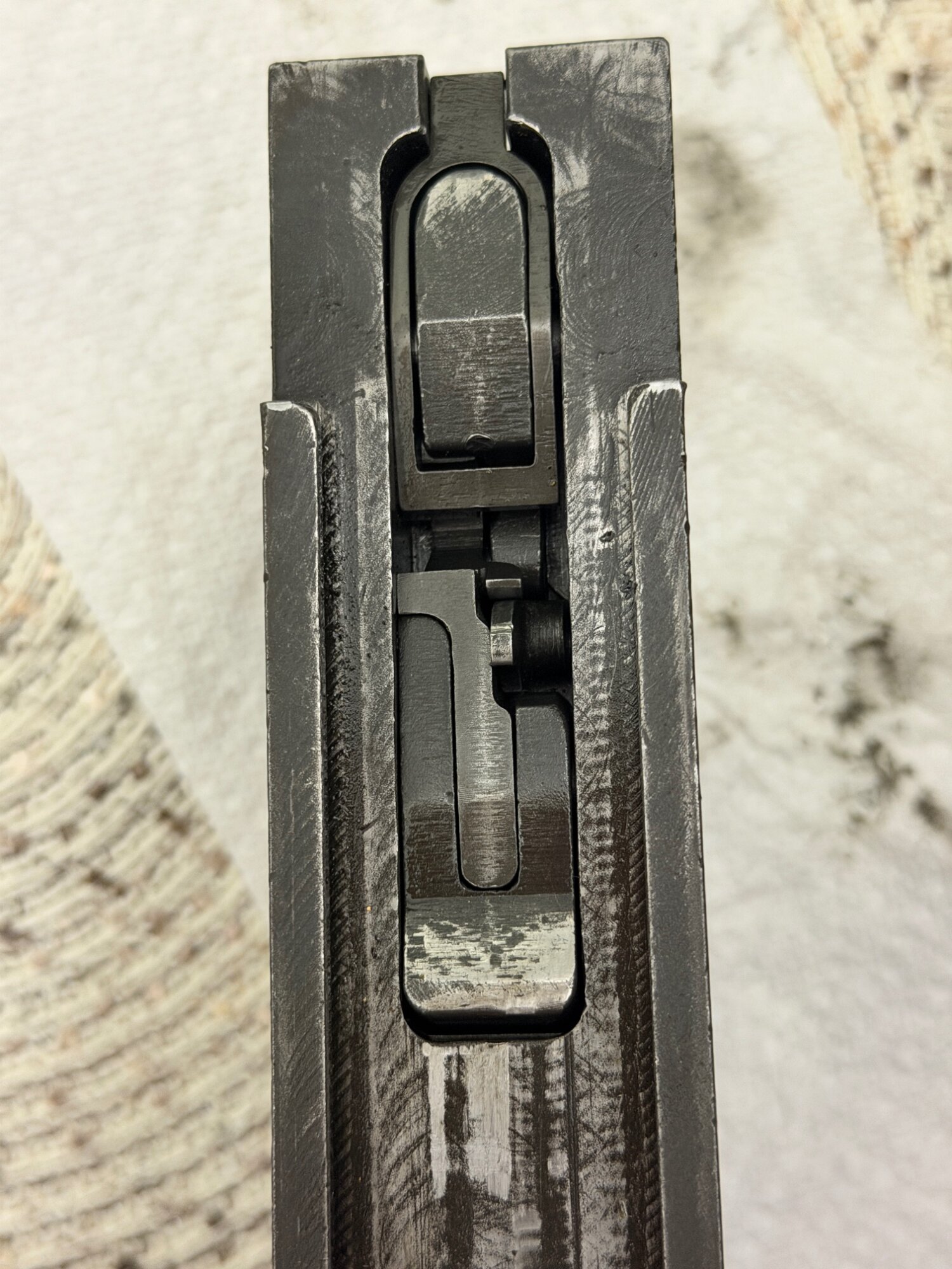

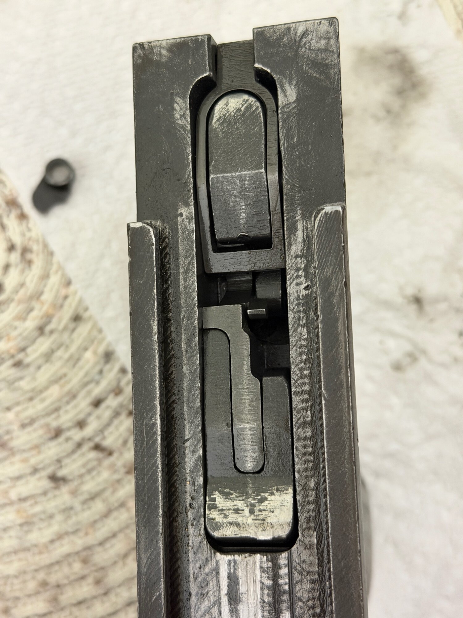

walleyealx Posted October 1, 2025 Report Share Posted October 1, 2025 Wanted to give my M1A1 a good cleaning. Never taken apart the lower. I was watching a video of a gentleman stripping and reassembling the lower, and he doesn't zoom in much. I thought I had it together correctly, but I'm having an issue. It cycles and and seemingly functions fine on auto, but when I go to semi the trigger won't reset and I have to pry it forwards. I took a couple of pictures of the lower both with and without the "rocker" in the orientation where I think it should be in. It could be something else, but that's my suspicion. Any other observations or things to try? Link to comment Share on other sites More sharing options...
Bridgeport28A1 Posted October 1, 2025 Report Share Posted October 1, 2025 (edited) http://www.nfatoys.com/tsmg/web/m1assy.htm Your rocker appears to be in the correct orientation. Did you take the springs out of their respective parts when you were giving it a good cleaning? Edited October 1, 2025 by Bridgeport28A1 Link to comment Share on other sites More sharing options...
deerslayer Posted October 1, 2025 Report Share Posted October 1, 2025 Maybe take it back apart. See if you have any little "burs" of metal on the edges that bear against each other. Make sure all springs not kinked. Also look to see if the grip screw protrudes out into the area. Link to comment Share on other sites More sharing options...
deerslayer Posted October 1, 2025 Report Share Posted October 1, 2025 Push the rocker forward by hand while its apart and your fully squeezing the trigger. You can see if the trigger resets properly when you release. 1 Link to comment Share on other sites More sharing options...

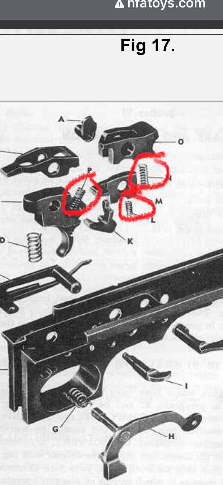

walleyealx Posted October 2, 2025 Author Report Share Posted October 2, 2025 12 hours ago, Bridgeport28A1 said: http://www.nfatoys.com/tsmg/web/m1assy.htm Your rocker appears to be in the correct orientation. Did you take the springs out of their respective parts when you were giving it a good cleaning? I attached a picture of the springs that I replaced. Maybe one of them is incorrect or too strong? 11 hours ago, deerslayer said: Push the rocker forward by hand while its apart and your fully squeezing the trigger. You can see if the trigger resets properly when you release. The rocker is there so tight that I can’t push it to do anything. It’s pushing against metal, whether or not the trigger is pulled. Link to comment Share on other sites More sharing options...

walleyealx Posted October 2, 2025 Author Report Share Posted October 2, 2025 Alright... Another update. After I did the above videos I put the old springs back in and everything worked fine. I ended up deducing that the "disconnector spring" that Apex sent me was way too strong and didn't let the rocker move at all. Side note: Just to confirm... You can't turn the selector to Semi unless the bolt is locked back (I.e. in the firing position), correct? 1 Link to comment Share on other sites More sharing options...

villafuego Posted October 2, 2025 Report Share Posted October 2, 2025 Eventually you may want to think about replacing that sear ....... the engagement surface of yours looks a little rough 1 Link to comment Share on other sites More sharing options...
