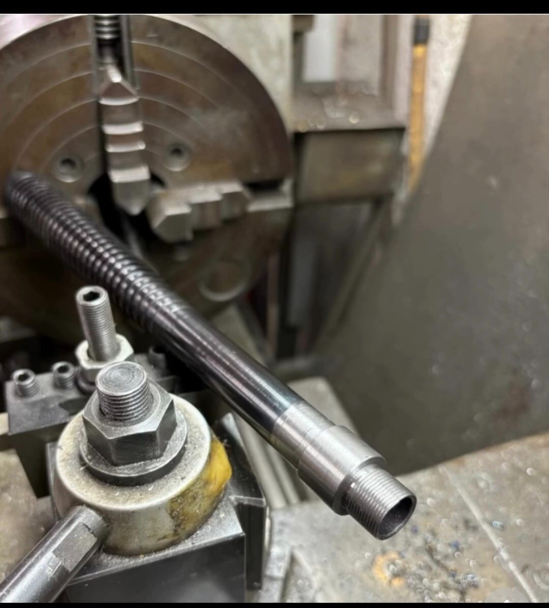

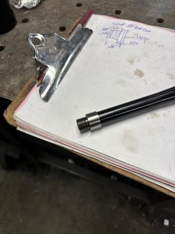

H2munitions Posted October 7, 2025 Report Share Posted October 7, 2025 Hello fellow thompson enthusiasts. Recently we did some thompson barrel threading for some customer builds. I thought this might be something of interest to others looking to suppress their Thompsons. Here is the process. We machine a bushing for a light press fit on the barrel behind the newly cut .578-28 threads. The bushing has a small hole thru one side which allows the bushing to be tig welded in place. The m1 style front sight can then be installed in place. For a converted barrel the price would be $200 shipped PLUS the cost of the barrel. Which varies depending on style of barrel chosen. So all in $320-$370 if you are purchasing a new barrel for the work. As an 07/02 we are also able to remove/install thompson barrels on semi autos, machine guns, and SBRs. If you're sending a newly registered SBR we can also handle the NFA laser engraving as well for $30 as an add on service. Would these barrels/services be of any interest to the thompson crowd? We have done a few for our in house builds and would like some feedback from the Thompson community here. Thanks all! Caleb 1 Link to comment Share on other sites More sharing options...

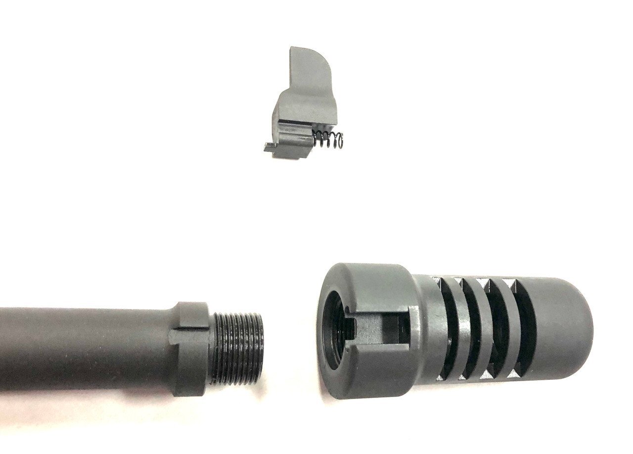

shadycon Posted January 22 Report Share Posted January 22 Why not make one that you can screw on a compensater when suppressor is removed? Link to comment Share on other sites More sharing options...

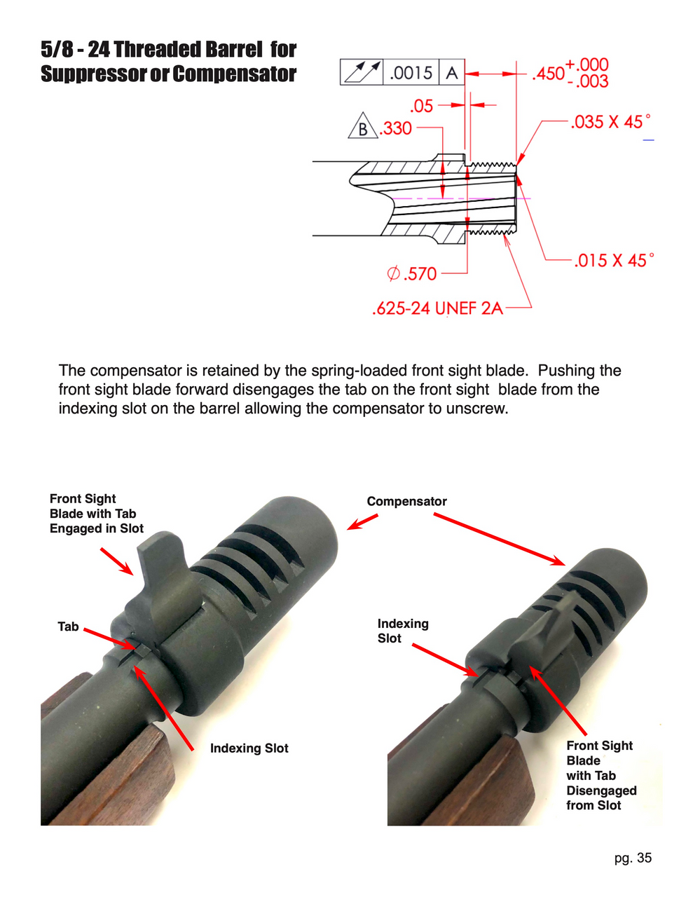

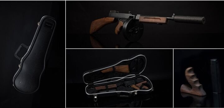

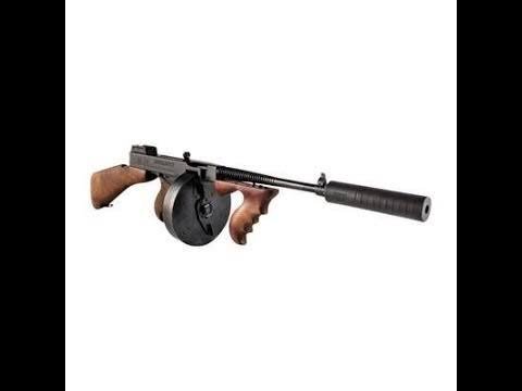

Bayrain Posted January 22 Report Share Posted January 22 Was going to say that BRP has a 5/8"-24 threaded Cutts comp for the Thompson knock off, but yall are doing .578-28 threaded pitch instead. Has a pretty sweet index as well. Also found more pictures of a suppressed thompson. Link to comment Share on other sites More sharing options...
H2munitions Posted Wednesday at 04:55 PM Author Report Share Posted Wednesday at 04:55 PM On 1/22/2026 at 1:39 PM, Bayrain said: Was going to say that BRP has a 5/8"-24 threaded Cutts comp for the Thompson knock off, but yall are doing .578-28 threaded pitch instead. Has a pretty sweet index as well. Also found more pictures of a suppressed thompson. Ooo I had no idea this existed. I might just have to use this setup for a 1928 build. Thanks! Link to comment Share on other sites More sharing options...
