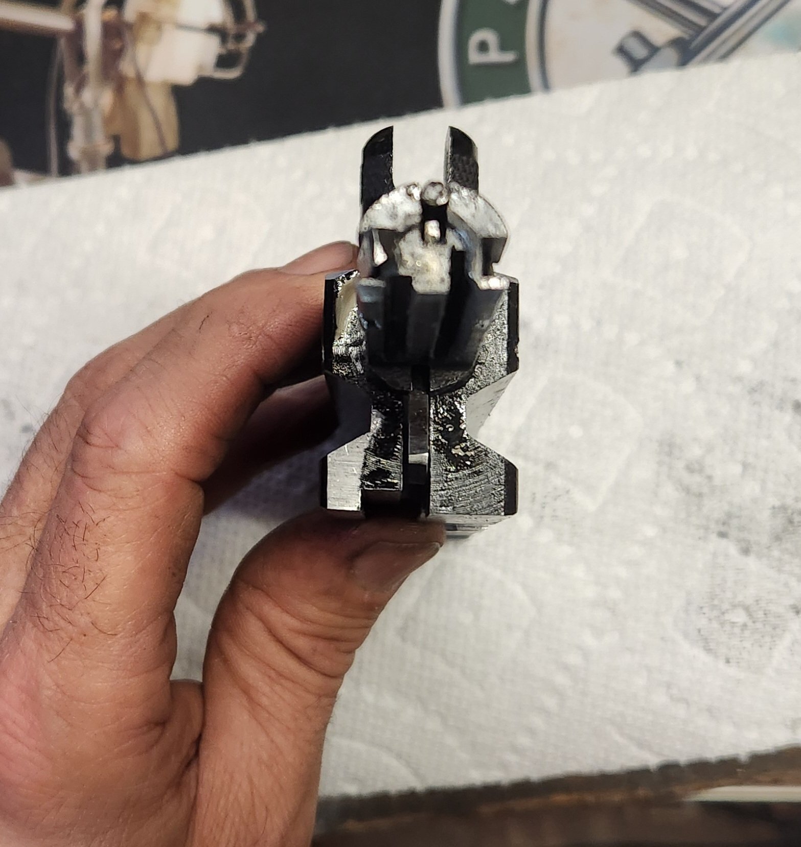

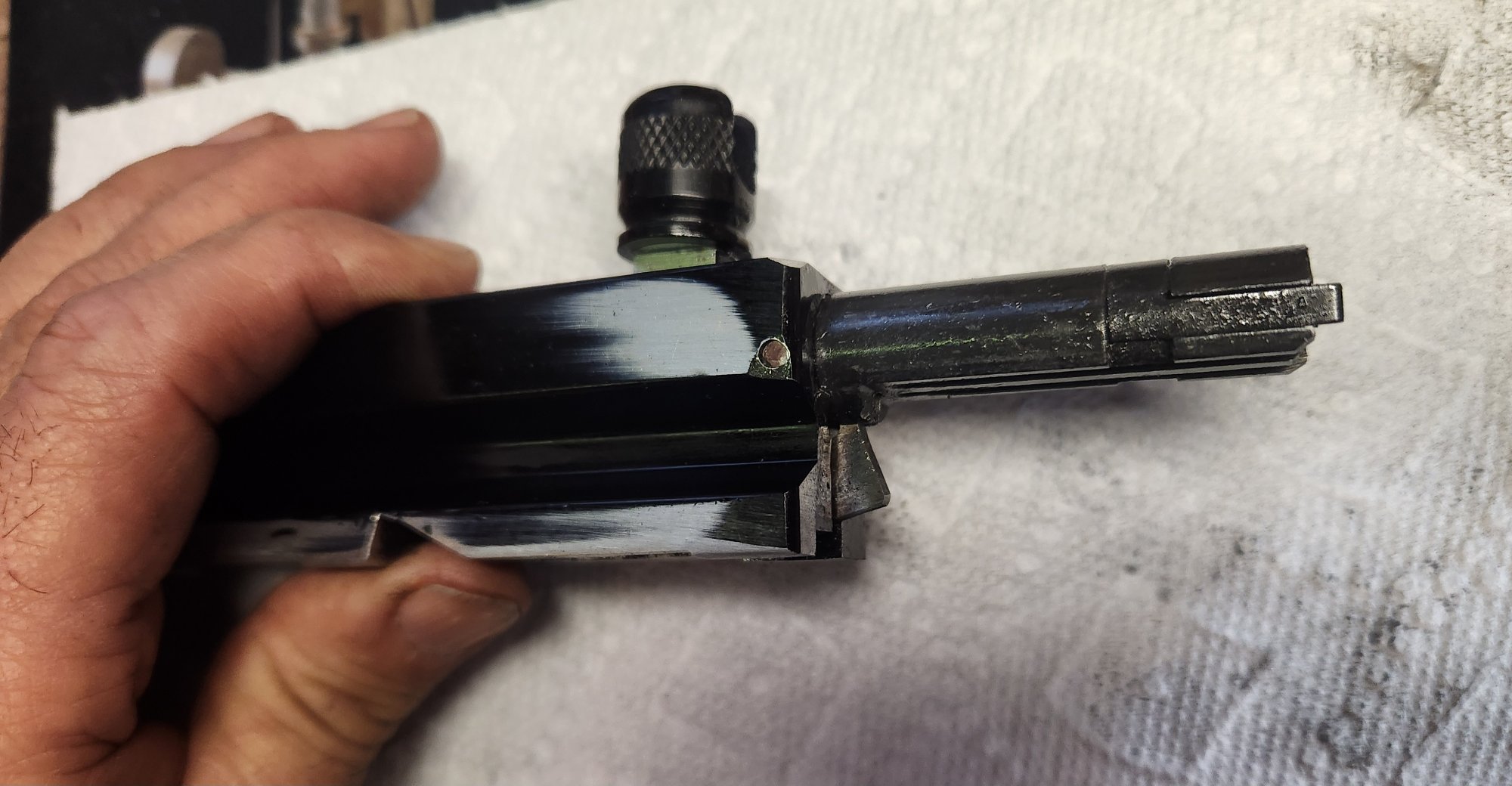

deerslayer Posted January 6 Author Report Share Posted January 6 I just happened to have a customer send me a gun with the pivoting hammer and moving firing pin. Thought id add it to the database here! This of course is reminiscent of how the actual 45 caliber Gun Works. One warning on testing this gun with Winchester Wildcat just the impact of the bolt will detonate the round without the firing pin actually hitting the rim. I have found Wildcat ammo is very primer sensitive and this proves it. 1 Link to comment Share on other sites More sharing options...
TD. Posted January 6 Report Share Posted January 6 Dan, I believe this is variation #1, above. Can you describe the problem with this WH, and how you are going to correct it? I was thinking this early variation worked best. Thanks for all you do. Link to comment Share on other sites More sharing options...
deerslayer Posted January 15 Author Report Share Posted January 15 So the potential problem with the moving firing pin is that the design of the bolt is different than a 45 caliber. When the bolt is slamming all the way forward the firing pin is also moving forward Beyond the Edge of the bolt face. In both guns. In a 45 caliber the round doesn't seat fully against the face of the bolt until the bolt goes closed. At which point the primer is hit by the firing pin. In the 22 the case is sliding up against the face of the bolt as it Chambers. Therefore if the firing pin is protruding a little bit right before the bolt fully slams home the rim can catch on the edge of the firing pin at the top of the bolt on the 22. This can lead to failures to fire. Link to comment Share on other sites More sharing options...
deerslayer Posted January 15 Author Report Share Posted January 15 This particular gun came in so I could build an extra magazine for it and troubleshoot why it didn't work very well. Existing magazines were not fitted well. And as mentioned above it would have failures to fire due to the firing pin design. I have changed it to number three. Link to comment Share on other sites More sharing options...
