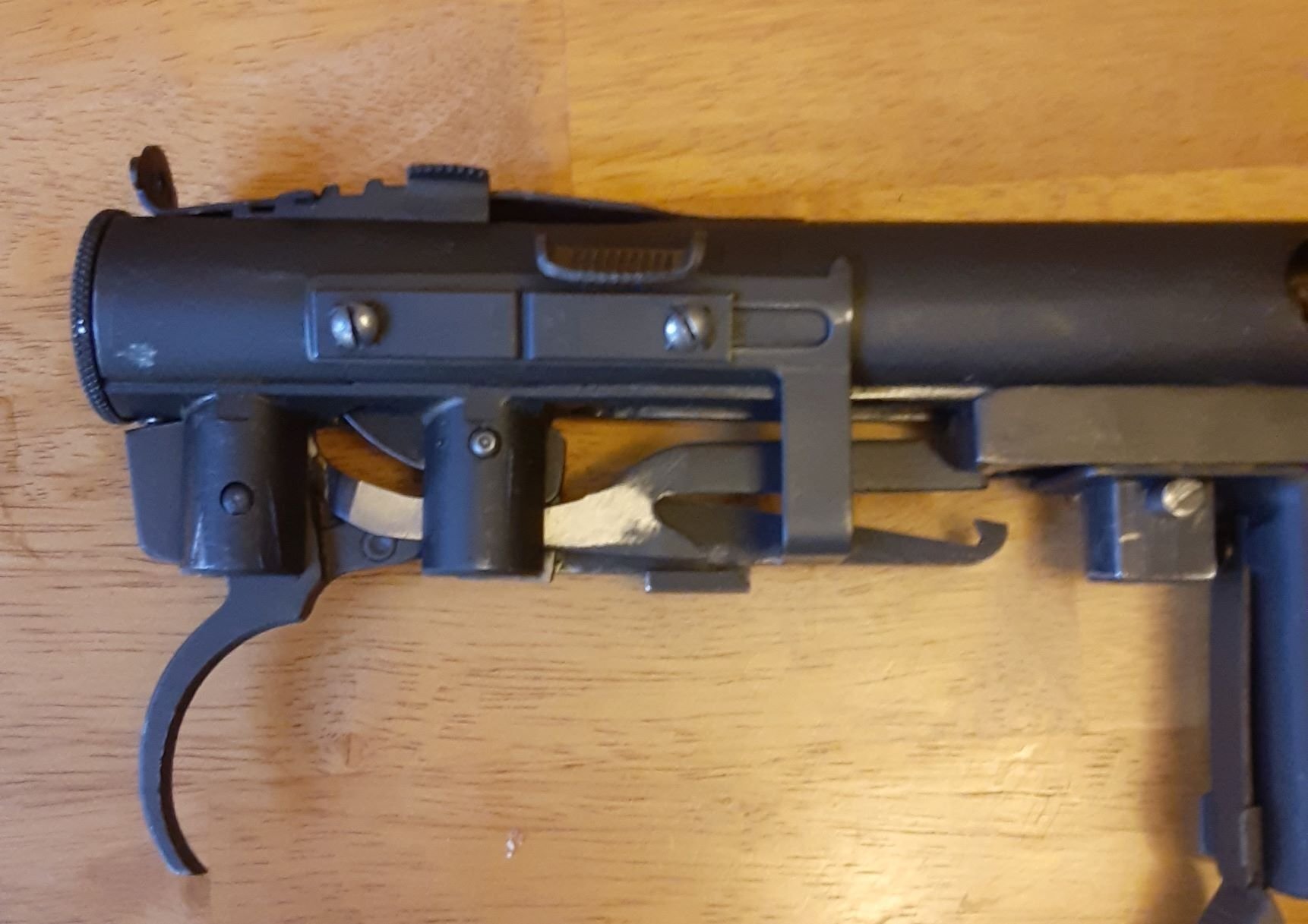

StrangeRanger Posted October 31, 2025 Report Share Posted October 31, 2025 (edited) PM me your email and Ill send you a PDF of the dis assembly/assembly instructions In the meantime these pix may help FA mode action cocked but unfired FA mode fired Edited October 31, 2025 by StrangeRanger Link to comment Share on other sites More sharing options...
fartsalot Posted November 2, 2025 Report Share Posted November 2, 2025 (edited) Stranger Ranger ? what is the lite colored part about ? PM sent your way Edited November 2, 2025 by fartsalot I'm drunk again Link to comment Share on other sites More sharing options...
StrangeRanger Posted November 3, 2025 Report Share Posted November 3, 2025 Worn Parkerizing Link to comment Share on other sites More sharing options...
fartsalot Posted November 3, 2025 Report Share Posted November 3, 2025 gotcha Link to comment Share on other sites More sharing options...

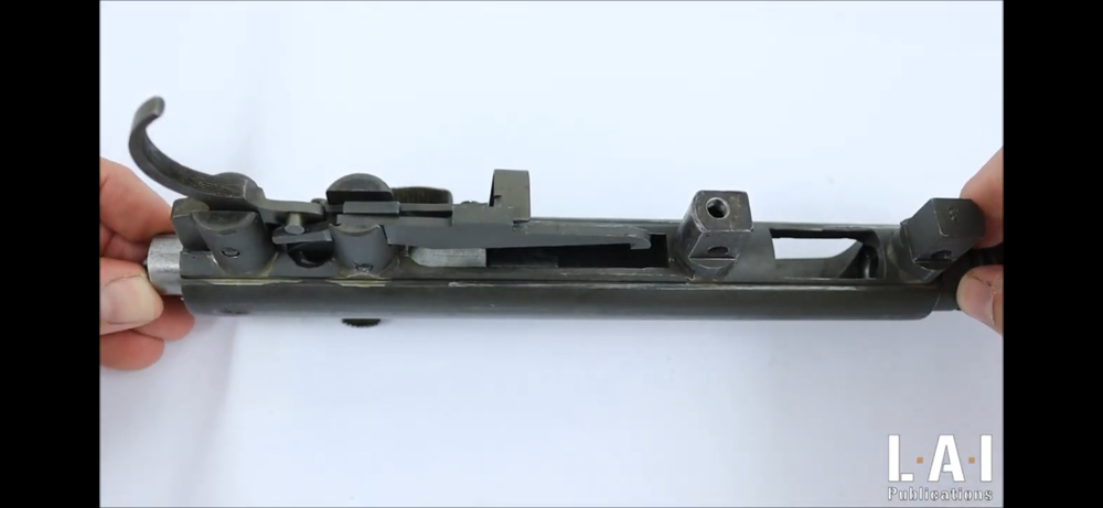

Duza9999 Posted November 5, 2025 Author Report Share Posted November 5, 2025 My only guess is that I somehow screwed up installing the sear wrong, as before reattaching the trigger, the auto connector wants to take a nose dive and jam itself right on the edge of the receiver. When installing the trigger, there’s not enough clearance for it to actuate. However what I don’t understand is I think I'm doing what they’re showing in the reassembly portion of that video. @Frank I. @StrangeRanger Link to comment Share on other sites More sharing options...
Frank I. Posted November 6, 2025 Report Share Posted November 6, 2025 It looks like the auto-connector is installed incorrectly, unless the trigger is pulled, it should be higher as in the lower photo. The tab on the auto-connector bar rides over the top of the leg of the selector lever. Check to see if the auto-connector lever spring is installed OR the trigger is stuck back in the fire position, try very GENTLY tapping it forward with a plastic hammer. Link to comment Share on other sites More sharing options...

Duza9999 Posted November 6, 2025 Author Report Share Posted November 6, 2025 5 hours ago, Frank I. said: It looks like the auto-connector is installed incorrectly, unless the trigger is pulled, it should be higher as in the lower photo. The tab on the auto-connector bar rides over the top of the leg of the selector lever. Check to see if the auto-connector lever spring is installed OR the trigger is stuck back in the fire position, try very GENTLY tapping it forward with a plastic hammer. I agree I’m reasonably confident it’s the auto connector or auto sear, but for the life of me (and a local gunsmith) we can’t figure out what’s wrong. This gun functioned flawlessly until I took it apart 3-4 weeks ago to replace the various springs. Video one shows the stripped receiver and parts Video two shows trying to fit the parts in without putting the pins through. https://youtu.be/td4hUk6qPDo?si=JgGsrDtGzH1AqQzl Video three and four are the partsinstalled, (very likely incorrectly, but I’m not sure *why* it’s incorrect). (Frank is already going to get pinged due to it being a reply so I’ll just tap Orion). @Orion Link to comment Share on other sites More sharing options...
Frank I. Posted November 6, 2025 Report Share Posted November 6, 2025 I made a video of mine, note the position of the auto-connector lever, it is higher than the one in your video. Image quality is not very good, but I think it is sufficient. Check the hole that the spring for the auto-connector fits, make sure there isn't part of a spring or spring cap inside the hole. Link to comment Share on other sites More sharing options...
