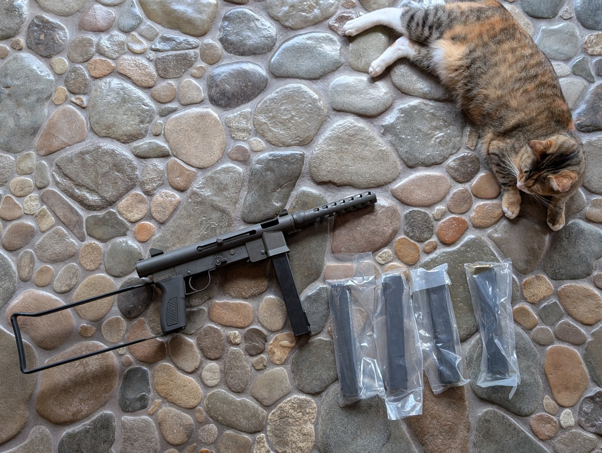

madkiwi Posted November 19, 2025 Report Share Posted November 19, 2025 I must be doing something wrong... I recently acquired a MK Arms MK760, did not come with any magazines. So I looked for and found someone on GB selling some Suomi magazines. When they arrived yesterday I went to check fitment and they insert completely and lock in. When the mag release is pressed they drop free. So I am scratching my head wondering why I don't need to modify the magazines at all. Everything I have read so far insisted I would have to relieve the lugs on the front of the magazine to make it fit. All 5 magazines I purchased fit just fine. Attaching a picture showing the markings. Is this normal or did I luck out? Thanks for any input. madkiwi Link to comment Share on other sites More sharing options...
tomk Posted November 20, 2025 Report Share Posted November 20, 2025 I had my current MK760 modified to use unaltered Suomi mags. If I recall correctly it is the mag catch that needs a little adjustment. I'm kind of surprised that it is not more common than it is. Enjoy using cheap and plentiful mags! Link to comment Share on other sites More sharing options...

Rekraps Posted November 20, 2025 Report Share Posted November 20, 2025 Lucky dog. I spent hours on a grinder making mine work. Then I paid Andrewski to do a professional job and modify four or five like OEM M76's. Link to comment Share on other sites More sharing options...
madkiwi Posted November 21, 2025 Author Report Share Posted November 21, 2025 Went to the range with them today. They all worked perfectly, even though the sideways wiggle was a little disconcerting- not nearly as tight as a Sterling magwell. Purchased 5 and they are beautiful, no surface corrosion, scratches or dents. The GB seller has a number of these still available. I contacted them directly and I have 10 more coming. I was not expecting the cyclic rate of the MK760. My Sterling is like 550 rpm, the MP40 is a sedate 500 or so. This gun is supposedly around 720 rpm, and I believe it. Link to comment Share on other sites More sharing options...

Chopper28 Posted December 10, 2025 Report Share Posted December 10, 2025 I had an MK760 that would not run well with the Soumi mags. So I sent it to PK along with some mags to modify. After checking it out he called me and suggested modifying the gun instead of the mags. That way it will work with all the Suomi mags you have without having to modify them. Problem solved. Got the gun back from PK and it ran perfectly Link to comment Share on other sites More sharing options...

tomk Posted December 17, 2025 Report Share Posted December 17, 2025 Fix the gun. It's just the mag catch. Link to comment Share on other sites More sharing options...
