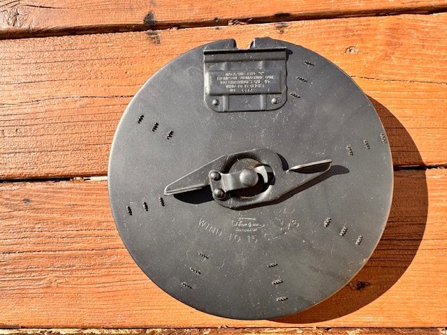

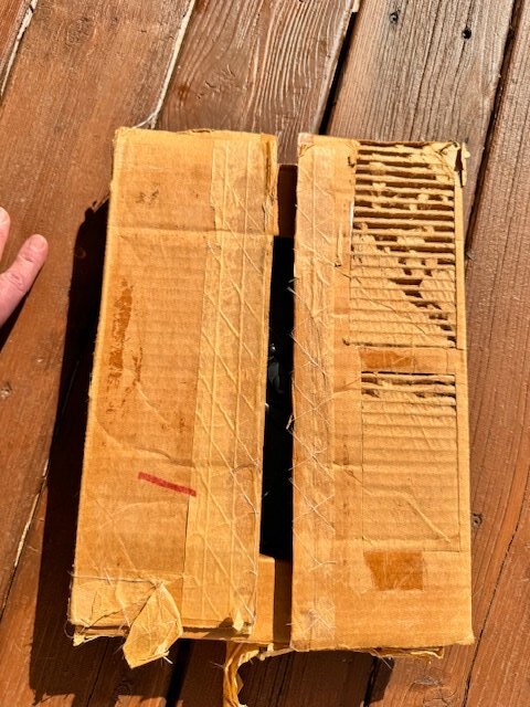

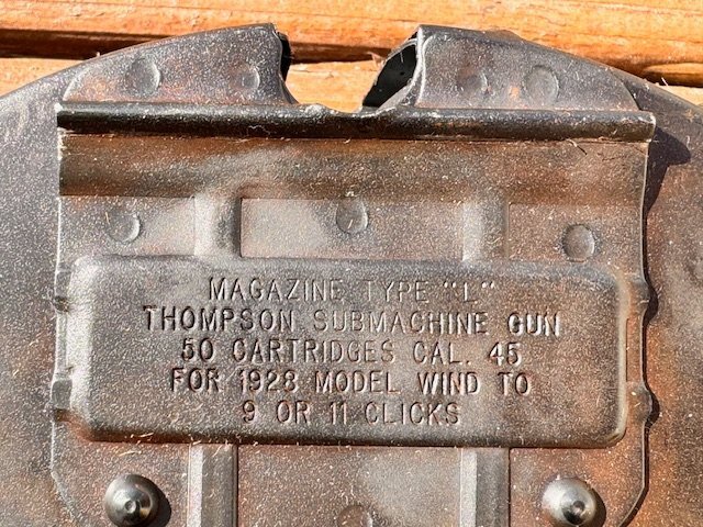

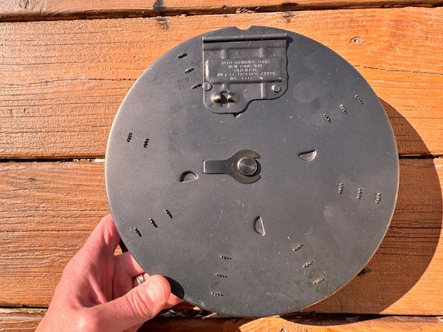

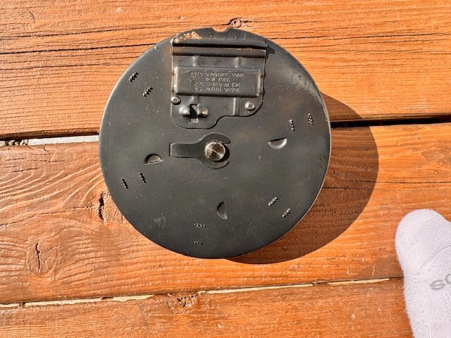

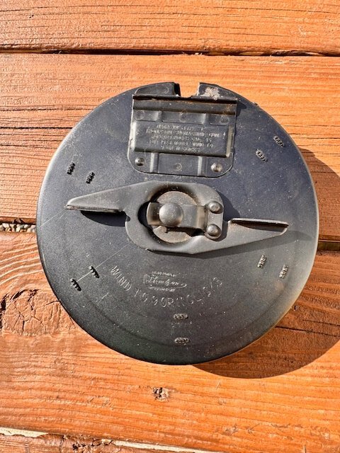

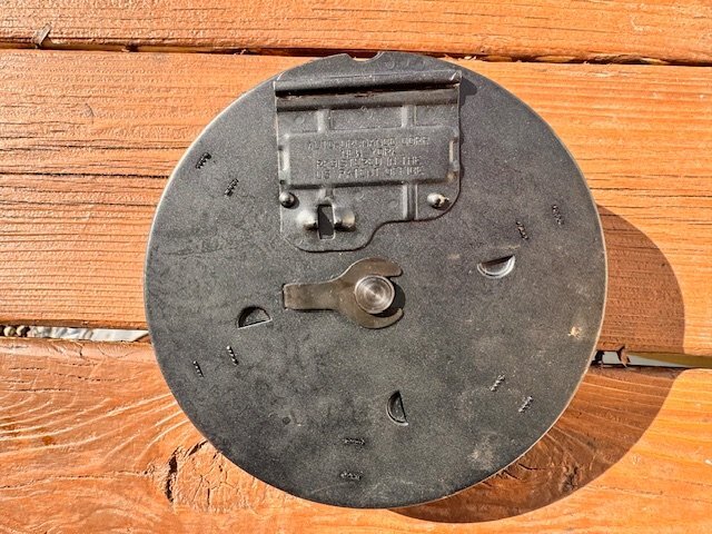

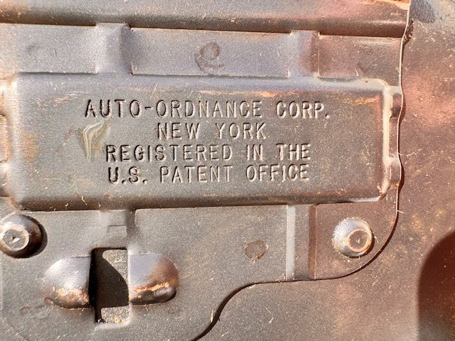

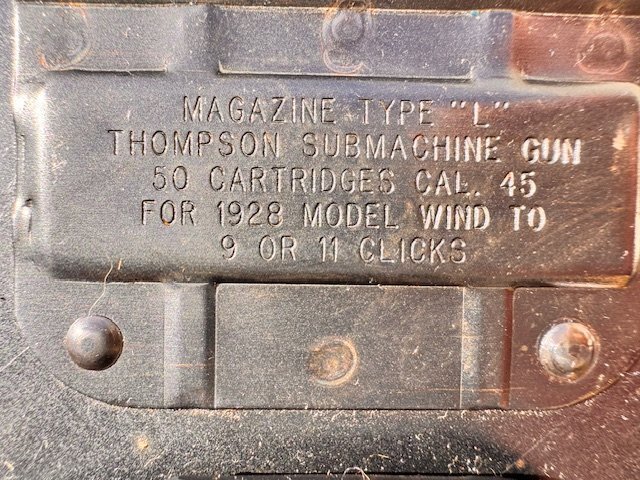

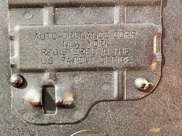

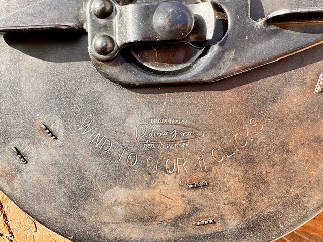

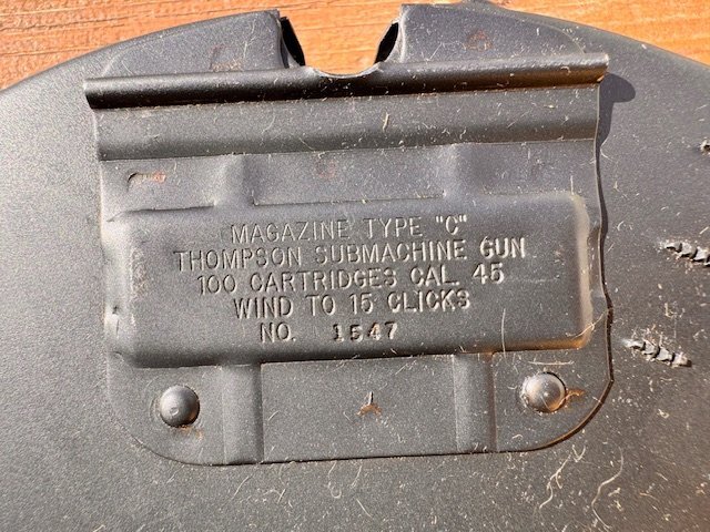

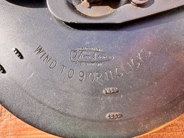

kp31 Posted November 30, 2025 Report Share Posted November 30, 2025 (edited) Backstory: I bought a 1928 last year from a widow who's husband died in 2006. I picked up 3 drums from her as well. They are repros but I'm not certain of origin even after reading the great guide on drums on this site. The 100 round in box has a fedex label dated 1999. West Hurley? Other? Clearly 2005 or before. Thanks! 100: 50# 1 GTF 50 #2 Edited November 30, 2025 by kp31 Link to comment Share on other sites More sharing options...
Mike Hammer Posted November 30, 2025 Report Share Posted November 30, 2025 Your C drum is a West Hurley. Link to comment Share on other sites More sharing options...
ron_brock Posted November 30, 2025 Report Share Posted November 30, 2025 The solid rotor shafts would point all of them being WH. Link to comment Share on other sites More sharing options...
TSMG28 Posted December 1, 2025 Report Share Posted December 1, 2025 The C drum and 50#1 are both Numrich/West Hurley. Drum 50#2 is a Kahr drum made to the same design as the Numrich drums, but by a different manufacturer selected by Kahr. All three have suspect reliability, so I recommend testing each. 1 Link to comment Share on other sites More sharing options...
kp31 Posted December 1, 2025 Author Report Share Posted December 1, 2025 (edited) Thanks guys - I assume these are 80s or 90s production? And any way to tell if they've been "upgraded" or fixed - I've read some parts may have been replaced to increase performance. Edited December 1, 2025 by kp31 Link to comment Share on other sites More sharing options...
68coupe Posted December 1, 2025 Report Share Posted December 1, 2025 The Kahr L drum that came with my '27 was a POS out of the box. The 4 I repops bought from Sarco work fine. Karl, 68coupe Link to comment Share on other sites More sharing options...
TSMG28 Posted December 1, 2025 Report Share Posted December 1, 2025 It is unlikely that any of the drums have been “updated”. Potential problems are many: weak and/or short springs in the C drums; faceplates being out of spec and/or misplaced, preventing insertion into a gun, or orienting the drum so that rounds do not feed properly; inside rails not properly installed, causing narrow feed paths which cause feeding problems; and, out-of-spec feed opening in the drum. Updates could address any of the above issues found, and often included replacing the center hub with a hollow hub like original drums (when the springs were replaced). The presence of solid hubs probably means no update on your drums. Some West Hurley L drums did work fine out of the box, so it is worth testing. I know of no WH C drum that works properly. Most Kahr L drums with solid hubs also will not work in full auto guns. Later Kahr L drums with hollow hubs also often have reliability problems. YMMV… Link to comment Share on other sites More sharing options...
