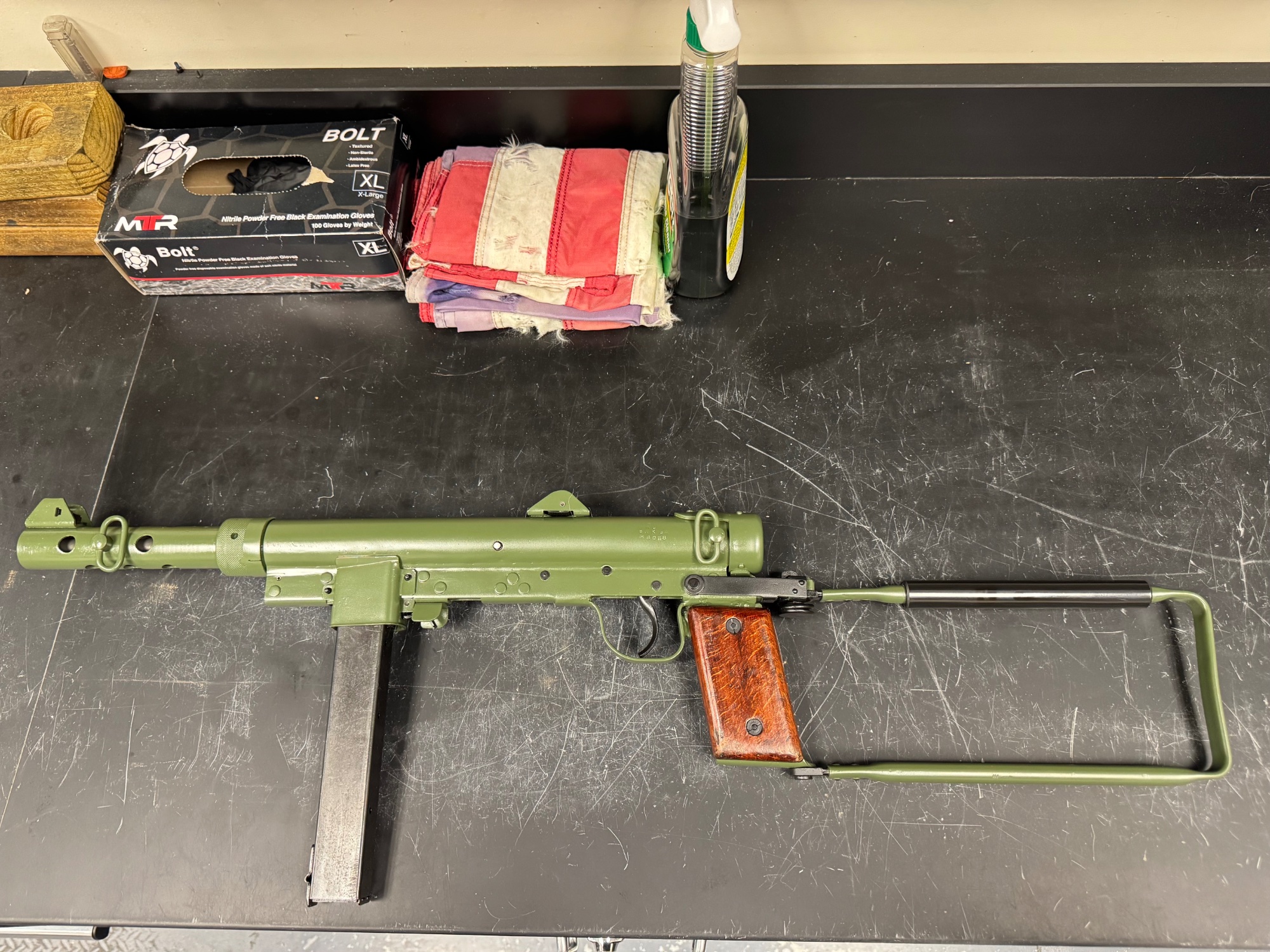

Remo Williams 1 Posted January 8 Report Share Posted January 8 When I received my K, it had a few issues. The receiver tube’s internal diameter was too tight for an unmodified bolt. The bolt with the K was sanded down to fit. My earlier K ( Wilson MB044 from 2005) had the same issue. The rubber tube for the cheek piece was rotted and torn. Another issue was the gun was painted green over the pins and trigger. I had a spare parts kit and wanted to add the rivet on top of the receiver for the J hooked cap. I took it to the range 3 times and it shot flawlessly. I decided to get it upgraded. Andrewski was very busy with loads of work and I didn’t want to wait the extended time. Not a complaint on him, he is a legend in the NFA community. After seeing his YouTube videos, I reached out to Dan of Samopal USA (a member of this forum known as Zavrit). Dan inspected the K and discovered that the sear pins were loose from enlarged holes and the rear sling swivel weld was failing. Dan tightened up the sear pin holes and installed pins from my spare parts kit. The interior of the tube was sanded and a replacement bolt fits perfect. Dan then offered to add my serial number to the shrouds and clean up the gap between the magwell and receiver. A brand new cheek piece was applied to my stock. The rear sight left side protector was slightly bent, preventing the rear sight to change settings. This was also fixed. Everything turned out great and Dan sent me constant emails with questions/suggestions and pictures of the progress. A video of the K firing was also emailed to me. I am very happy with the work done. The wait was 5 weeks as Dan had other work lined up ahead of mine. I would definitely do business with him again. 1 Link to comment Share on other sites More sharing options...

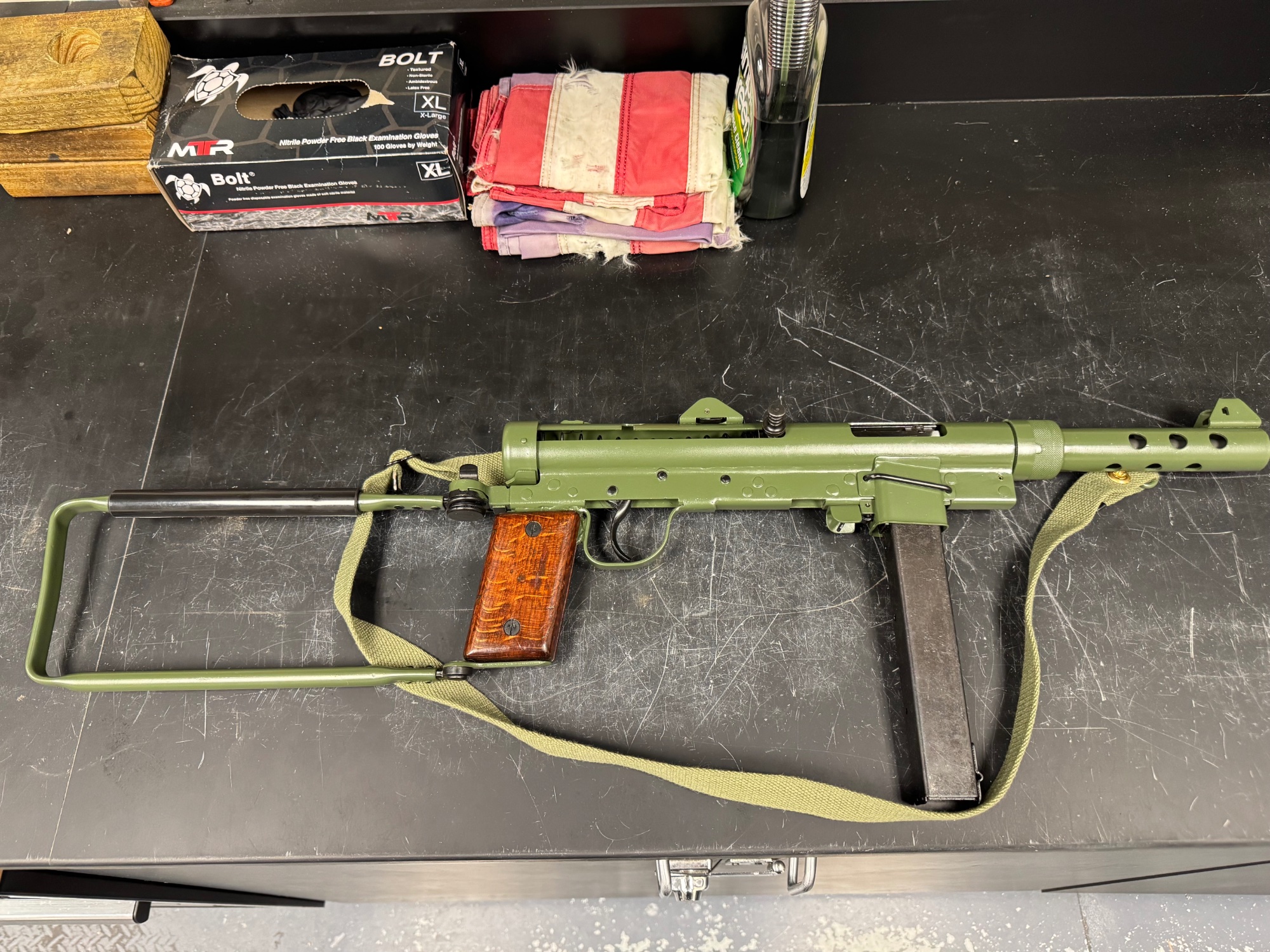

Remo Williams 1 Posted January 8 Author Report Share Posted January 8 Other side 1 Link to comment Share on other sites More sharing options...
Rekraps Posted January 8 Report Share Posted January 8 Nice job. Wow that gun had a few issues! Link to comment Share on other sites More sharing options...
Remo Williams 1 Posted January 8 Author Report Share Posted January 8 25 minutes ago, Rekraps said: Nice job. Wow that gun had a few issues! Scott it had issues, but shot great. My first K had the same and much worse issues such as a drooping barrel, the lower portion of the receiver was welded on crooked and gaps in the weld. I am very happy that it now takes standard bolts, has the J hook end cap and looks great. Dan’s main work is Czech weapons. After this experience, I want to have him build me a VZ58. Link to comment Share on other sites More sharing options...
