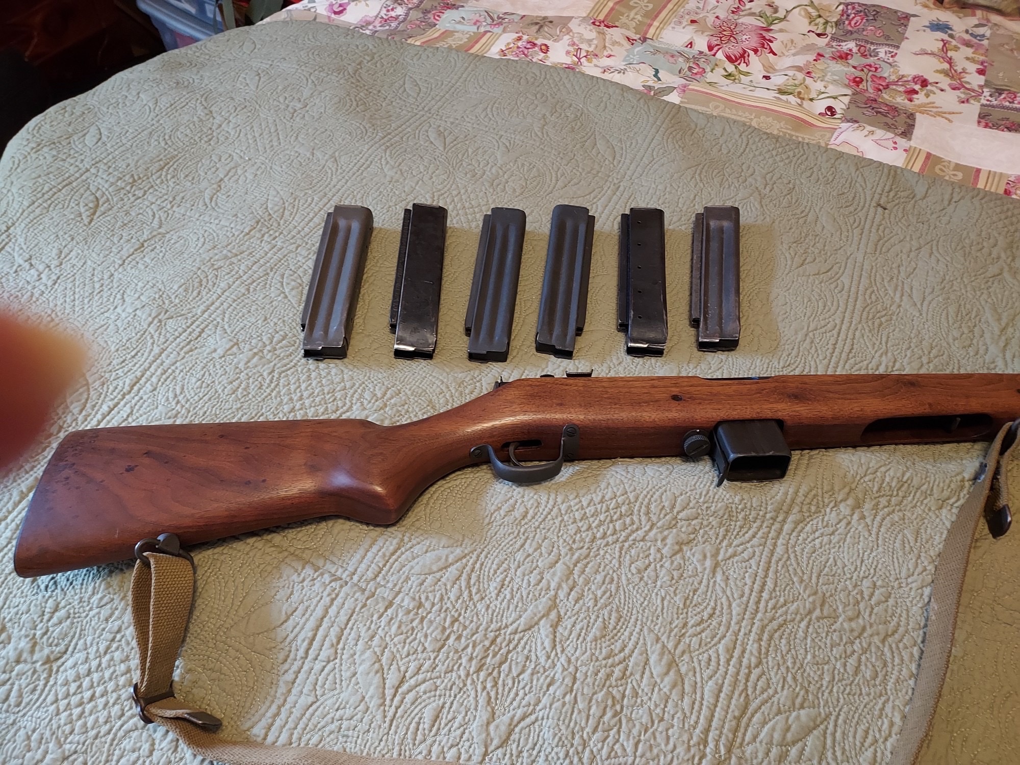

Mattg203 Posted January 16 Report Share Posted January 16 Hey I have a friend selling a Reising and it looks really good with lots of mags. I don’t know anything about them. Any input on value and condition and year would be helpful. Thank you! Link to comment Share on other sites More sharing options...
StrangeRanger Posted January 16 Report Share Posted January 16 The S- prefix on the S/N indicated it was assembled by Numrich in 198(7?) out of parts that they acquired from H&Rs closing. I can't see the sights or the barrel but the trigger guard, mag release, taskedown screw and selector lever all appear to be correct for a Numrich gun. Those two 20 round mags are worth their weight in gold Link to comment Share on other sites More sharing options...
Mattg203 Posted January 16 Author Report Share Posted January 16 (edited) 3 hours ago, StrangeRanger said: The S- prefix on the S/N indicated it was assembled by Numrich in 198(7?) out of parts that they acquired from H&Rs closing. I can't see the sights or the barrel but the trigger guard, mag release, taskedown screw and selector lever all appear to be correct for a Numrich gun. Those two 20 round mags are worth their weight in gold What do you think the value of this is with all the mags? thanks Edited January 16 by Mattg203 Link to comment Share on other sites More sharing options...
tommyboy Posted January 16 Report Share Posted January 16 (edited) In todays market, $8500-$9000 with the 5 extra mags. The 12 round mags are not really that desirable although they still sell for $125-$150 each. The gun only would probably fetch around $8000. Edited January 16 by tommyboy Link to comment Share on other sites More sharing options...
