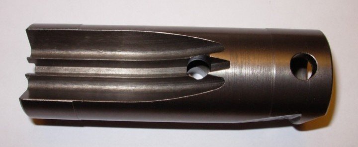

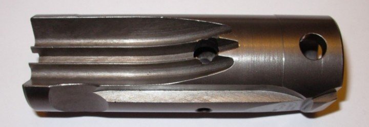

StrangeRanger Posted January 26 Author Report Share Posted January 26 (edited) It has a Lanchester bolt which is (as rekraps has often pointed out) is very similar to the FA-only MP18 bolt and llacks the cutouts required by the 28's select-fire mechanism MP28 bolt Lanchester bolt The "golden" part of that kluged up mess is the mag housing. Those things are made of unobtainium. The other bits and pieces have significant value too Edited January 26 by StrangeRanger sppelling Link to comment Share on other sites More sharing options...
Rekraps Posted January 26 Report Share Posted January 26 Great point. The Lanchester bolts can be used in the MP18, and accommodate the MP18 OEM mags, but not the other way around. The KMP18 bolt "ears" on either side of the ejector guide are too narrow (although they look very close) to allow for the Lanchester mags (STEN) to fit. Whereas, the MP18 magazine feed lips are narrower and fit the narrower guides on the MP18 bolt. Link to comment Share on other sites More sharing options...
