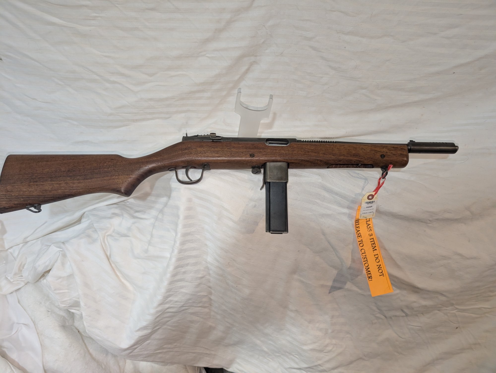

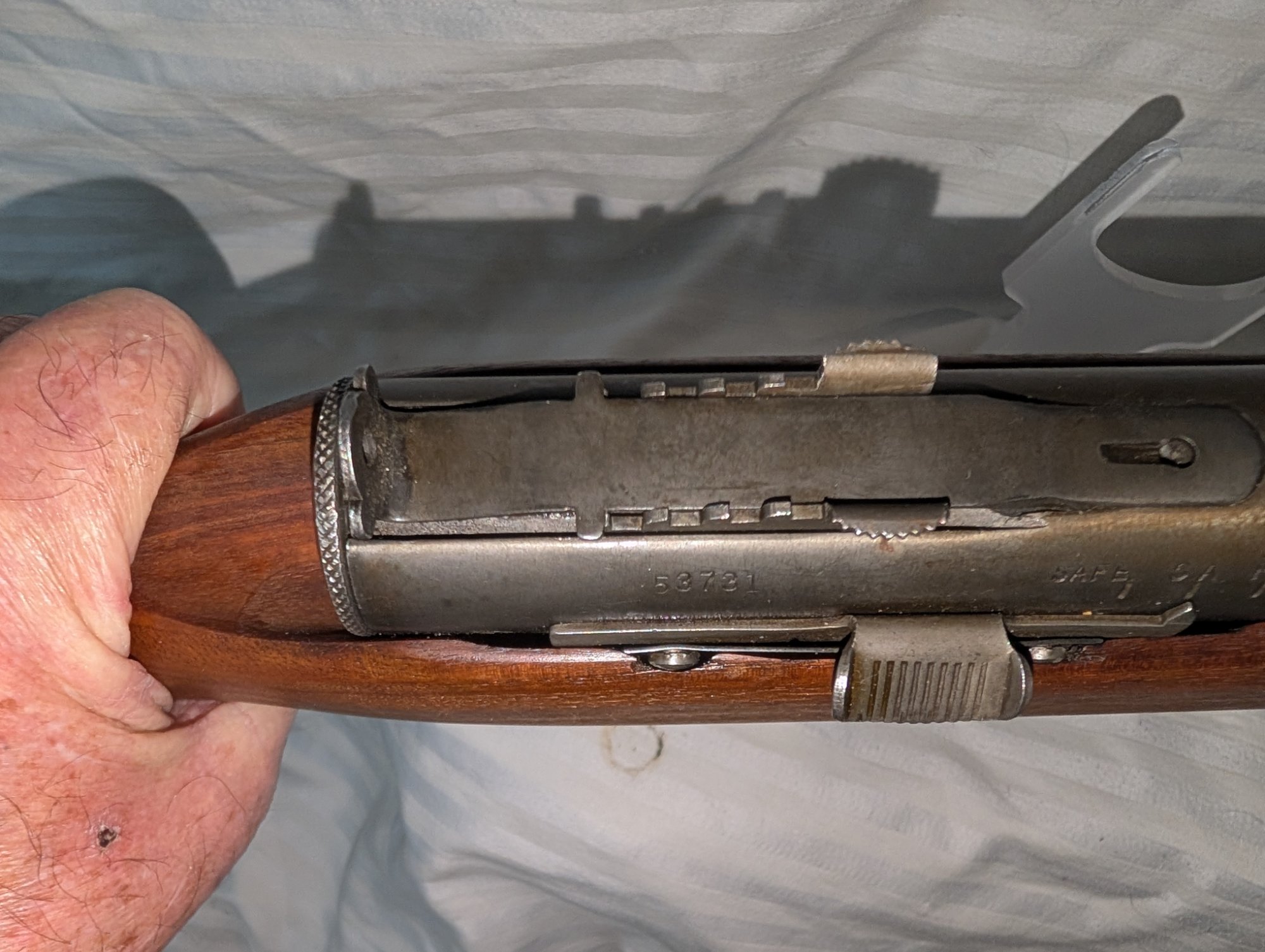

PilotDave Posted March 2 Report Share Posted March 2 I just sold a Model 50 that looked in superb external condition see pictures to a Coast guard Veteran I have 5 and never fired this one since buying it from Poulins Auction Buyer says it will not pick up rounds from magazine I sent him an original 20 round and new 30 round keystone magazine I suggest he read the tune up guide polish bolt etc Any other advice ? Could it have a week return spring? Link to comment Share on other sites More sharing options...
