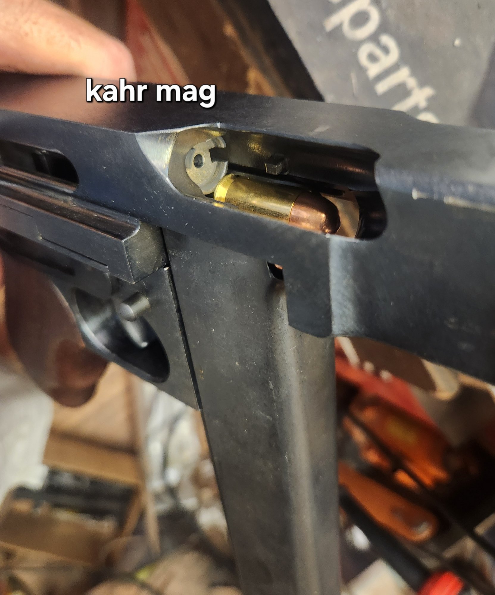

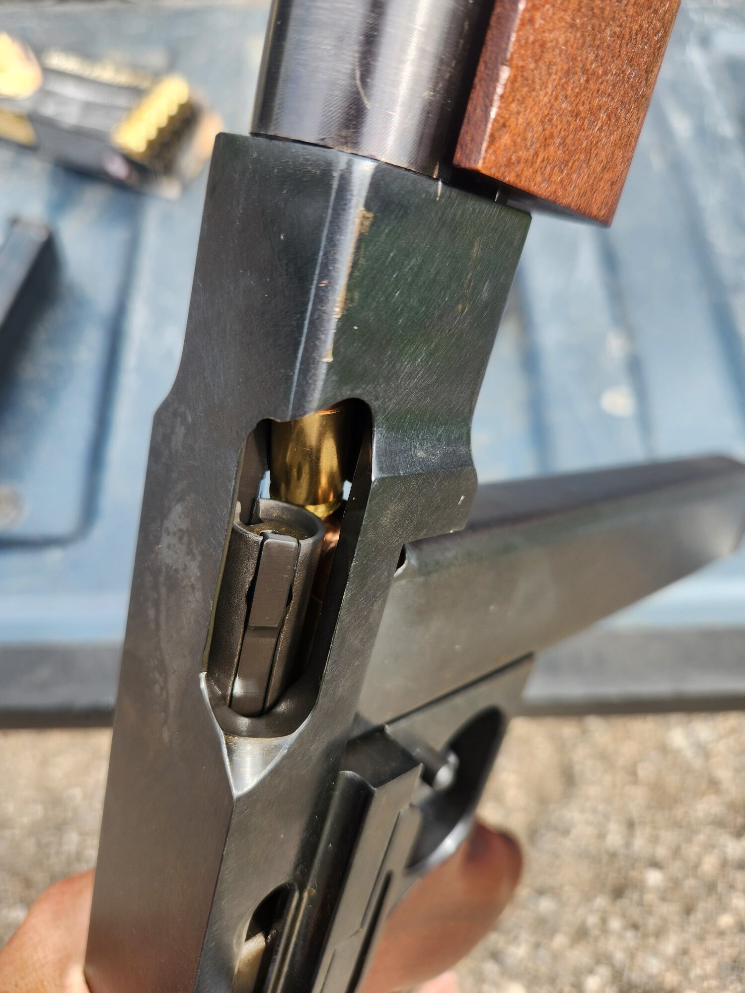

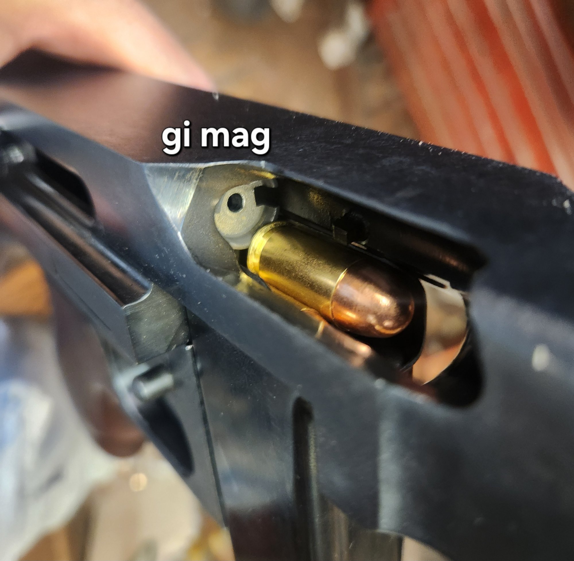

inspectorudy Posted March 5 Report Share Posted March 5 I bought some new ball ammo today and tried to cycle a few rounds through my unfired M1 it to see if it would work smoothly. I could only get the first round to chamber and then all after that jammed. I tried it several times with the same results. Has anyone else had this issue? What could I check? The first round ejects very well but the next round will not chamber and goes cross ways in the chamber area. I see no feed ramp of any kind and don't exactly understand what guides the next round into battery. Any ideas? Rudy Link to comment Share on other sites More sharing options...

deerslayer Posted July 7 Report Share Posted July 7 You probably have bad magazines for the rounds are sitting low that's what typically causes jams when you're trying to chamber around the best solution is to get GI mags with their feed lips properly shaped and fit to your gun Link to comment Share on other sites More sharing options...

inspectorudy Posted July 12 Author Report Share Posted July 12 It actually loads the first round into the chamber ok but if I try to cycle the bolt to eject the unspent round the next round and the ejected round interfere with each other. On my M1A, I can cycle through all the rounds in the mag without any issues. Same with my AK-47. Is this just a peculiarity of the gun? Link to comment Share on other sites More sharing options...
deerslayer Posted July 12 Report Share Posted July 12 Hand cycling doesnt diagnose things well in a kahr. Go shoot it and then report back. Take good pictures of the jams if they occur. Link to comment Share on other sites More sharing options...
