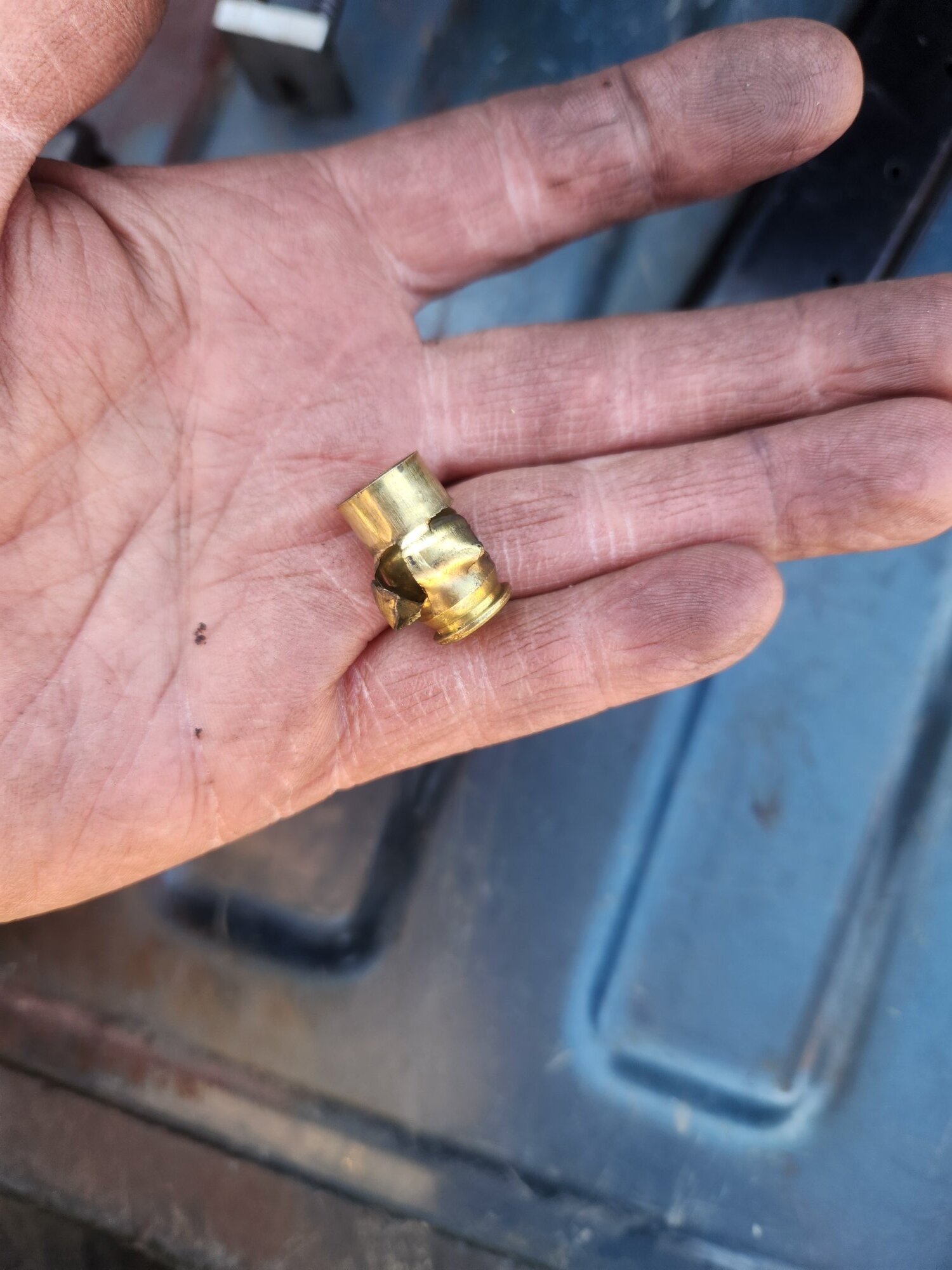

deerslayer Posted April 7 Report Share Posted April 7 I spent some time with two more guns doing my best to make them work well with the frt. By doing all the things I've mentioned before with semi-auto guns including opening the chamber and polishing the parts you get a pretty good running gun. But one thing that is cropping up with one of the guns is out of battery detonations. I was assuming that the cartridge was firing before the bolt completely closed but the super slow motion camera revealed what was really going on. The bolt was closing and bouncing back and then the cartridge was firing. I can't get a video of what the firing pin is doing, but as I think about it the firing pin is most likely traveling slightly behind the bolt as it goes forward. So the bolt hits, bounces, and then the firing pin hits and causes the primer to pop. Sometimes the bolt is just far enough back and the case is weak enough that it's popping the primer and bursting the case. Link to comment Share on other sites More sharing options...

deerslayer Posted April 8 Author Report Share Posted April 8 Well, no i havent done any slow motion of factory kahr guns. They dont run well enough as supplied. This was with factory springs. Ez pull did not work well. The frt operation steals some energy from the cycling process. I did another test with a longer firing pin spring and it seemed to eliminate the problem. Ill add the video later. 1 Link to comment Share on other sites More sharing options...
deerslayer Posted April 8 Author Report Share Posted April 8 Well, no i havent done any slow motion of factory semi auto kahr guns. They dont run well enough as supplied. This was with factory springs. Ez pull did not work well. The frt operation steals some energy from the cycling process. I did another test with a longer firing pin spring and it seemed to eliminate the out of battery firing from the bolt bounce. I used an extra long spring from my ezpull kits. (I normally cut to length). The extra enrrgy forward is showing no lag in the firing pin following behind the bolt. This coupled with the factory pair of recoil springs is actually too strong for full recoil as you will see in the video. You will also notice the bolt bounces while closing on the empty chamber. I only loaded 4 rounds for these slow motion videos. https://youtube.com/shorts/AZ8zaQeHa1Y?si=RSVajSlTaSZAw9QG Link to comment Share on other sites More sharing options...

deerslayer Posted April 10 Author Report Share Posted April 10 If you try to use a full length gi spring in the "firing pin" hole the total force to recoil and chamber a new round would probably be too much overcome. Link to comment Share on other sites More sharing options...

Merry Ploughboy Posted April 21 Report Share Posted April 21 5 hours ago, peter kohler said: so this frt has to be used with the factory springs? and a longer hammer spring? And a related, but perhaps academic question: I have the Howell "low pull effort" springs and buffer in my 27A1 and I believe that others do as well - how/what does this mean vis a vis the FRT? [I say "academic" because for me, to the best of my knowledge, FRT's and the like are considered unregistered machineguns under state law here, though the state AG has indicated that should the legislature and executive branches change the wording of the state machine gun law, the legality of FRT's would be reconsidered and could potentially be allowed. And in any case, I have a registered Thompson submachine gun, so a FRT 27A1 has a low level of interest even if legal to pursue.] MHO, YMMV, etc. Link to comment Share on other sites More sharing options...
deerslayer Posted April 21 Author Report Share Posted April 21 In my testing the ezpull springs dont work well with a fully loaded 30 round magazine. The kit induces a little more friction than normal. It would fire a lightly loaded magazine ok in the gun i was testing with ezpulls. The news is that a gi recoil spring cut to around 8 inches seems to have eliminated the out of battery issues some people have. 1 Link to comment Share on other sites More sharing options...
