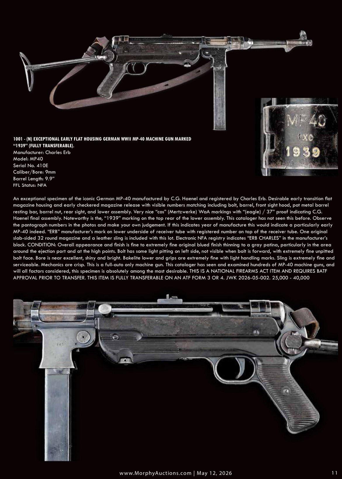

thompsonteenager Posted April 15 Report Share Posted April 15 (edited) I was looking through Morphy's catalogue for their upcoming auction and noticed this MP40. It has all the early features (despite the hook handle being replaced by schmeisser safety), but it is marked fxo and below 1939. They are saying this could be a year mark, but to my knowledge, the Germans didn't use three-letter factory codes until around 1941, unless my info is bad. Sorry, I have only been religiously researching guns for a few years. The Schmeisser Myth book says that Haenel made MP40s, but it was only during the second generation run of guns, around 1941-1942. Also, "ERB Charles" is listed on the registry as the manufacturer. If this gun were registered as is, wouldn't the manufacturer be listed as Germany? I just thought this gun would intrigue the minds of the many experts on this board. Thanks, Luke Edited April 15 by thompsonteenager Link to comment Share on other sites More sharing options...
tommyboy Posted April 15 Report Share Posted April 15 (edited) I would be very suspect of the 1939 date marking. As pointed out, the “FXO” manufacturer code wasn’t even in use at that time. Plus the gun’s original serial number of 31840 would place it in the later 1940 production range. The 1939 date was most likely added as an “enhancement” when the gun was manufactured by Erb. I say manufactured because I’m not even certain the gun is a rewatt. If it was a rewatt, there would be no reason for Erb to mark his name underneath and create a new serial number. Notice Morphys was also careful not to list the gun as C&R. If it was a rewatt. It would retain its C&R status. Whether or not the gun was actually manufactured by Erb or was just a “paperwork manufacture” is another matter altogether. Edited April 15 by tommyboy Link to comment Share on other sites More sharing options...
TSMGguy Posted April 15 Report Share Posted April 15 (edited) Lot Detail - (N) EXCEPTIONAL EARLY FLAT HOUSING GERMAN WWII MP-40 MACHINE GUN MARKED "1939" (FULLY TRANSFERABLE). The MP40 wasn't even adopted until 1940, with no serial production before that year. C. G. Haenel (fxo) made no MP40s before 1941. IMHO, somebody did some inadequate research and ended up producing a fantasy piece. This is a parts lash-up with a number of neatly applied but spurious serial numbers. It would probably make a good representative shooter for someone if the price was right. Edited April 19 by TSMGguy Link to comment Share on other sites More sharing options...
thompsonteenager Posted April 15 Author Report Share Posted April 15 1 hour ago, TSMGguy said: Lot Detail - (N) EXCEPTIONAL EARLY FLAT HOUSING GERMAN WWII MP-40 MACHINE GUN MARKED "1939" (FULLY TRANSFERABLE). The MP40 wasn't even adopted until 1940, with no serial production before that year. C. G. Haenel (fxo) made no MP40s before 1941. IMHO, somebody did some inadequate research and ended up producing a fantasy piece. This is a parts lash-up with a number of neatly applied but non original serial numbers. It would probably make a good representative shooter for someone if the price was right. 2 hours ago, tommyboy said: I would be very suspect of the 1939 date marking. As pointed out, the “FXO” manufacturer code wasn’t even in use at that time. Plus the gun’s original serial number of 31840 would place it in the later 1940 production range. The 1939 date was most likely added as an “enhancement” when the gun was manufactured by Erb. I say manufactured because I’m not even certain the gun is a rewatt. If it was a rewatt, there would be no reason for Erb to mark his name underneath and create a new serial number. Notice Morphys was also careful not to list the gun as C&R. If it was a rewatt. It would retain its C&R status. Whether or not the gun was actually manufactured by Erb or was just a “paperwork manufacture” is another matter altogether. I knew this gun was suspicious... Thanks for the info I knew the markings seemed off. I wonder why Morphys didnt catch that. Link to comment Share on other sites More sharing options...

Husker402 Posted April 16 Report Share Posted April 16 I also noticed that listing last night and it’s definitely “enhanced” with the 1939 date. Too bad, really. Not much collector value but I’ll still try to snag it if the price is right. It would still make a nice shooter. Link to comment Share on other sites More sharing options...
StrangeRanger Posted April 16 Report Share Posted April 16 (edited) It's a tube gun that was cobbled together from more than one donor. Whether Erb manufactured the receiver or "manufactured" the paperwork we'll never know. Erb may have intentionally put the impossible date on it as a caveat to possible future buyers; we'll never know that either. The flat sided mag housing adds a very small value to this one vs. every other tube gun in the Registry. The $25-40K estimated price is pure Scheisse. It probably shouldn't hammer much over $20-22K but someone will ignore the warnings in Morphy's description and overbid accordingly Edited April 16 by StrangeRanger Link to comment Share on other sites More sharing options...

StrangeRanger Posted April 16 Report Share Posted April 16 Morphy's gives an honest description including all the inconsistencies, then tells the bidders to "make your own judgment." That SHOULD be a huge red flag but.... They then say that it is "absolutely among the most desirable" specimens and list an expected price that is aspirational at best. It's a nice TUBE gun, nothing more Link to comment Share on other sites More sharing options...
