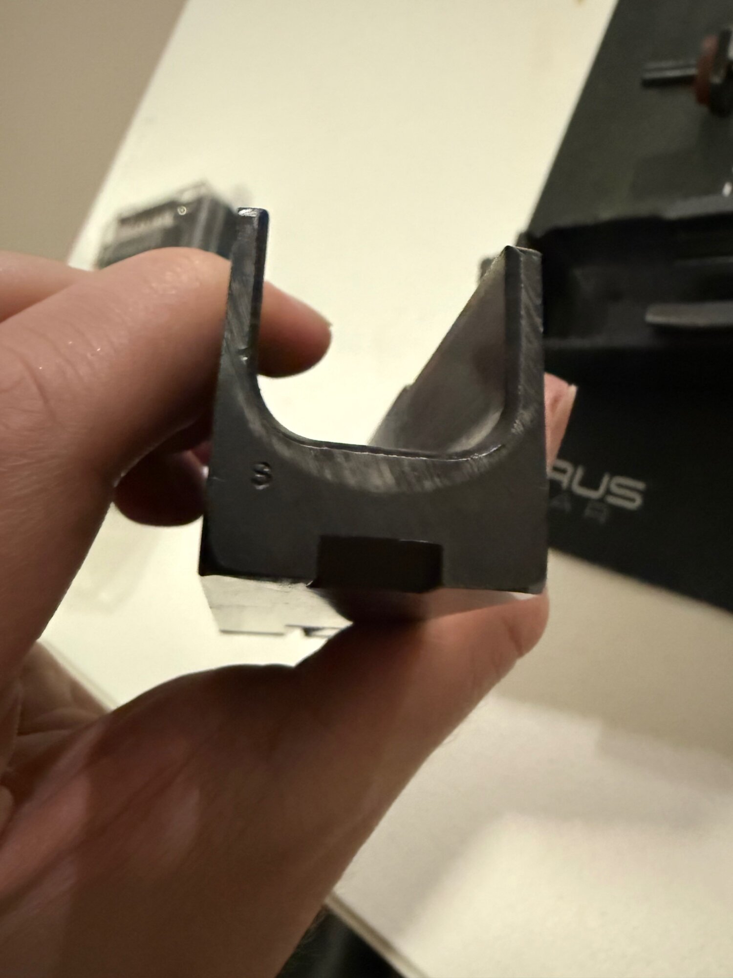

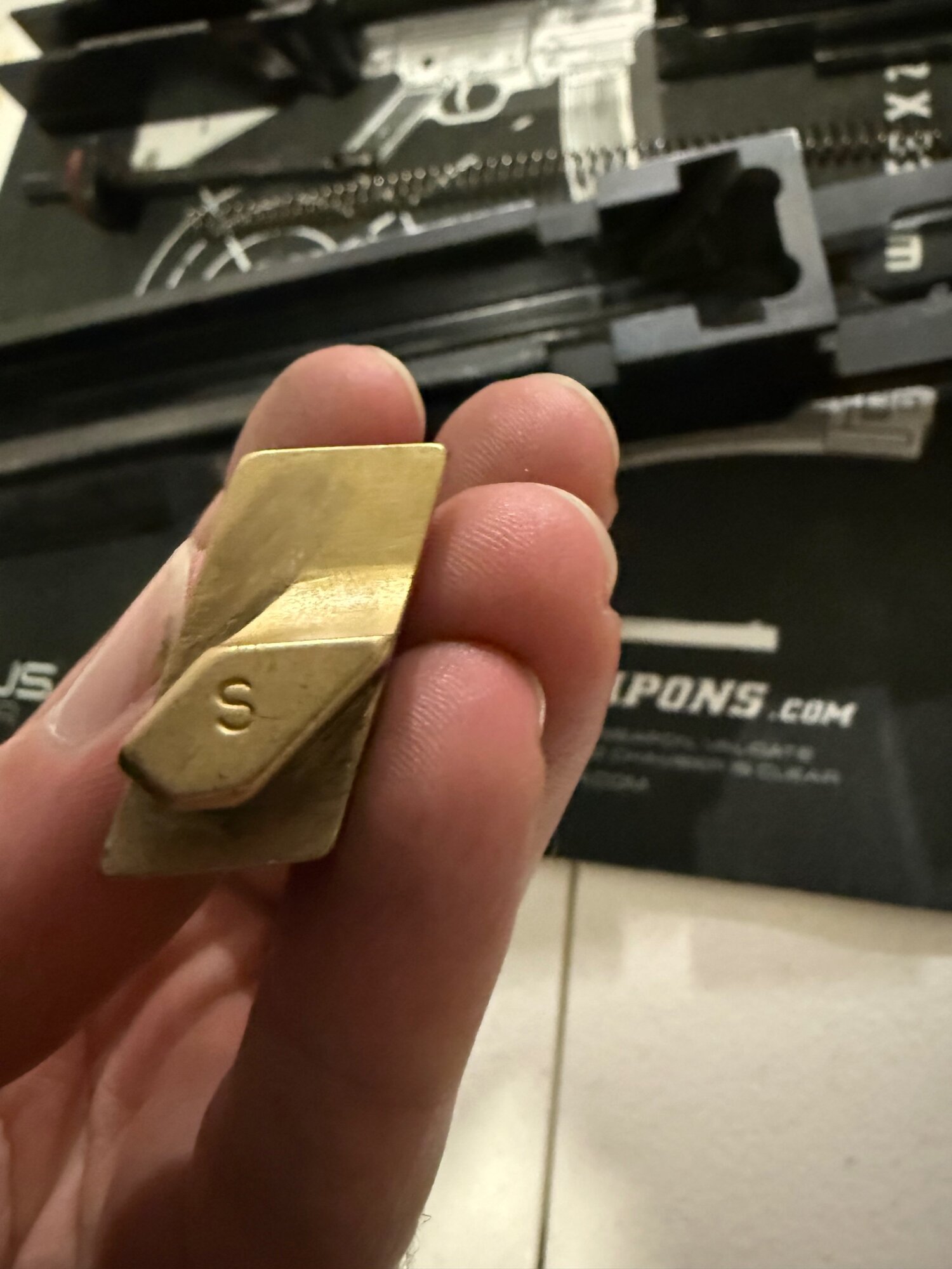

Doug Quaid Posted May 4 Report Share Posted May 4 3 hours ago, Countryboy77 said: I would swap the entire lower and whatever West hurley parts on top. Get rear sight properly fitted ,a GI front grip hanger and of course any bolt parts or even the bolt if not Gi.The Registered Receiver is what you purchased and if you want it up to par,swap everything Gi,barrel has to come out anyway,put a proper spec barrel too. Protect your investment. You can always keep the Original parts so if you sell it you have a nice package,or return it original and sell off the gi parts. But being a MG you cannot have enough spare parts Maybe an advanced collector would want the original WH parts as curiosities, but I doubt they would add to the resale value. When people buy Group Industries UZIs, they generally throw the Group made parts away. Like the bolts, for example. Link to comment Share on other sites More sharing options...
Doug Quaid Posted May 4 Report Share Posted May 4 On 5/2/2026 at 1:55 PM, Cipher032 said: Upon closer inspection, a previous owner already went about replacing the internals with GI parts. Just as a head's up, for some reason the WWII AOC and Savage blish locks are slightly different sizes. I have an original 1940 Savage Thompson and the AOC lock will not install in the gun. Link to comment Share on other sites More sharing options...

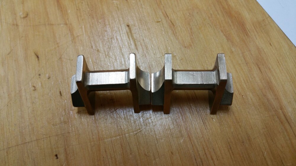

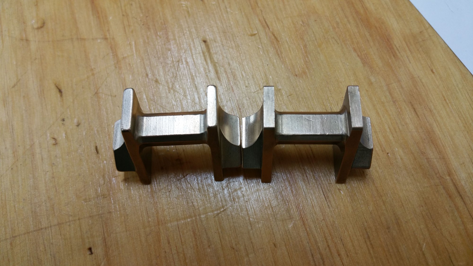

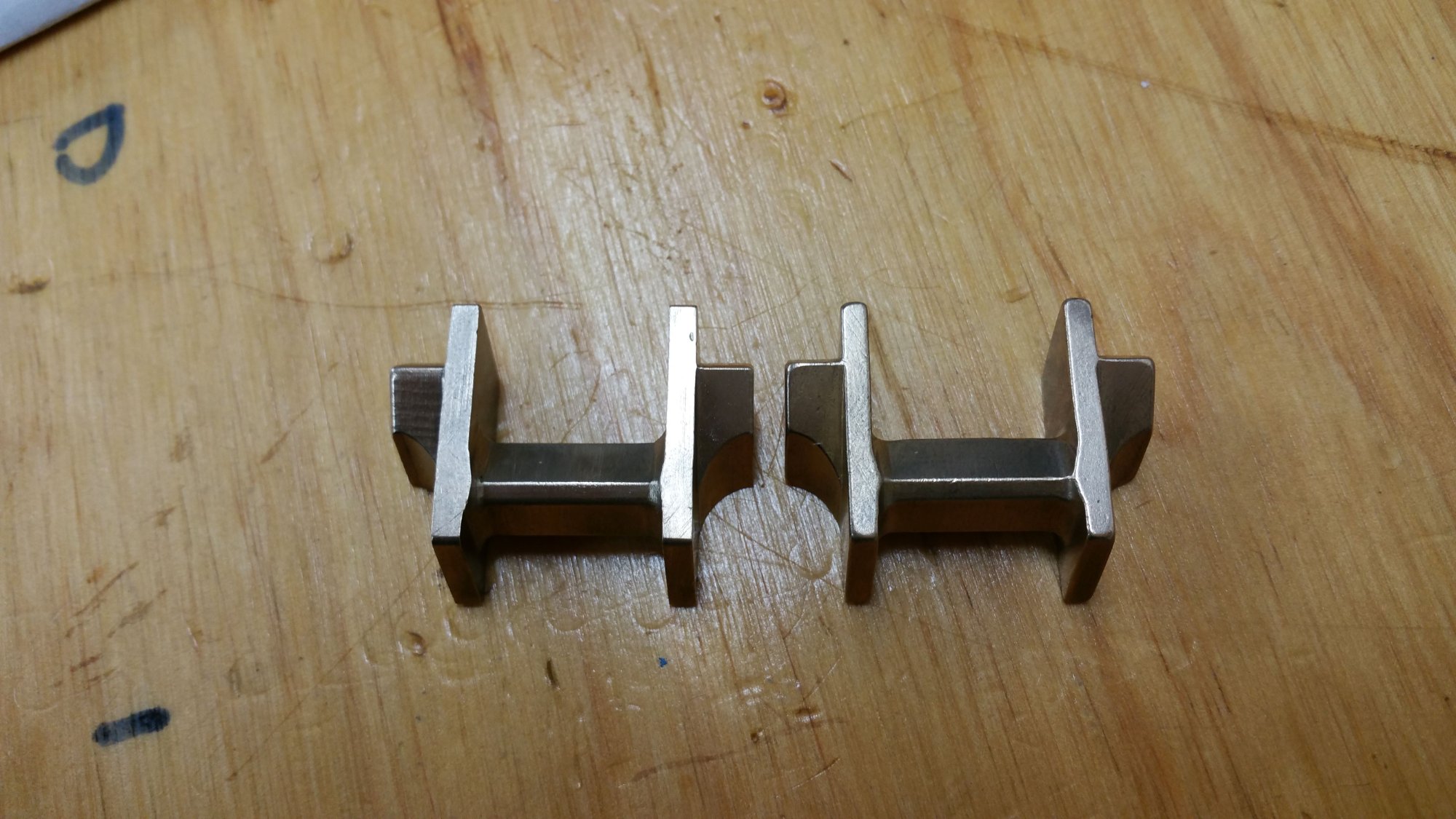

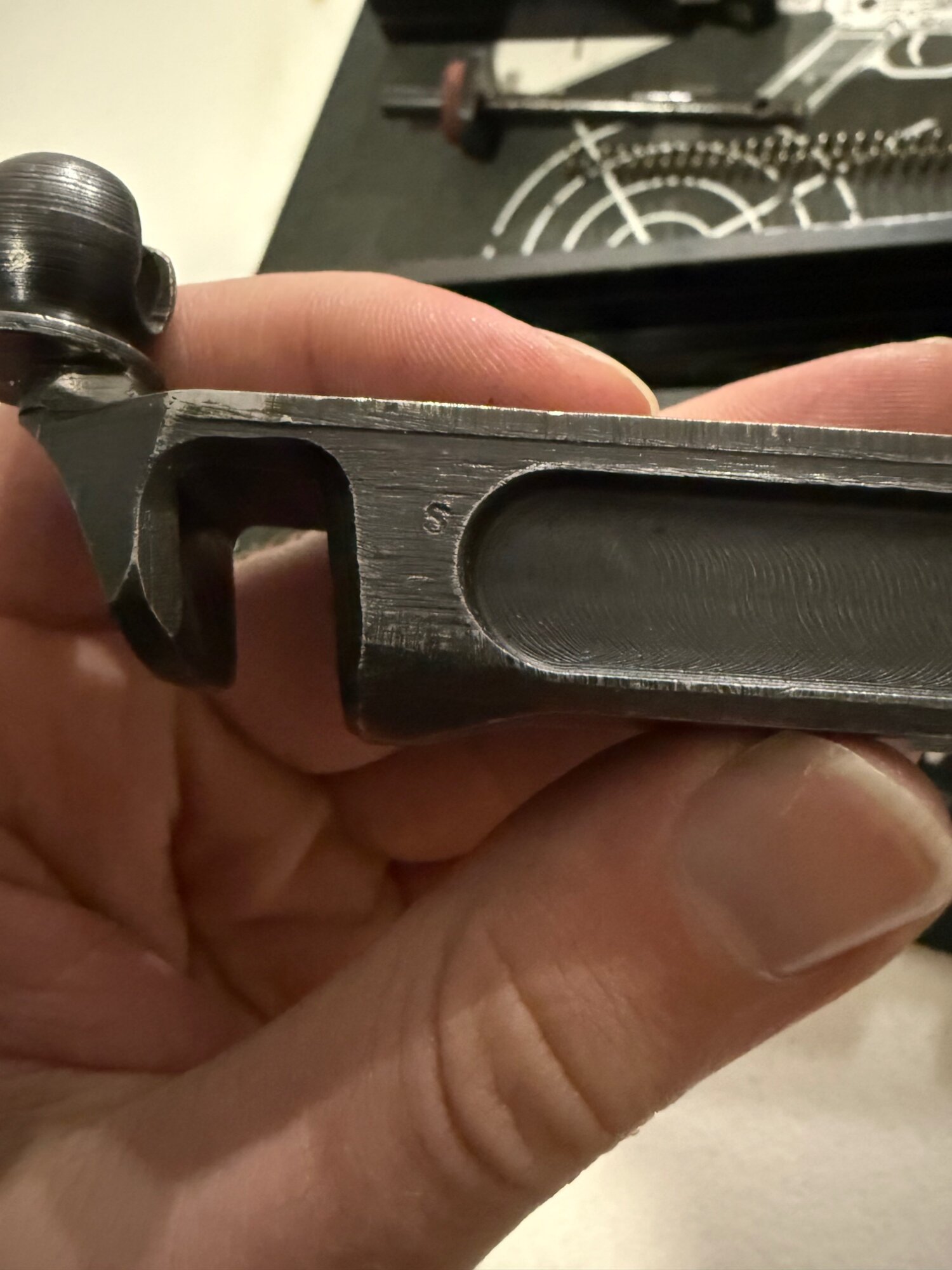

TD. Posted May 5 Report Share Posted May 5 Show below is an example of PK's work involving the replacement of the Blish lock slots on my West Hurley Thompson. These "new" locks have survived a number of C drum dumps over the years. I was at a private machine gun shoot last week and someone ask me if I had any Thompson magazines. I told them only these round ones pointing to my two C drums on the table. I would like to know if John Andrewski does this or something like this with the slots. I would not be afraid to purchase another West Hurley if PK. had an apprentice working with him. Link to comment Share on other sites More sharing options...

villafuego Posted May 7 Report Share Posted May 7 (edited) On 5/5/2026 at 12:24 PM, Bridgeport28A1 said: Interesting comment from PK on March 10, 2020 in the thread about the gouges. I still want to see a photo of the hammer pin pads. They are pictured in TD's post above yours ...... I circled in yellow Edited May 7 by villafuego Link to comment Share on other sites More sharing options...
Bridgeport28A1 Posted May 7 Report Share Posted May 7 7 minutes ago, villafuego said: They are pictured in TD's post above yours ...... I circled in yellow Thank you Link to comment Share on other sites More sharing options...

Doug Quaid Posted May 10 Report Share Posted May 10 (edited) On 5/5/2026 at 9:10 AM, TD. said: Doug Quaid, Over the years I have seen some Blish locks not fit in some guns. Manufacturing tolerances? I don't think it is a manufacturing tolerance. AOC locks are much larger. And they are more squared off. They won't even come close to fitting in my Savage. Edited May 10 by Doug Quaid Link to comment Share on other sites More sharing options...
TD. Posted May 10 Report Share Posted May 10 Just a guess: I am thinking there may be a final manufacturing process that rounds off all the sharp edges on the Blish lock. Would "tumbling" or the lack thereof apply to this squared off AOC marked Blish lock? Link to comment Share on other sites More sharing options...
Doug Quaid Posted May 10 Report Share Posted May 10 (edited) 55 minutes ago, TD. said: Just a guess: I am thinking there may be a final manufacturing process that rounds off all the sharp edges on the Blish lock. Would "tumbling" or the lack thereof apply to this squared off AOC marked Blish lock? That's not a bad guess at all. Maybe AOC saw that rounding off the edges of the blish lock was an unneeded extra step, so they just left them squared off and made the slots in the receiver slightly larger. My 1928 is a pretty early gun, ser. # 17,XXX. And that AOC lock absolutely would not fit at all. But the savage one fits perfectly. This topic could probably use its own thread. We need someone with an AOC to check the fit of a savage blish lock. Edited May 10 by Doug Quaid Link to comment Share on other sites More sharing options...
gijive Posted May 10 Report Share Posted May 10 All, I have owned three (3) Colt made Thompson Submachine Guns in my lifetime. All three were obviously made before Savage and AOC started making Blish locks for their guns at the outbreak of WWII. I have used Savage and AOC Blish locks in all of my Colt guns for shooting purposes and have never had a problem. I had mostly Savage Blish locks, but had about three AOC marked ones. All of them fit and functioned as they were supposed to. If an AOC Blish Lock doesn't fit in a Savage gun, I would think it had something to do with the aforementioned manufacturing tolerances. Link to comment Share on other sites More sharing options...
