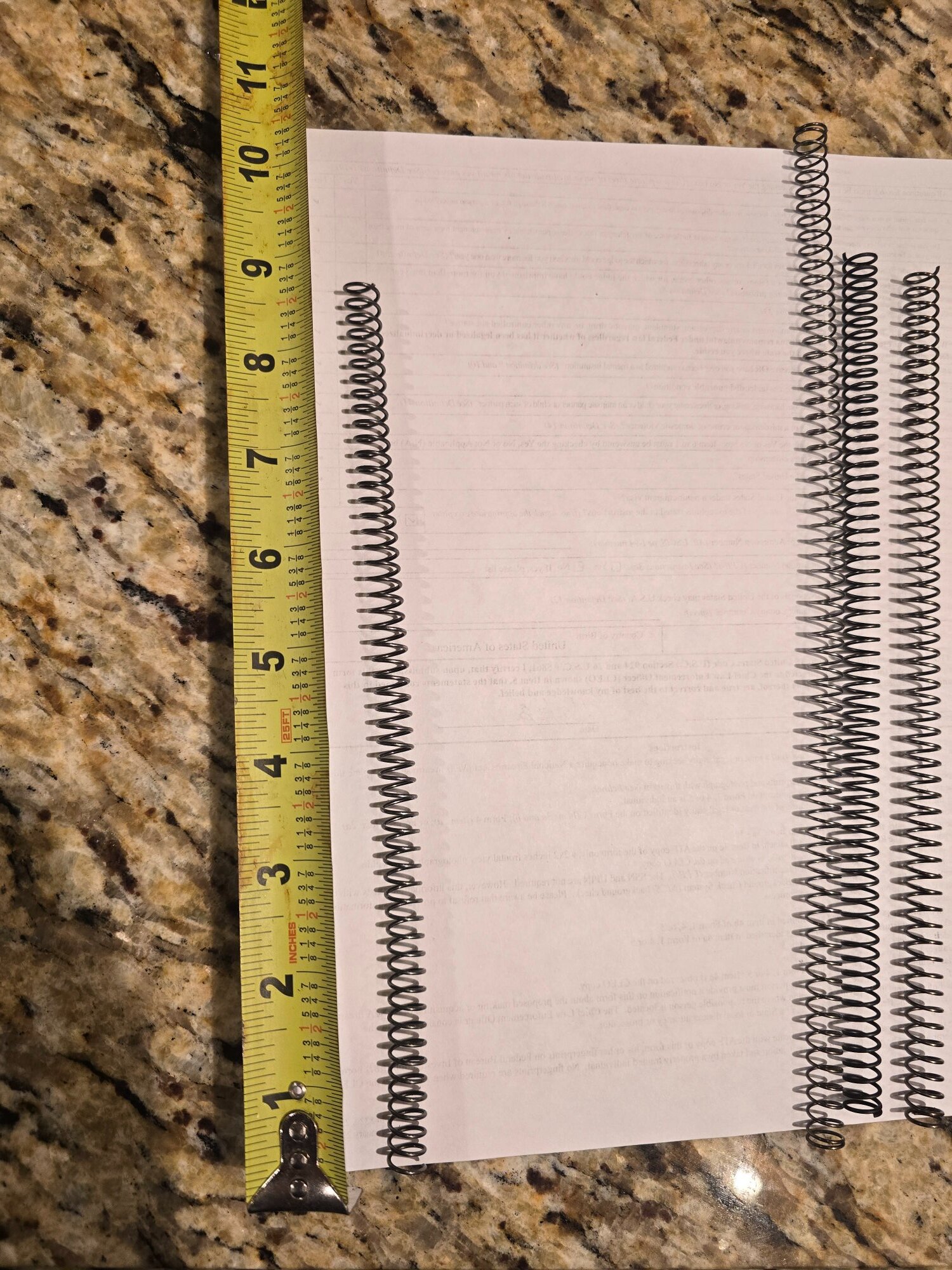

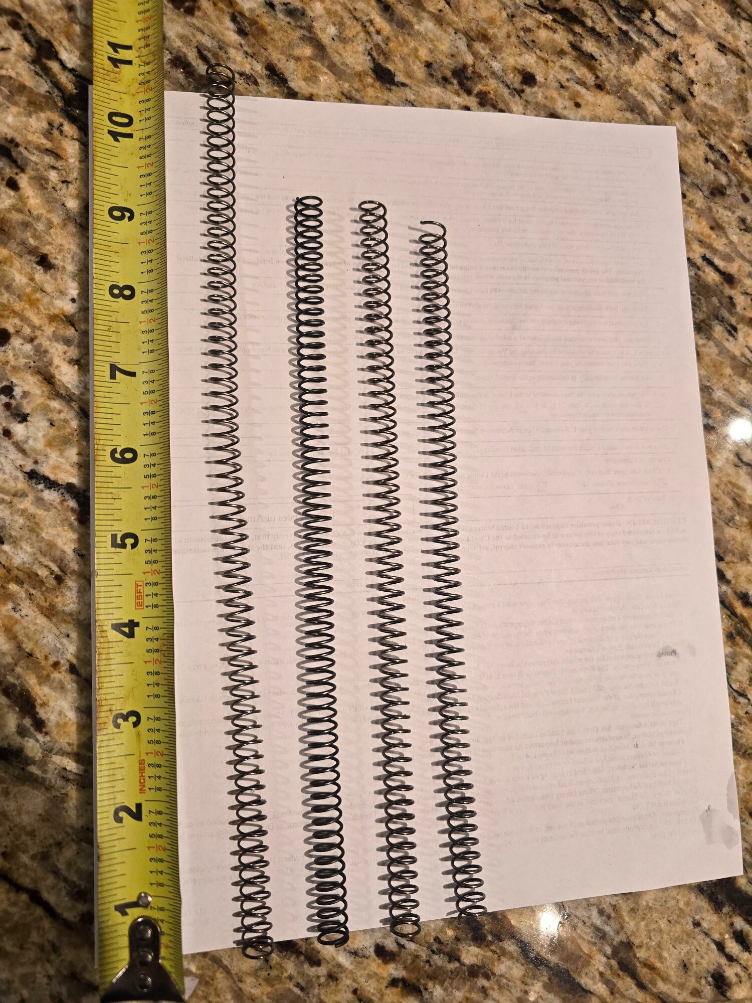

Finally made it to my .22 kit. Sorry for the lag time.
In measuring my smallest spring ( cut down from stock recoil spring) it measures right at 9".  My other 2  cut down springs are one or 2 coils longer.  The 9" spring really slows things down on the 28.  Not Grease Gun slow but I'm guessing 600 or so.   Ideal if u ask me. The other springs definitely increase the cyclic rate.  Doesn't take much .
Ammo will also be a variable. Federal Bulk is/ was my choice.  Suppressed with any Standard Velocity ammo it is nearly Hollywood quiet and retains the slower cyclic rate.    Of the many FA .22 conversions, over many platforms, this is by far the slowest combination.  The new S&W 76 .22 kit is still a tad faster in the limited time I've been able to shoot it.
I have a 4th spring that I believe Merle sent me. It is 11"  and appears to be a lighter wire.   All 4 springs are very reliable in my kit.  I don't believe I cut a spring down any more than the 9" as I was satisfied with that.
Good luck on your kit and experiment as YMMV.
