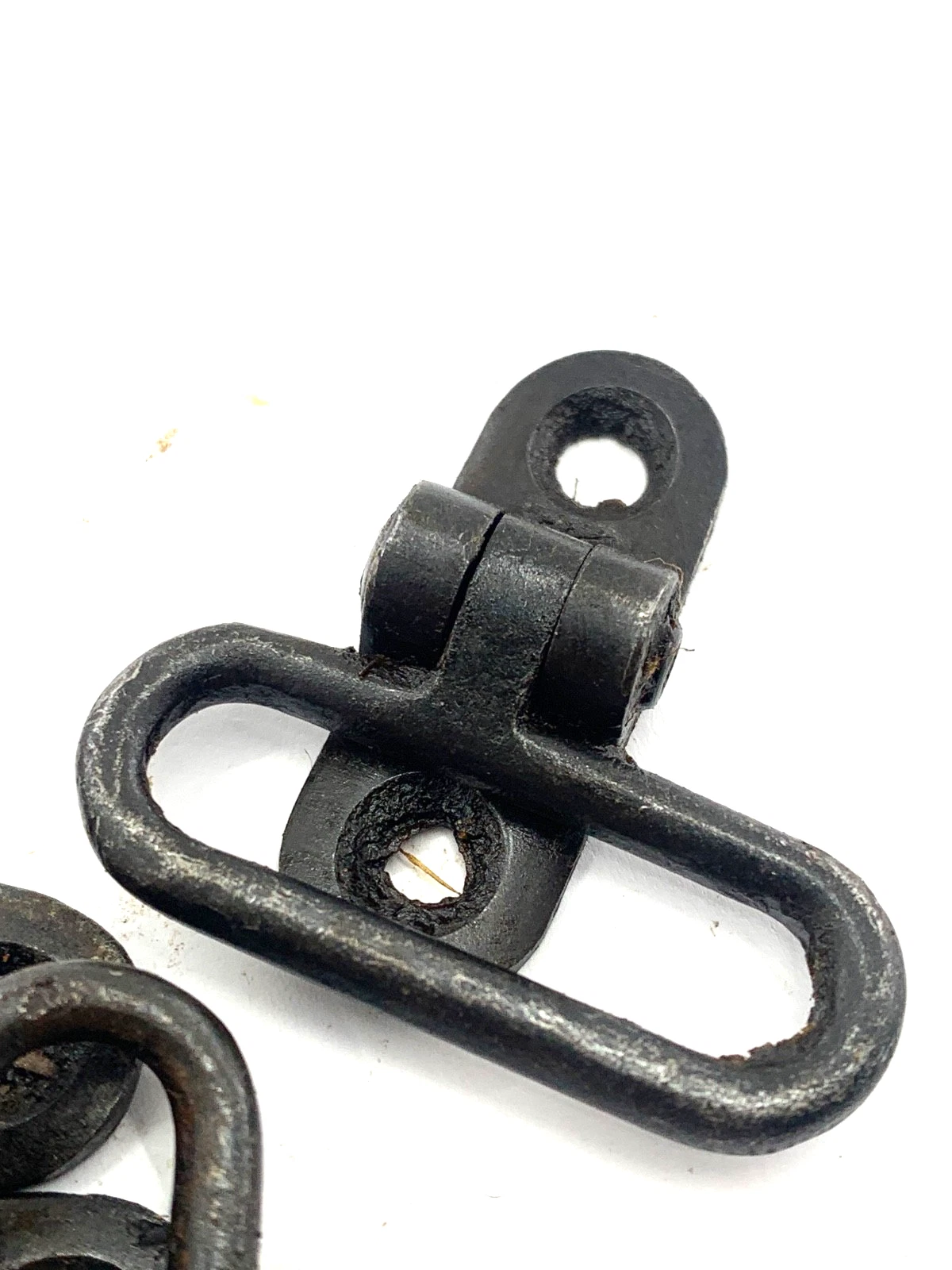

anjong-ni Posted July 16 Report Share Posted July 16 (edited) https://www.ebay.com/itm/397270972823?mkevt=1&mkcid=1&mkrid=711-53200-19255-0&campid=5339137922&toolid=20006&customid=1e600fa68d271277be3165ffe9b28ac2|null|null&gclid=1e600fa68d271277be3165ffe9b28ac2&loc_interest_ms=44813 "US M1917" swivels? Are they different from British Enfield swivels? ...Phil Edited July 16 by anjong-ni Link to comment Share on other sites More sharing options...
