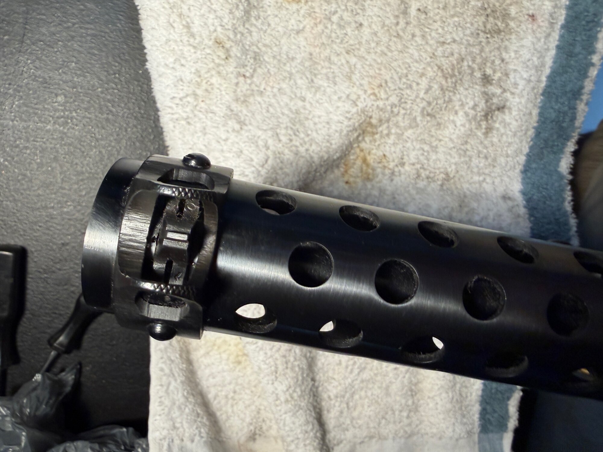

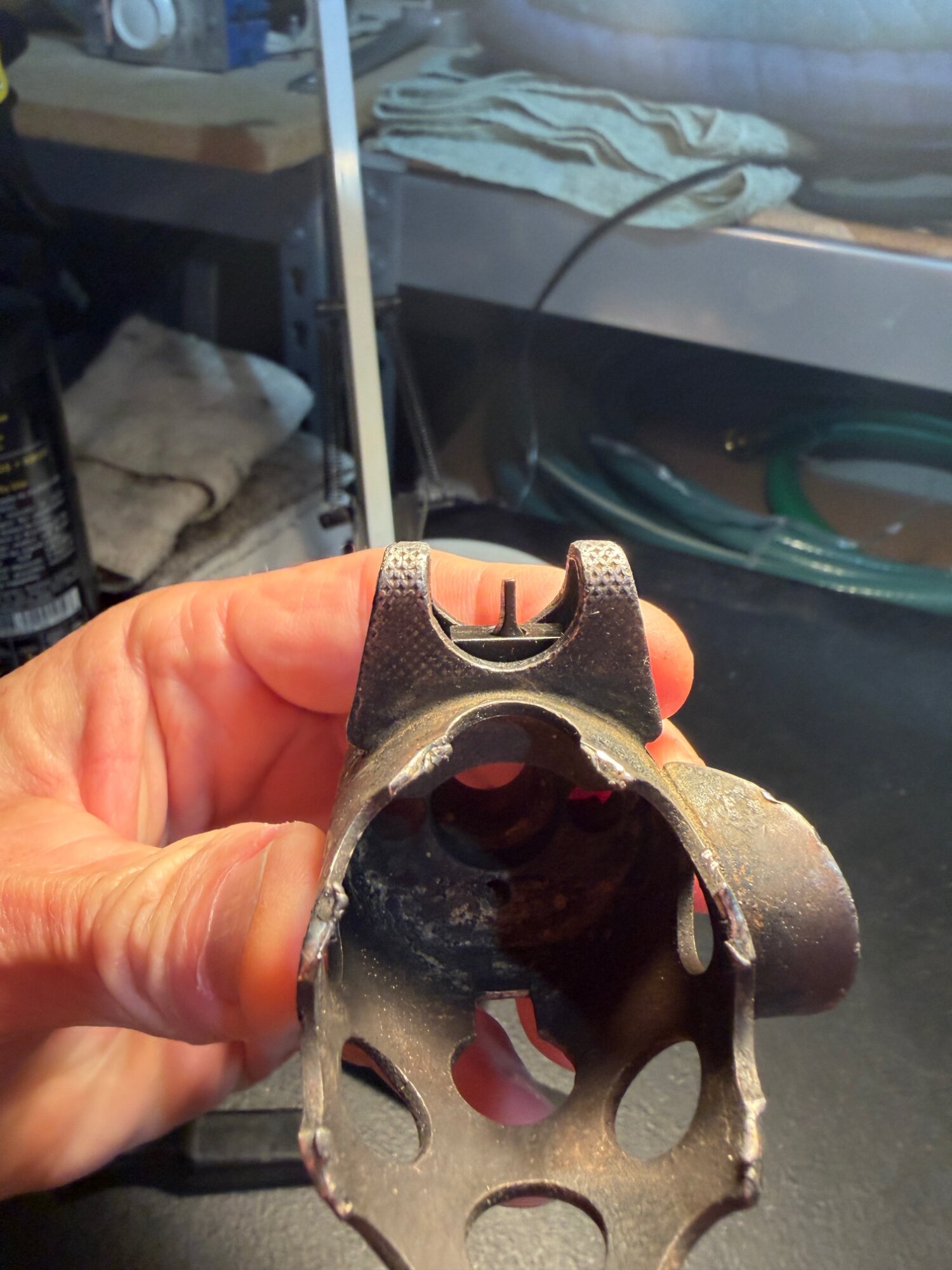

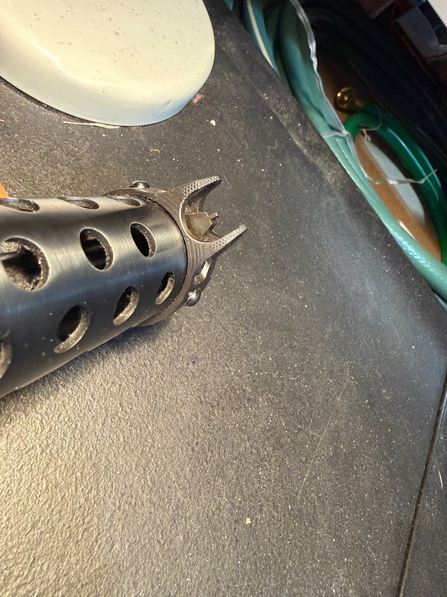

Rekraps Posted July 23 Report Share Posted July 23 I'll measure mine when I get home. I have both an Andrewski DLO build and a spare parts kit. Link to comment Share on other sites More sharing options...
Rekraps Posted July 23 Report Share Posted July 23 And I have an original OEM sight adjustment tool for the Sterling. Link to comment Share on other sites More sharing options...

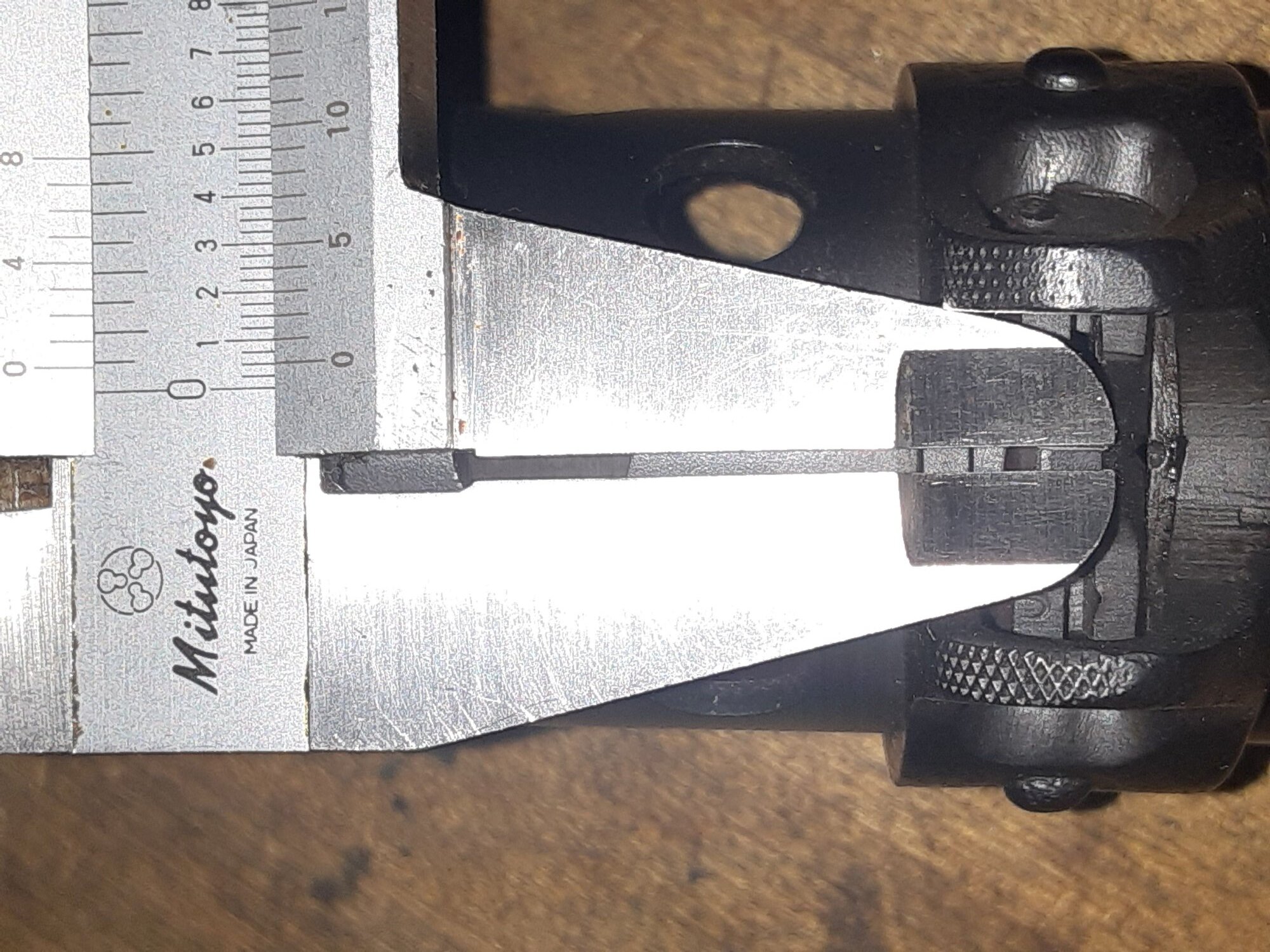

Rekraps Posted July 27 Report Share Posted July 27 On 7/22/2026 at 5:07 PM, StrangeRanger said: Somebody?? I'm looking at the feasibility of replacing the front sight on my Lanchester with one but I need to know if it's wider than .050" to be worth the expense 1.5mm thick, 4mm wide. Link to comment Share on other sites More sharing options...
Rekraps Posted July 28 Report Share Posted July 28 Just now, Rekraps said: 1.5mm thick, 4mm wide. Link to comment Share on other sites More sharing options...

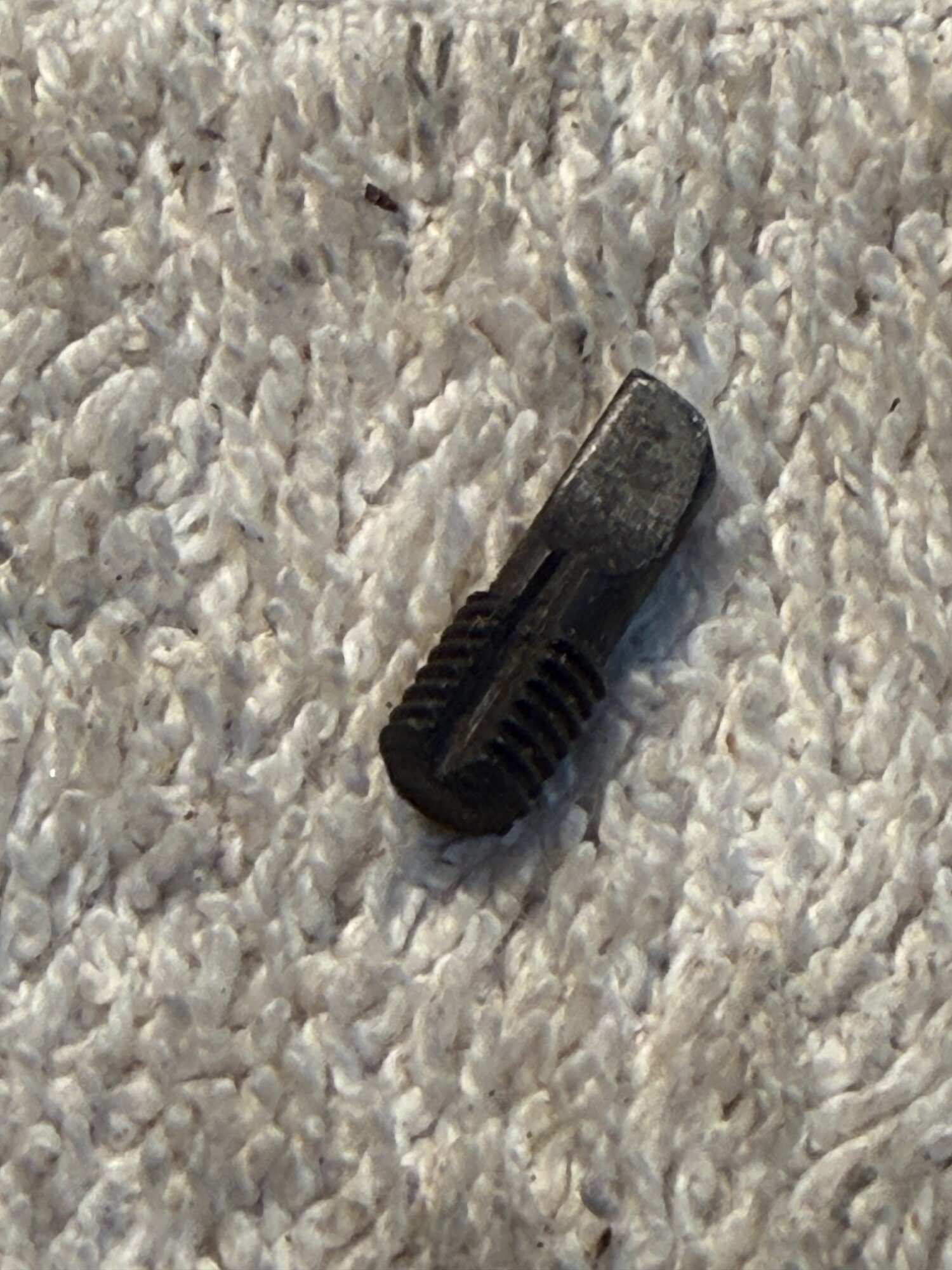

Rekraps Posted July 28 Report Share Posted July 28 Held into the base with a 1.5mm hex nut that fits into the threaded base slot. Link to comment Share on other sites More sharing options...

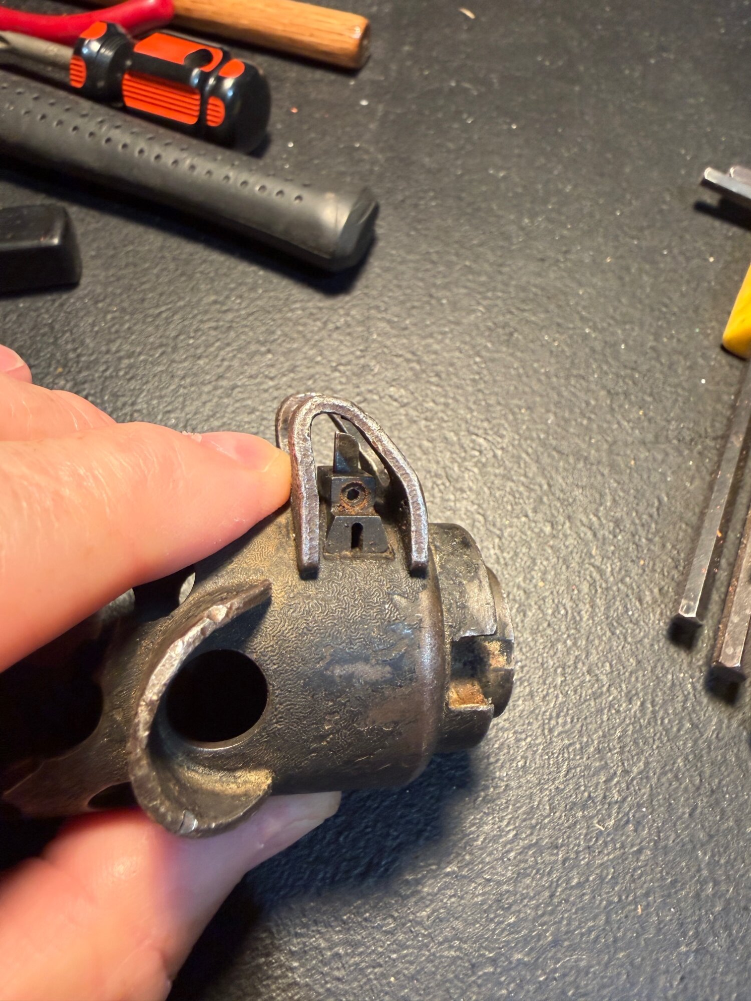

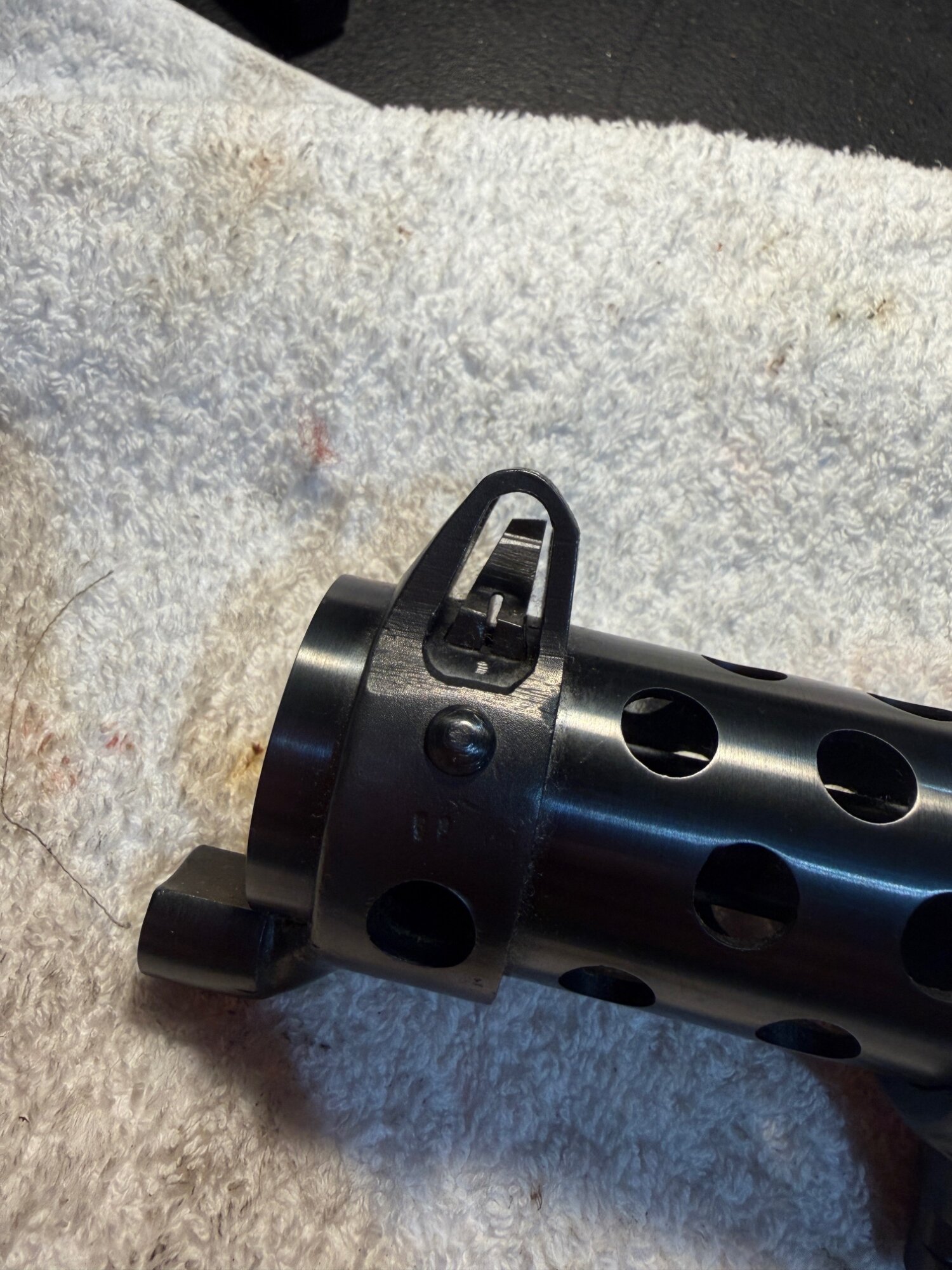

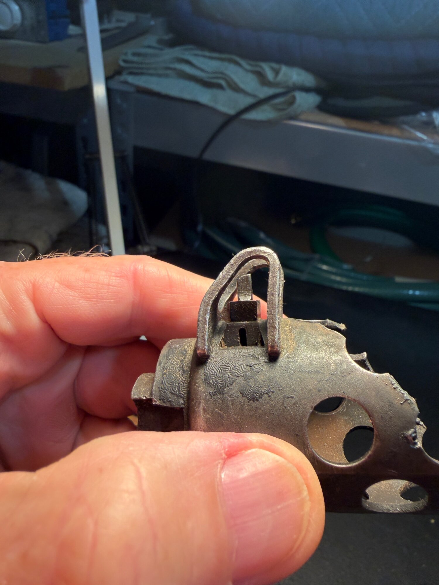

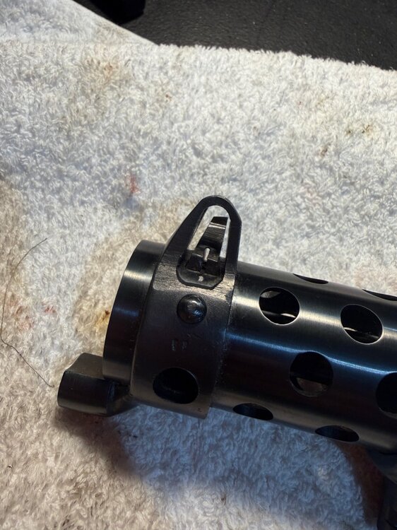

Rekraps Posted July 28 Report Share Posted July 28 On 7/22/2026 at 5:07 PM, StrangeRanger said: Somebody?? I'm looking at the feasibility of replacing the front sight on my Lanchester with one but I need to know if it's wider than .050" to be worth the expense Whole different animal. The Lanchester front sight is a single beveled piece that fits into a bevel milked into the barrel shroud. Not sure how to measure it. Front to back at base 7mm. Height 5mm. Width 21mm, front to back at top 4.5mm 1 Link to comment Share on other sites More sharing options...
Rekraps Posted July 28 Report Share Posted July 28 Width of sight blade at top is 1mm. 1 Link to comment Share on other sites More sharing options...
StrangeRanger Posted July 28 Author Report Share Posted July 28 Thank you Peter Laidler says that Lanchester sight was used on the L2A2 and they are interchangeable with the L2A3/Mk4 sight. the retrofit was often done in the field Interesting that your Lanchester sight is 1mm/.039" wide, mine is 1.3mm/.052". I'm not at all sure that the available increase to 1.5mm/.059" is worth the doing Link to comment Share on other sites More sharing options...

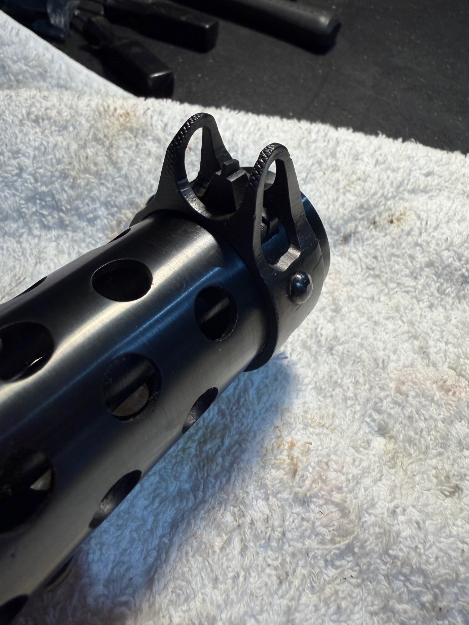

Rekraps Posted July 28 Report Share Posted July 28 Both of the L2A3 sight fixtures I have (one you see pictured and on on my DLO/Andrewski gun) use Sterling parts. I suppose you could use a Lanchester sight fixture and it'd work, but there is no provision for the Lanchester front sight to be moved up or down, just right and left whereas the Sterling sight does both. Link to comment Share on other sites More sharing options...
StrangeRanger Posted July 28 Author Report Share Posted July 28 Adjustability is the whole point of it. For the L2A2 Sterling furnished a set of 7 Lanchester-compatible foresights with tips of varying heights with each gun. They were to be used to zero the gun. For the L2A3/Mk4 they went to the adjustable blade. The base/cross-slide is dimensionally the same for all 3 guns. If the blade on the Mk4 foresight were .075-.090" wide I would be changing to one but at .058" I don't see much reason to do so. ' Link to comment Share on other sites More sharing options...
