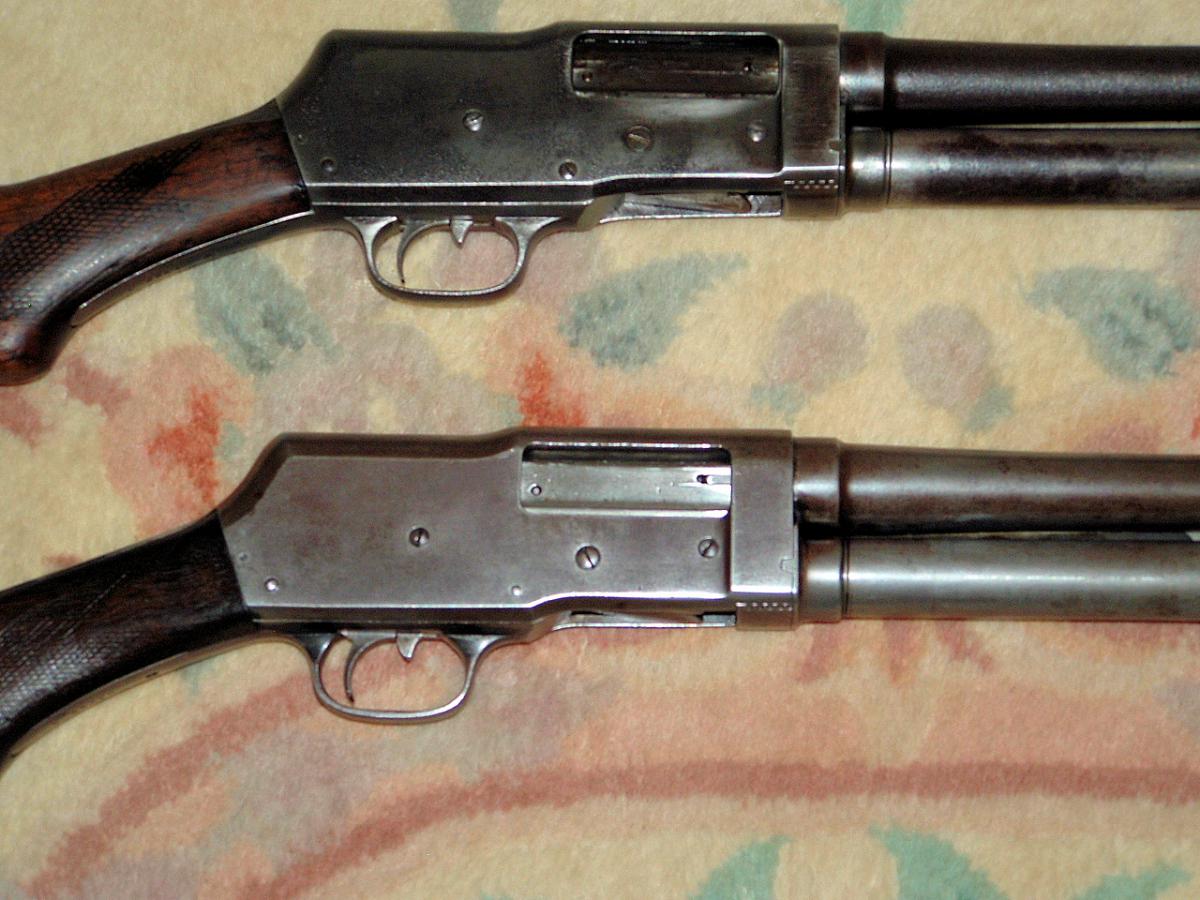

snoopy2u Posted November 4, 2014 Share Posted November 4, 2014 I am new to this forum, hope I do this correctly! In searching links and info on my Stevens 520 - I ran into your site showing numberous Stevens 520's, and 620 shotguns. I am hoping to connect with one of these members whom can assist me. Though, my 520's have long barrels, and certainly can not be termed "trench guns", they nonetheless function the same and have the same internals. I have not fired a live round from my Stevens as yet, but - I have played with it enough at this point to beleive that it would operate fine under battery. with one exception - the cartridge stop lever. It is my belief that a cartridge stop would hold the next round in the tube, until the fired round was ejected, and the action brought forward to load the next round. That this cartridge stop would hold this next round via small lips on the upper and lower portion of the stop. This does not happen on my 520's. When I load my magazine, the rounds protrude from the tube about 1/4 inch and rests on the lifter. I can still action, load, and eject a full magazine without problem, but - is not the cartridge stop intended to hold this next round in the tube until ready? The stop has a bump towards the rear of the stop, so that when the breech/ bolt moves rearward, the bolt rides on this bump thus piviting it upward. There is also a screw in the receiver towards the front of the stop, and the stop has a bevel cut in the back of the stop, so that when the bolt rides the rear stop bump, and the stop pivits upward, it hits this screw head, and moves outward a small bit. Then the bolt is actioned forward to pick up the next round, and the stop returns downward, back against the receiver's inside wall. I see this happening as i play with the action - but, no where do I see the stop holding a round in the tube. Nor, do I understand which edge of the stop is susposed to hold to round in the tube. and, of course, How the stop's piviting is susposed to function in relation to the stop's ability to retain a round in the tube and guide a round into the breech area. Does anyone understand what I explained? Given that these shotguns or old, and parts are worn, one of my 520's has a cartridge stop that appears to be well defined, sharp and should function. The other shotgun's stop is well worn - and I could swap it out with a better one, but - i'd expect that it would not operate any differently. rounds would still rest on the lifter. Can one of you more knowledgeable members help me out here. And, explain the proper operation of the cartridge stop, how to fix mine, and what to look for in repairing my rifles. Note this cartridge stop's definition and clarity. I presume that this stop is in sufficient shape to function correctly. Breech is towards the rear of the receiver, the stop has pivited upward on the receiver's stop screw, and the stop has moved outward from the receiver. If the bolt was brought forward, the stop would pivit downward, off the stop screw and rest closer to the inside of the receiver. Link to comment Share on other sites More sharing options...

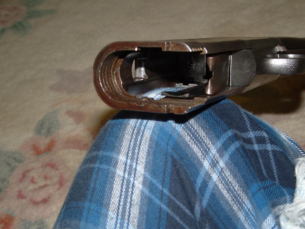

snoopy2u Posted November 8, 2014 Author Share Posted November 8, 2014 Chris - Just tried loading both my Westernfield and Riverside 520's. With the both forward and closed, the rounds rest about 1/4 inch outside the tube, on the lifter as you described. This was the correct operation and design feature as you stated earlier. with the bolt to the rear, the lifter is up against the bolt, but - the bolt has now, in its return rearward, operated the back of the cartridge stops "hump" and has pivited the cartridge stop up, and on the forward receiver screw behind the cartridge stop, pushing out the cartridge stop from the inside of the receiver. This appears to be the correct timeing of the bolt and cartridge stop. Now - since the cartridge stop has been pivioted up and outward from the receiver, the rounds had to be pushed hard past the leading edges of the cartridge stop. Once the rounds were clear of the +cartridge stop, into the tube, YES - the cartridge stop did in fact retain every round inside the tube. From there, the timeing was slightly different on each of my shotguns. On one ,I had to bring the lifter down before pulling the bolt closed. The Western field operated better, in that bringing the bolt closed, the cartridge stop pivited downward, off the receiver screw, and back against the inside receiver wall. When this happened, the semi-circular cut in the cartridge stop allowed the round in the tube to feed. the lifter quickly dropsped during this bolt closing process, allowing the need round to pass by the semi-circular cut in the cartridge stop, and rest on the lifter's forward edge, as you describe. This loading was easiest done with the muzzle on the ground ( not your foot). I have seen multiple variations of these internals, even for the 520's. While playing with my Stevens 620, I found that the trigger spring is different than on my 520's, trigger was different, bolt appeared more rounded, safety was still inside the trigger housing, and the cartridge stop was the same as my 520's, and operated the same. However - many cartridge stops for the 620 are shown as a long flat peice, with a square hump. And since i do not have a 620 with the safety on the upper rear of the receiver - i do not know if the cartridge stop on these newer models operated the same as the apparent older models that i have. do you know of anyone else with one of these shotguns, or does someone have a copy of a Tm9-2117 that might explain how these things were designed to work. Link to comment Share on other sites More sharing options...
emmagee1917 Posted November 10, 2014 Share Posted November 10, 2014 I did not tear down the gun to see what part did it , but there must be a means to hold the round fully in the tube to allow the lifter to move up/down when cycling. Also , when lifting the round up for feeding , the round being fed has to move from " part tube " to " all on lifter " to be lifted and the next round must be held " all in tube " to allow the lifter to lift and to keep the rest of the tube's rounds in the gun. I would guess that there is two hooks on the cartrige stop and it pivots in an arc during the feeding cycle so it takes turns holding and releasing the round. First on the forward ( in tube ) hook , the the rear ( half tube / half lifter ) hook , then onto the lifter fully ( released from rear hook , but front hook now stops the next round inside tube ) .Chris Link to comment Share on other sites More sharing options...
