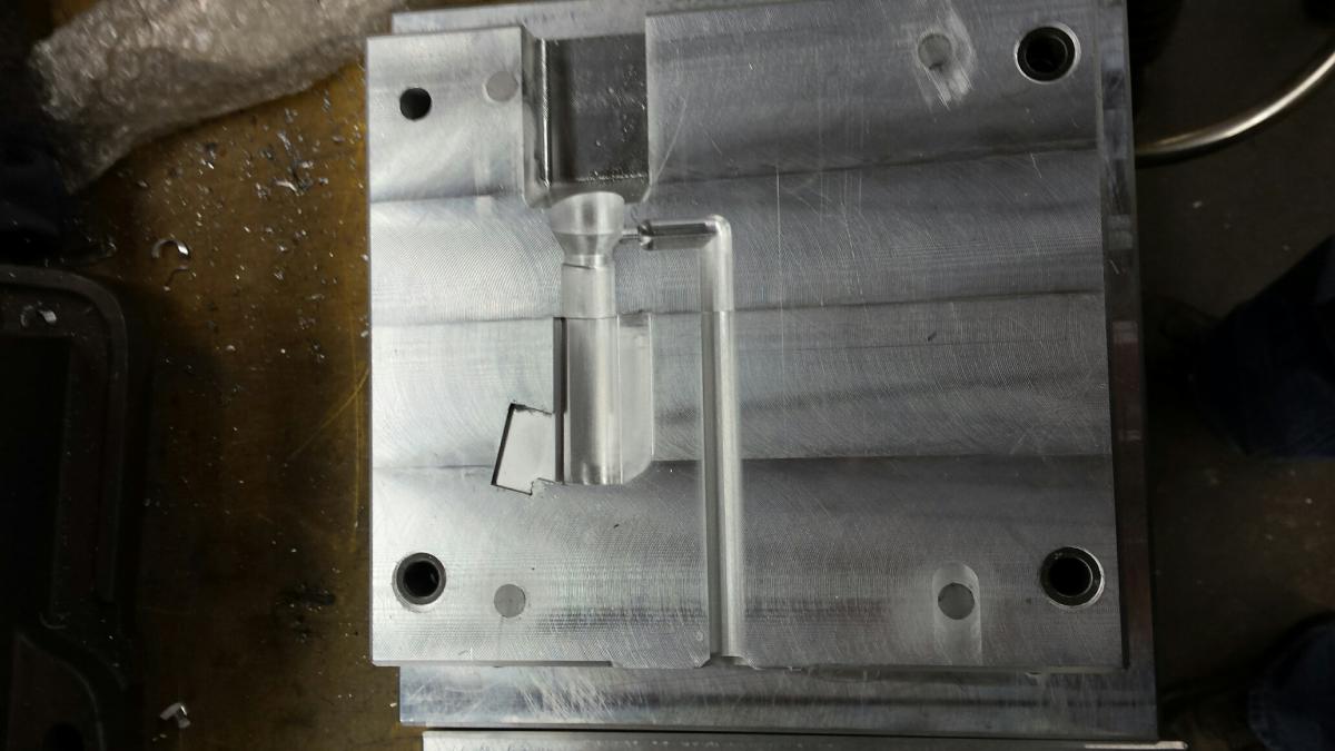

GUNGUY45 Posted November 21, 2014 Report Share Posted November 21, 2014 (edited) Paladin, If you have a solid model, and the correct software, and know how to use it, it's not that bad.If you have to create the model, it's a bit more work.Don't forget the shrink values of the "investment material"(wax), and of the metal to be poured.Other than that it's a piece of cake... Also remember any holes in the casting need to be cored, and the cores must draw out. The attached photos are of a revolver barrel die.as you can see it is being cast with no hole through it, they get a better quality casting this way, it's also difficult to build a ceramic shell in a long small dia hole. You can make the die on a 3D printer, but the plastic materials don't conduct heat well. Edited November 21, 2014 by GUNGUY45 Link to comment Share on other sites More sharing options...
