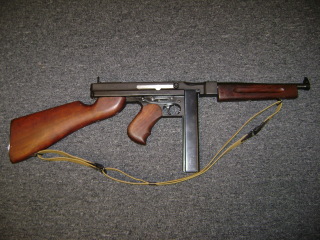

I went the other way, making my WH M1 "true military", with all GI M1 parts from a matching parts kit, including milled grip mount and swivels, paddle style pivot and safety, "L" rear sight, no crossbolt stock, M1928A1 magazine latch, and "bright" bolt. The blued finish replicates the original. Photos below. Please forgive if you've seen them before.
It had mostly GI internals with a few reproduction cast items. The original bolt was a close copy of the M1A1 bolt, but was not GI, and was too long. PK (who did the work in the photos below) recommended replacing this with GI, even if other WH parts are retained. In went a new condition original M1 "bright" bolt, the kind with the separate hammer, pin, spring, and firing pin. PK brought the gun into spec and completed the milling operations omitted by WH.

There's been much debate on these boards as to whether or not the M1 bolt is inherently safer than the M1A1 bolt since the M1 bolt's firing pin firing pin is retracted until the bolt is very nearly in battery. Since no one seems to be having problems with premature ignition with TSMGs equipped with M1A1 bolts, I'd say that the question is largely moot.

PK does great work, I went the M1A1 route since I have a very early 4 digit Bridgeport M1 in blu.
What a stout gun.
PK did the work:
