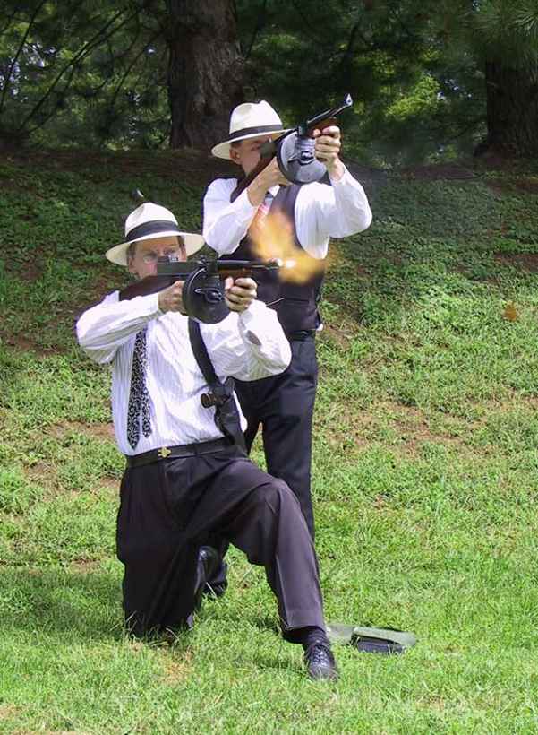

Reenactor Posted January 9, 2013 Report Share Posted January 9, 2013 Twenty years ago, it was like pulling teeth to find out about blank adapting Thompsons. Now, collecting ideas on blanks is similar to belly buttons--everybody has one, and everybody is very attached to their own. And, generally speaking, everybody's works for them. Except for a few short deviations trying other blanks (way dirtier than Joe's or shaped differently and so had feeding problems) I have used Joe Swanson's exclusively for 21 years. My 1921A and 1921AC have both been rebarrelled, for use with the allen screw technique. I didn't de-temper the screws, as they resist burnout and last longer in their original form, but it does take a number of carbide-tipped drill bits to put the gas holes in them. I used about 2 bits per each 5 allen screws drilled. Probably 20 plugs with various orifice sizes were initially prepared, doubling and tripling up on the sizes best suited to my guns, in order to have spares for eventual replacement. With a variety of hole sizes at your disposal, choosing the right one for your particular gun/bolt/recoil spring combination allows you to tune the recoil cycling to within acceptable parameters. The bolt stops every time you release the trigger, but still doesn't travel completely to the back of the receiver at full recoil. One of mine works best with a 13/64 hole, and the other with a 14/64. For a while I used a JC Earl insert for my AC, but found the allen screw technique to be easier overall, and also applicable to the non-compensated gun. Thousands of rounds and 60-80 reenactments later, my experience and that of others within my 30's group has left us still very happy with Joe's product. We order in fairly large quantities, so as not to pester Joe, who supplies movies, with small orders. I do not know if he has a minimum order size, but we try to be courteous and remember that he makes his living doing this, and we are just hobbyists. 1 Link to comment Share on other sites More sharing options...
