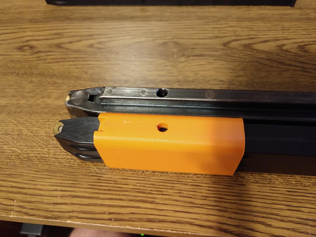

DougStump Posted August 20, 2020 Report Share Posted August 20, 2020 The photos of the Promag show two witness holes on both sides. If I put corresponding pins inside the sleeve to match, I wonder if they will provide sufficient retention. The pins can't be very long, can't have them interfere with the follower. I love a challenge! Link to comment Share on other sites More sharing options...

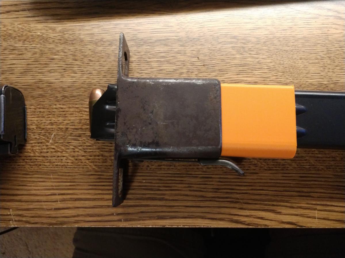

GarrettJ Posted August 22, 2020 Author Report Share Posted August 22, 2020 ...what I envision is a sleeve that fits on the Promag with the notch on the back for the original mag catch. No modification to the Reising or changing parts, just pop in either an original 20 round mag or a sleeved Promag.That's exactly what I had in mind. Or it looks like for those who only have a Reising, it would be easiest to just make permanent mods to the Uzi mags. So I was playing around this morning and tried cobbling something together just for a proof-of-concept. I think we're on to something here. I just used a wood spacer in the back with a hole drilled for the catch, and then used some cardboard to increase the mag width (the Reising mag is approximately .150" wider than the Uzi mag). I then went really high-tech and wrapped it all together using packing tape. Video link below. I ran the mag four times. The one malfunction in the first run was the only failure I had. Link to comment Share on other sites More sharing options...

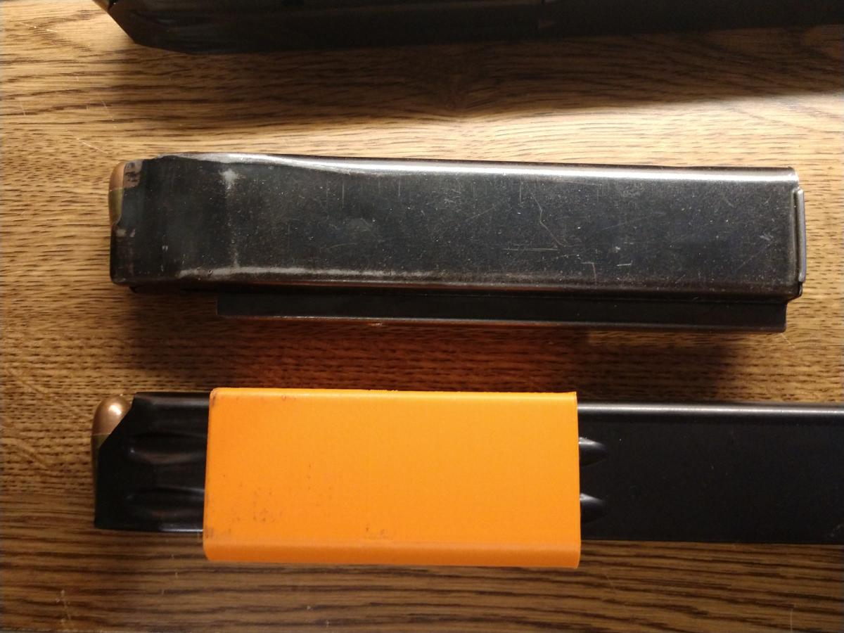

DougStump Posted August 23, 2020 Report Share Posted August 23, 2020 I think our chances of success just went up, although I'm married & not allowed to think. With two pieces of card stock on both sides, how much play do you have side to side? I'm guessing the card stock is around .020" thick? So that is .040" on each side. I will have to have the front of the sleeve about as thick as the sides. Moving the Promag back .040" shouldn't cause problems???? I think the sleeve would be much stronger if it was a full "O" cross section instead of a "C". I wonder how uniform are the different 20 round mag housings out there. We don't want the fit either too sloppy or too tight. What about making the sleeve OD slightly small on purpose, then have ribs (one or two in the front and two on each side) deliberately oversize that could be user sanded down for a perfect fit? Sanding a couple of ribs would be a lot easier than sanding the whole side of the sleeve. Packing tape? How dare you! Duct tape or go home! Unfortunately, I got interested in 3d printing after my Dad passed away. He would have gone nuts over the technology, things that would normally be time consuming or impossible to create are now simple. One example I use is: "Your assignment is to make a one inch perfectly square cube. It must be made in one piece, no seams or joints are permitted. Inside the cube must be a 1/2" spherical cavity. No holes can be cut into the cube." Impossible with conventional machining, but I've done it with 3d printing. Link to comment Share on other sites More sharing options...
GarrettJ Posted August 24, 2020 Author Report Share Posted August 24, 2020 I think our chances of success just went up, although I'm married & not allowed to think. With two pieces of card stock on both sides, how much play do you have side to side? I'm guessing the card stock is around .020" thick? So that is .040" on each side. I will have to have the front of the sleeve about as thick as the sides. Moving the Promag back .040" shouldn't cause problems???? I think the sleeve would be much stronger if it was a full "O" cross section instead of a "C". It's actually pretty tight the way I have it. I did 2-ply card stock on one side and 4-ply on the other. (one piece folded over and 2 pieces each folded over). 2-ply is .052" thick. So rough numbers, .150" plus maybe another .015" for the tape, giving around .165" additional width to the mag, or roughly .083" added width per side. For a sanity check, my Uzi mag measures anywhere from .816" to .822" where it would go up into the Reising magwell. An original H&R 20-round mag measures anywhere from .955" to .979" in the magwell area. My magwell width varies from .100" to .110". I only have the one magwell to measure. And I've only taken measurements from one H&R mag and one Uzi mag. I have more of both types of mags if we need to validate measurements. With the sides being only .083" thick, do you think you can find a material that is strong enough for this application? I'm imagining a flexible tab at the bottom of the sleeve that would extend down and engage the Uzi mag notch. This would be below the Reising magwell, so could be made thicker to make it more durable. The back of the sleeve would be quite a bit more thick. The wood block I used is .330" thick. I suspect the Reising mag catch would wear the catch in the plastic pretty quickly though, resulting in the mag sitting too low. Would it be possible to incorporate a metal plate with a hole for the mag catch? I'm thinking the sleeve could it could be printed onto/around it. Maybe the same for where the sleeve engages the Uzi mag catch. I like your thought about adding ribs to custom fit the sleeve to the individual gun. I suspect we could actually have a fair amount of slop without causing reliability issues. But I agree it would be easier to start tight and sand to fit. Link to comment Share on other sites More sharing options...

DougStump Posted September 5, 2020 Report Share Posted September 5, 2020 Okay, no video (my camera man got his "on" and "off" backwards), but... I fired three ten round bursts from both test magazines with >>NO<< jams! She purred like a kitten! I do believe that we're on to something here! Link to comment Share on other sites More sharing options...
GarrettJ Posted September 5, 2020 Author Report Share Posted September 5, 2020 Thats excellent! Any chance you can post a picture? Let me know if you want some beta testing with another gun & mags. I have 6 or 7 of the promags, plus a handful of IMI mags, which would be interesting to try as well. Did you just use the plastic material at the mag catch? Does it look like its going to hold up under repeated use, or do you think it will need to be reinforced? Link to comment Share on other sites More sharing options...
DougStump Posted September 6, 2020 Report Share Posted September 6, 2020 As these were just a test, I used the color filament that was in the printer. Production sleeves will by black. I made a generous bevel on the top so it slides easily under the magazine catch, they go in much easier than an original mag. Reinforcing the mag catch hole with metal would be pretty difficult. We'll have to see how they hold up, but when they wear out just replace the sleeve. Link to comment Share on other sites More sharing options...
DougStump Posted September 6, 2020 Report Share Posted September 6, 2020 Garrettj, PM me your address and I'll send you a couple of sleeves to try. How close are the dimensions between the Promag and original UZI mags? These sleeves fit pretty tight on the Promag, removable but the mag ain't gonna fall out. Link to comment Share on other sites More sharing options...
GarrettJ Posted September 6, 2020 Author Report Share Posted September 6, 2020 (edited) PM sent. I measured 6 of the Promags plus the three IMI Uzi mags that I own. I just hit several points along the upper couple inches of the mag and recorded the high and low reading for each mag. So the measurements below show a range for each mag. I measured width and front-to-back. Promag.803-.805 x 1.334-1.340.810-.815 x 1.335-1.340.824-.832 x 1.335-1.341.805-.815 x 1.330-1.338.802-.819 x 1.331-1.339.800-.814 x 1.340-1.345 IMI.831-.843 x 1.325-1.328.825-.832 x 1.325-1.327.825-.829 x 1.326-1.328 So we will have to see if the sleeve will slide onto the IMI mags. If you think it would help, I can send you one of the IMI mags to model a sleeve on. And then you could see if that would still work on the Promags. Edited September 6, 2020 by GarrettJ Link to comment Share on other sites More sharing options...
DougStump Posted September 6, 2020 Report Share Posted September 6, 2020 So the IMI mags are wider and shorter, they would require a different sleeve and with the increased width it might not be possible. I'll get you a couple of sleeves in the mail this week to test. Link to comment Share on other sites More sharing options...

GarrettJ Posted September 12, 2020 Author Report Share Posted September 12, 2020 Ok - so I got some of the prototype mag sleeves from DougStump to try out today. The first mag ran flawlessly. After that, not as much. However, it seems I had to tweak all of my Reising mags initially in order to get them to run. This was true for both H&R and aftermarket mags. So I adjusted the Uzi mags out a little and tried again. I found the feed lips need to be at least .450" apart at the front, and .460" might be better. Some mags were a little narrow as received. After that they ran great. I'm going to have to try some more, but so far it's looking really good! Also, the plastic used for the sleeve seems fairly durable. I was worried about wearing out the mag catch hole after repeated insertions/removals. I'll have to try shoving one of the mags in and out several times, but so far it seems just barely scuffed. Again, I think we may have something here. Video below. Skip to about the 3-minute mark to see the mags running. Before that shows some of the failures prior to adjusting the feed lips. Link to comment Share on other sites More sharing options...
