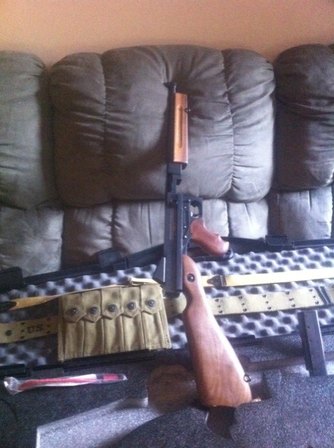

marcus5 Posted February 4, 2012 Author Report Share Posted February 4, 2012 The Thompson is such a hoot to shoot and being a WW2 buff it just add to the fun. I have a nice 5 round mag pouch and belt and original sling what else do you guys think i should purchase to go with it? Link to comment Share on other sites More sharing options...
Gio Posted February 4, 2012 Report Share Posted February 4, 2012 Their are a lot of things you can do to make your Kahr to look like a WW2 Thompson. First find a parts kit with a barrel. That kit would give you a short barrel, Note you would have to have form 1 to make short barrel rifle. The kit will also have a cutts com. and the kit lower can be made to work on your Kahr. buy a layman adj. rear sight and you would have a gun that looks like a WW2 Thompson. The only thing that gives it away is the shorter receiver. It's just money and time Ha,Ha. Main thing is to have fun. Frank Link to comment Share on other sites More sharing options...
marcus5 Posted February 4, 2012 Author Report Share Posted February 4, 2012 Sry I should posted picture of my M1A1 I already SBR on form 1, just wondering what other goodies i could get for it??? Link to comment Share on other sites More sharing options...
