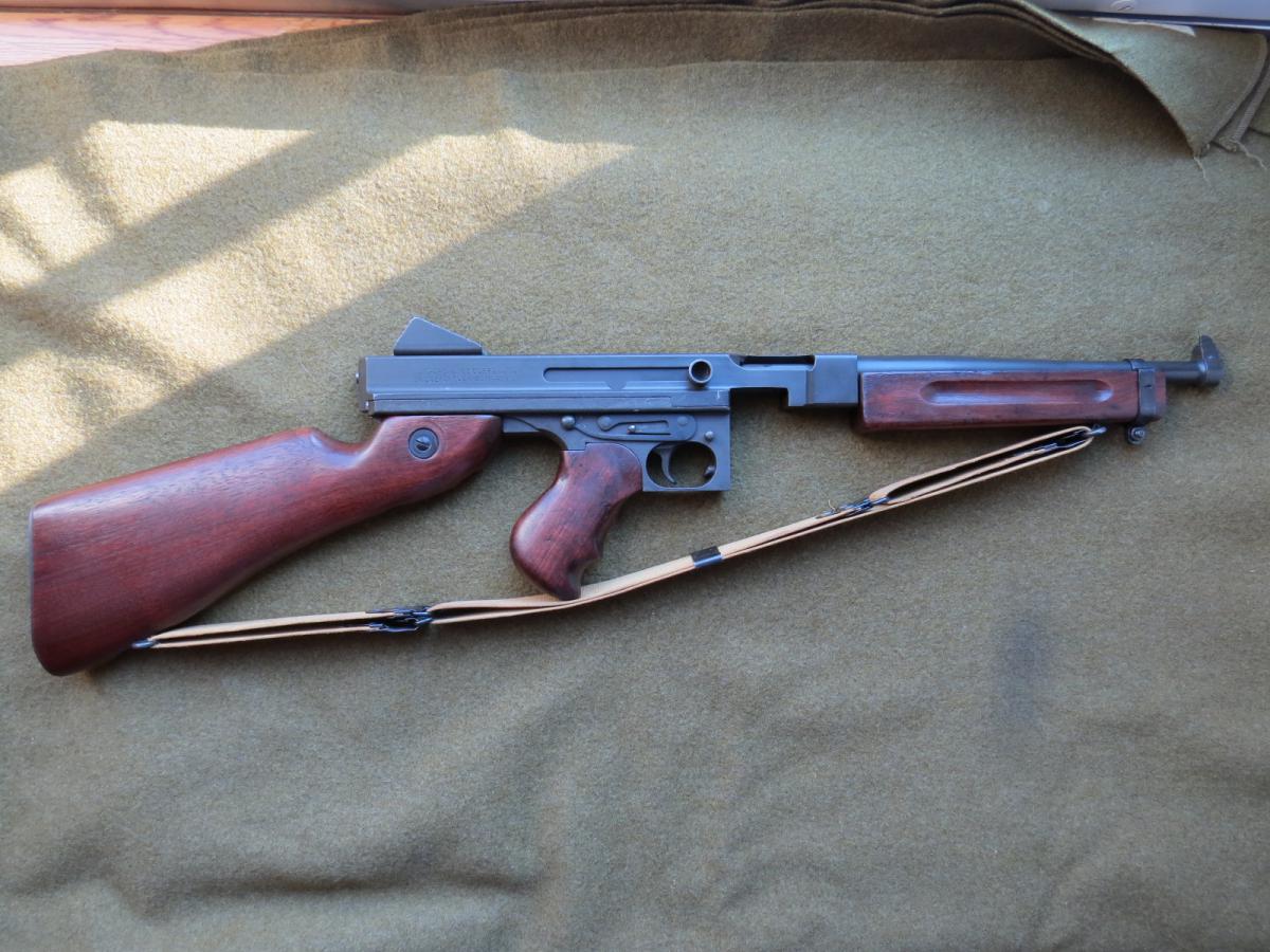

06AngusSG Posted October 18, 2015 Share Posted October 18, 2015 (edited) I would agree with both Bob and Frank. And I find it very accomplishing to do self performed work. WHat I would add is unless you are already very, very, VERY skilled with a power sander (doesn't matter what type) don;t use it for this. You can to easily take out to much wood and ruin the grip/stock's profile. Hand sanding the finish off is tedious but worth it. Below is my before and after in my gun. The foregrip and butt are original Savage finish. The rear grip is M marked and was obviously to brown. I used a combo of Two stain colors and 2 coats of Tru-Oil to get the match in the second picture. Jon Edited October 18, 2015 by 06AngusSG Link to comment Share on other sites More sharing options...

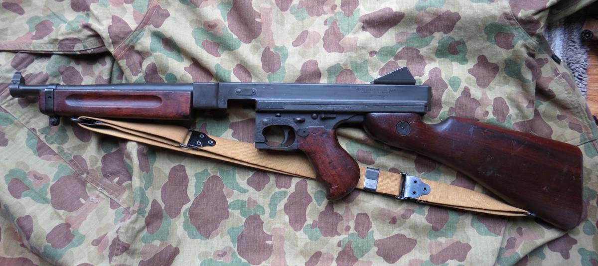

Bender Posted October 18, 2015 Share Posted October 18, 2015 I just redid my 1927a1 wood. Nothing matched(Im not sure if the lower was the one that came with the gun originally. It took about a week to redo it from beginning to end.I wanted the wood to match my '43 SA M1 garand, which has a dark brown/reddish tint. First I cleaned the wood with mineral spirits. Then made my own stain with RIT dye and denatured alcohol. Did as many coats as necessary to get the shade of the color I wanted. Then did a coat of Boiled Linseed Oil everyday for the next week. It looks a little more red in person than it does in the pics....It came out exactly how I hoped. http://i60.tinypic.com/2iax3lv.jpghttp://i61.tinypic.com/muxsug.jpghttp://i59.tinypic.com/5wbc52.jpghttp://i58.tinypic.com/11sp5js.jpghttp://i60.tinypic.com/sy3zp3.jpg Link to comment Share on other sites More sharing options...

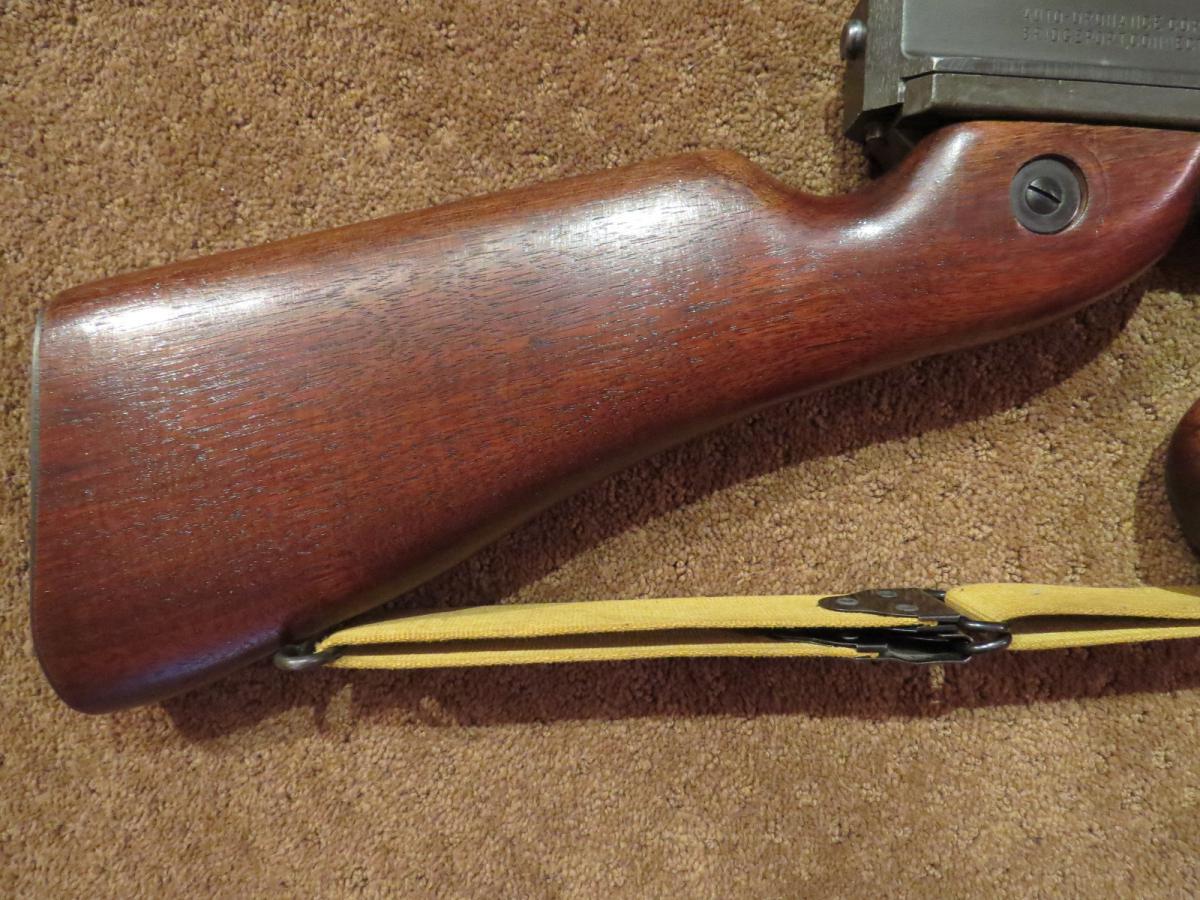

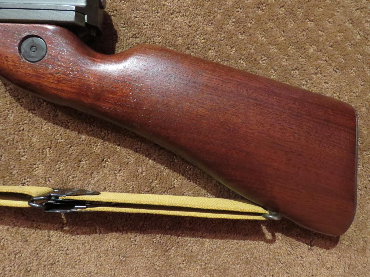

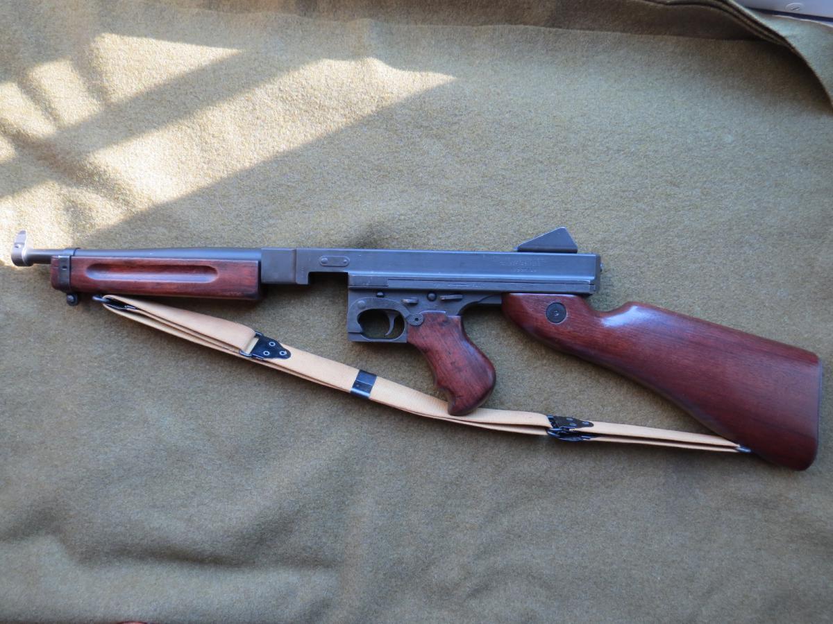

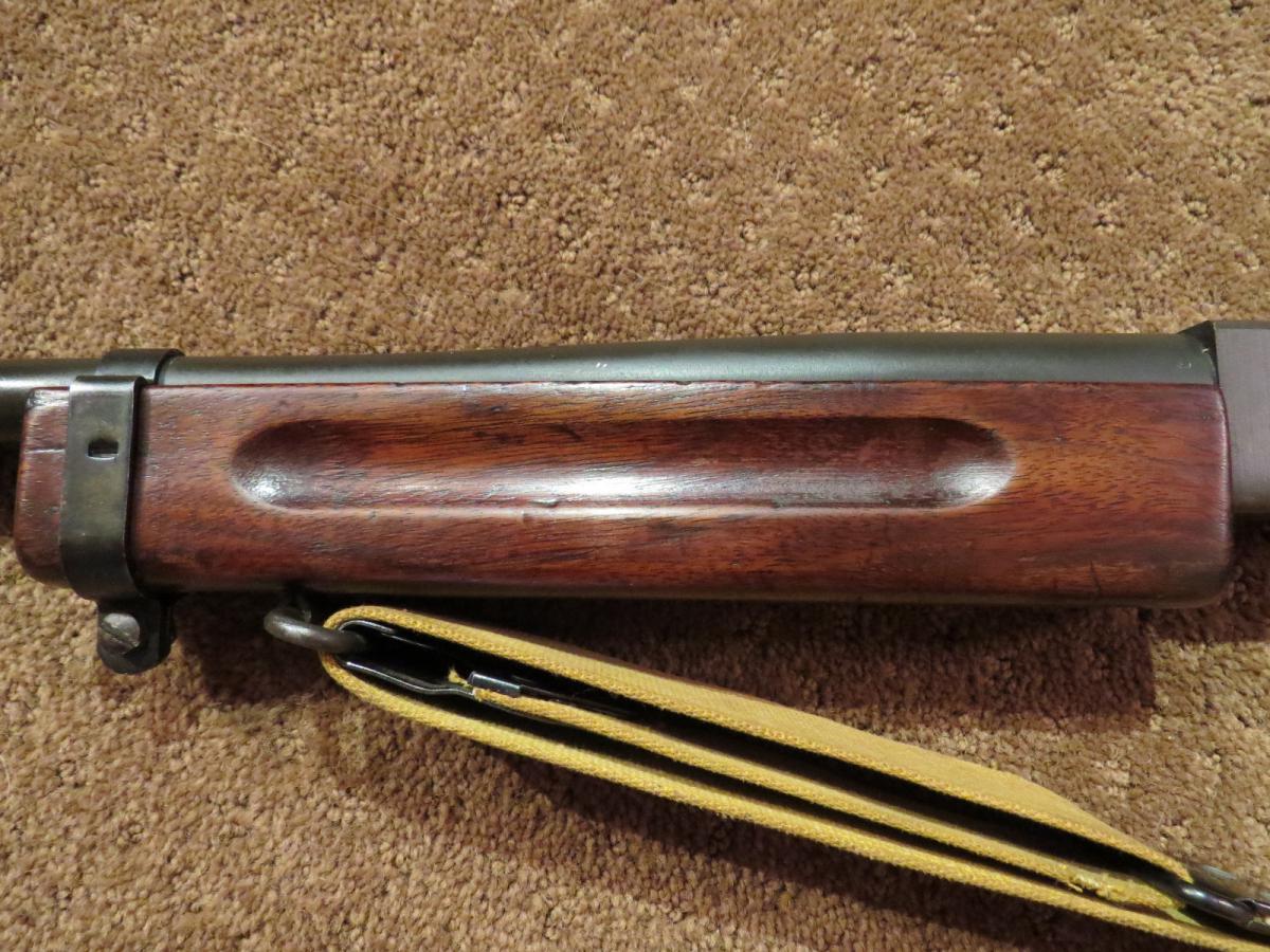

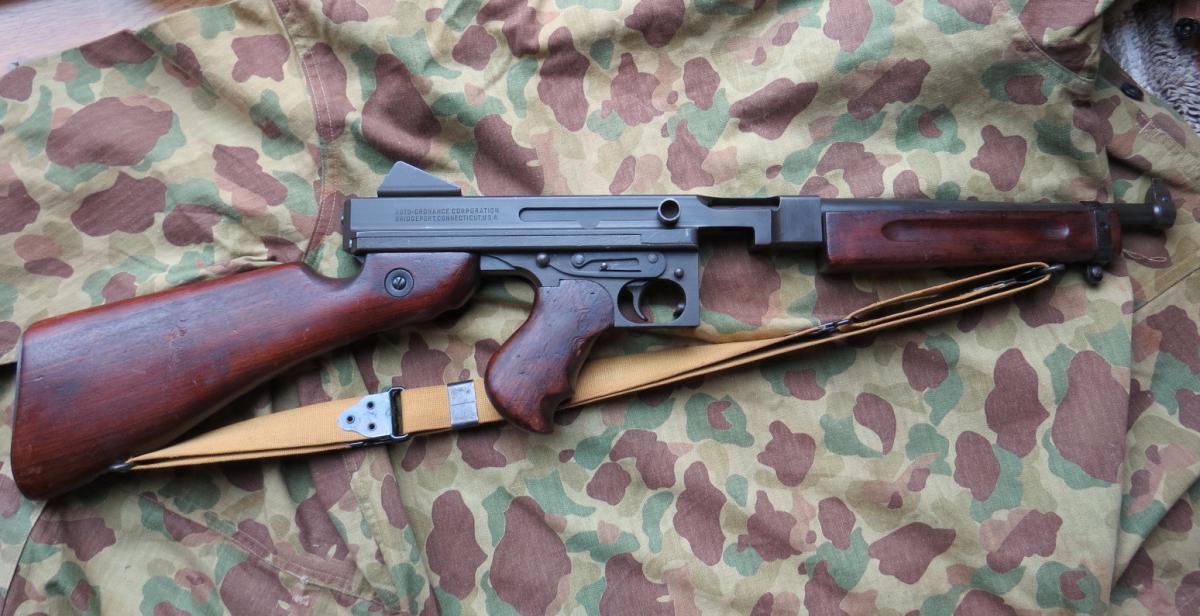

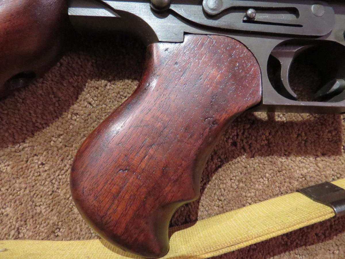

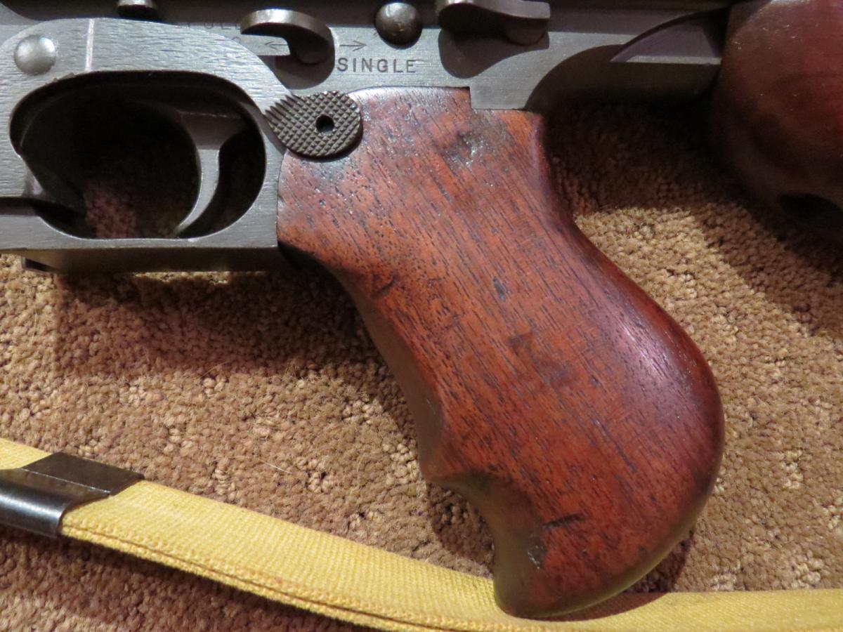

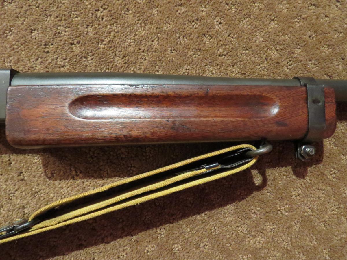

Orion Posted October 20, 2015 Share Posted October 20, 2015 (edited) The instructions on the FAQ section work very nicely, If the wood isn't really greasy or oil soaked I use Formby's Furniture Refinisher with #000 or #0000 steel wool. Then steam what dings and dents that I can lift out then let it dry for 24 hours. I have been using Minwax red mahogany for years and find it works well, I let it dry 24 hours between coats of stain.I use Tung Oil only for the top coat anywhere between 5-7 coats depending on how dry the wood is and again wait 24 hours between coats, lightly steel wool if needed and found it works well. Below are some before and after pictures of my recent M1A1 purchase, I replace the butt stock with a NOS butt stock the original one that came with the gun had too many nicks and dents. BEFORE AFTER Edited October 21, 2015 by Orion Link to comment Share on other sites More sharing options...
