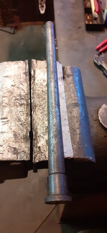

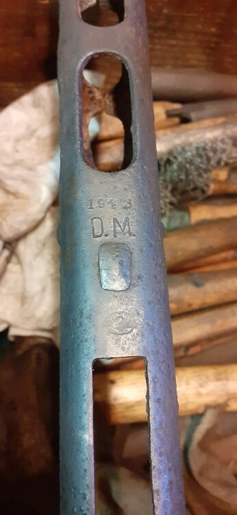

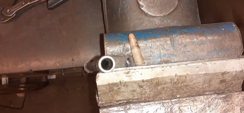

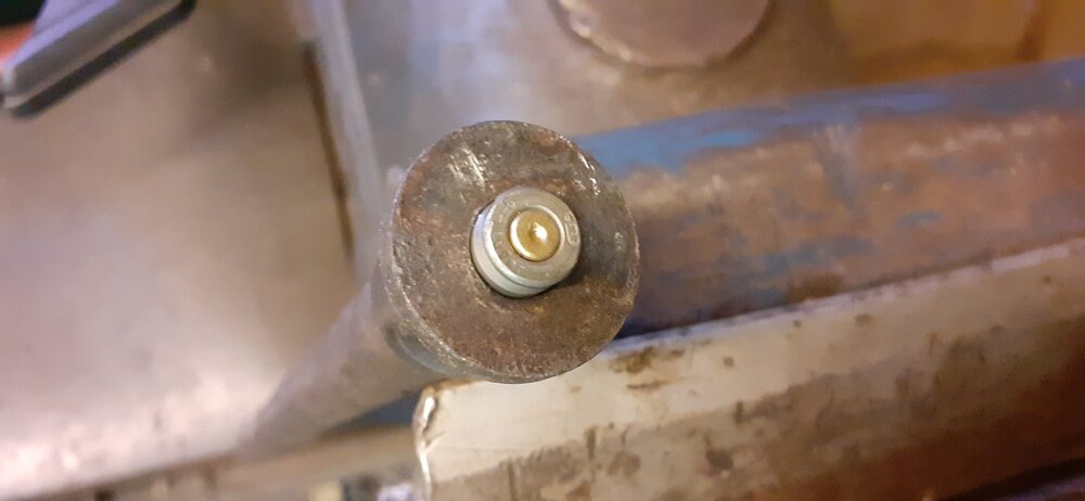

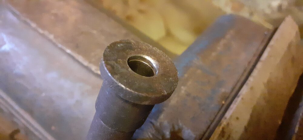

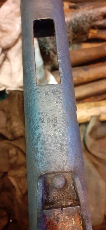

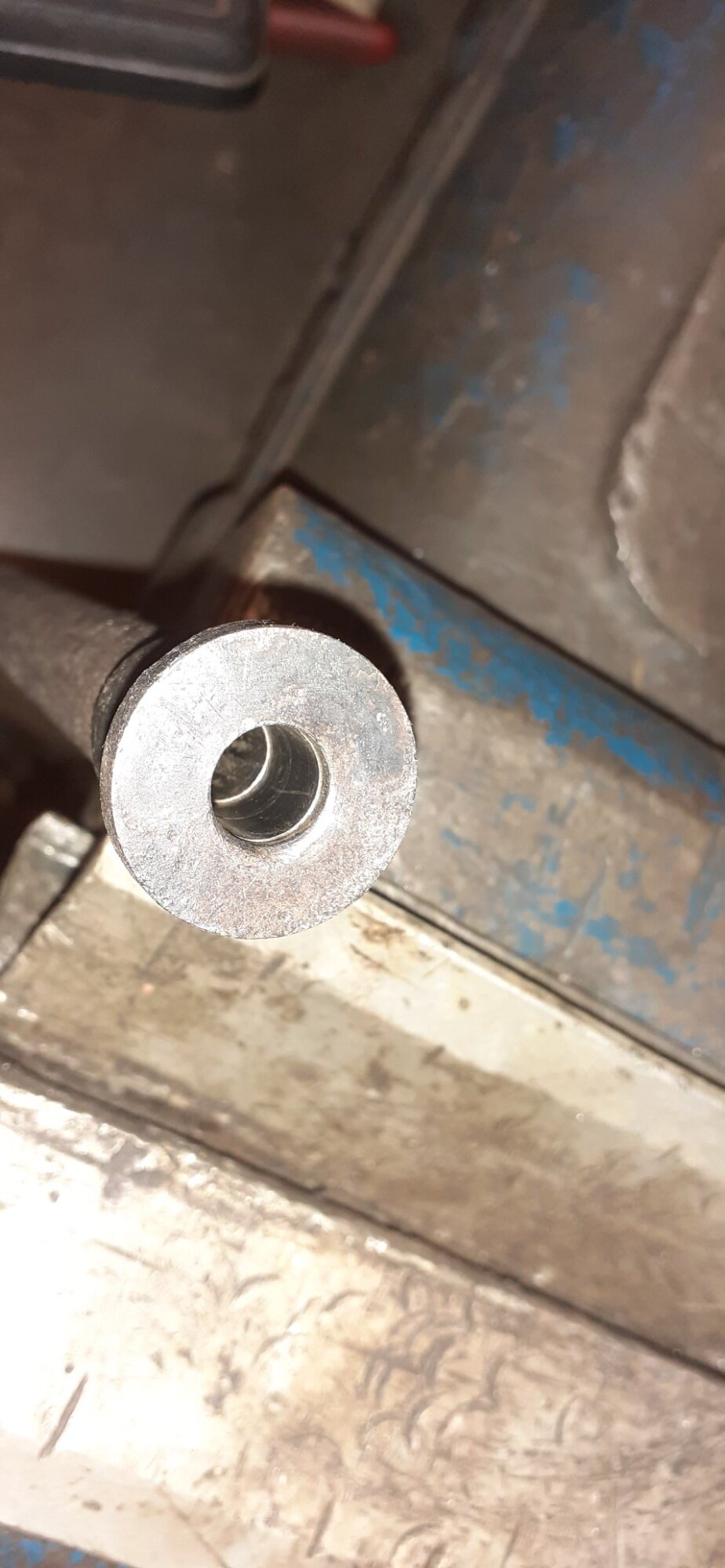

HeinrichM Posted August 1, 2023 Report Share Posted August 1, 2023 A colleague came across this interestingly marked piece during further cleaning of PPsh from a mass find. Instead of the usual "D" marking there is a D.M marking and the conversion to 9mm para is quite different from the other pieces. The barrel is completely specific and there is no modified barrel from the MP 40 used here. Nor is the upper modified like in classic conversions. The barrel has the same profile as the original 762x25 barrel. In the front part of the barrel, the muzzle is drilled to a depth of about 20mm and the chamber of the barrel is also strange, it looks like it is made of two parts and the extension is somehow connected to the rest of the barrel. It is also interesting that the entire interior of the barrel, including the bore of the muzzle and the chamber, is hard chrome plated. There is no marking on the barrel. Outside the marking D.M. in a completely unusual place, there are only the original Soviet markings. This is a piece made in ZiS in 1943 and the breech is not numbered with the weapon, as is the case with almost all pieces from the find Link to comment Share on other sites More sharing options...
