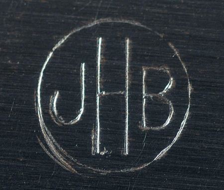

The first Thompsons produced were marked with the stamp of Auto-Ordnances chief inspector, Major John H. Barrett, who was the based at Hartford, Connecticut, during the production of all the Colt Model of 1921 Thompsons in 1921 and 1922. The majority of the Model of 1921s are stamped with his encircled JHB initials.

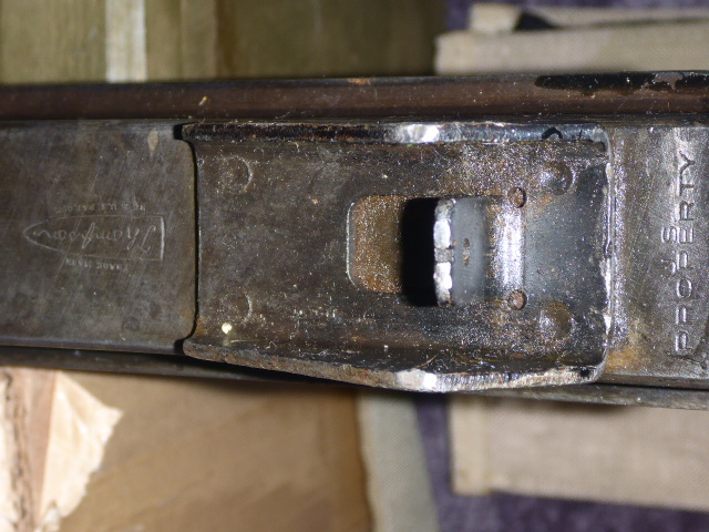

The addition of the 'US' Prefix to the 'Model of 1928' model designation, was a requirement of the Lend-lease Act, to identify US Property. On the M1 and M1A1s this was replaced by the actually wording, 'U.S. Property', being stamped behind the rear sight.
On the 'US Property' marking found on Savage produced M1 /M1A1 receivers, the letters 'U.S.' are roll marked on one line, and the word 'PROPERTY' on a second line underneath. The U.S. Property stamp was marked to be read from the rear of the receiver.

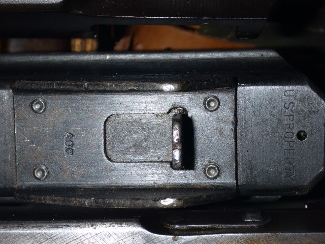

Auto-Ordnance manufactured M1A1s, have the U.S. PROPERTY roll marked on one line, which is readable from the front of the weapon.

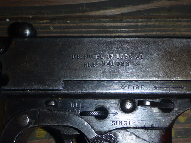

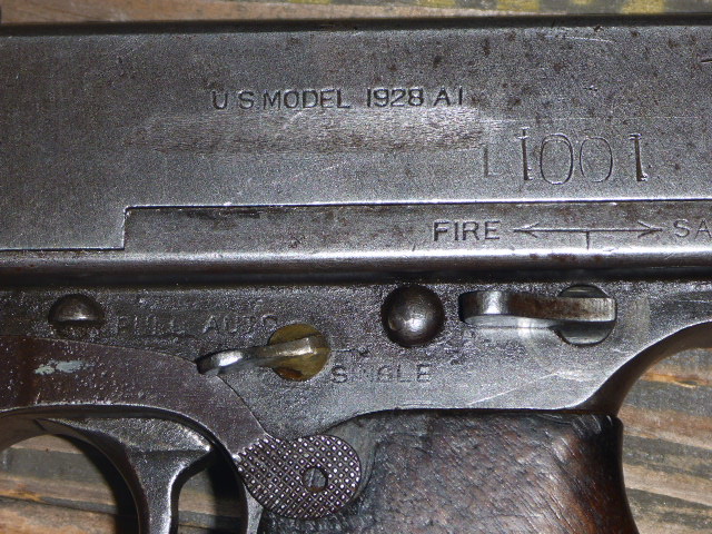

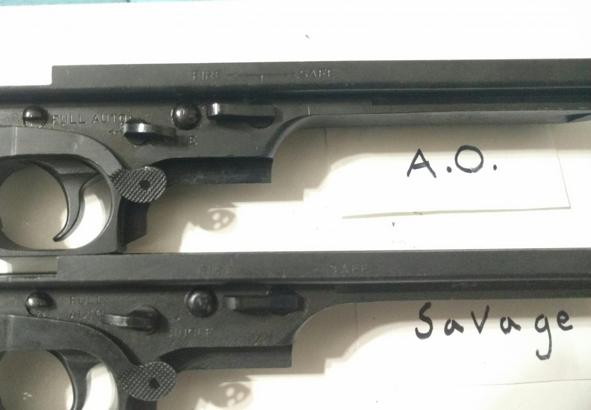

Another subtle difference is found on the trigger assembly; the selectors on Auto Ordnance Bridgeport produced Thompsons are marked, 'full auto', on one single line, while on Savage manufactured Thompsons, 'full' is on one line, with 'Auto' stamped below it..
As you can see from the above photos, another difference was the model designation, the Savage 1928 and 1928A1's read 'US Model of 1928 A1', but the Auto-Ordnance Bridgeport 1928A1's, omitted the word 'of' and read simply 'US Model 1928 A1'.

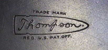

As identified in another recent post, the script in the WW2 bullet logo, has an identifiable difference in the letter 'h'. It was pointed out that the script of the letter 'h', on Auto Ordnance Bridgeport receivers, appears to resemble a letter 'R'.
There were in actually three different Bullet logos used by Auto-Ordnance Corporation over its history, and as identified above, two variations of the third, war time logo.

The third and more common logo, which is found on all WW2 produced Thompsons, retained the word Thompson in the bullet, with the addition of the wording 'TRADE MARK' on the top of the bullet and 'REG. U.S. PAT. OFF.', below the bullet. Both WW2 logo variations are shown below, left from a Savage gun and on the right, an Auto-Ordnance Bridgeport Thompson, showing the difference in the script of the letter 'h'.

Very nice, also the Savage 1928 trigger frames stock slide grooves are longer than the AO stock slide grooves and the auto ordanence trigger frames have more rounded edges where the back of the grip meats the trigger frame
Great post!
Not sure if it goes for all AO trigger frames or possibly receivers, but from what I've seen; AO tends to be a finer finish with less machining marks than Savage.
