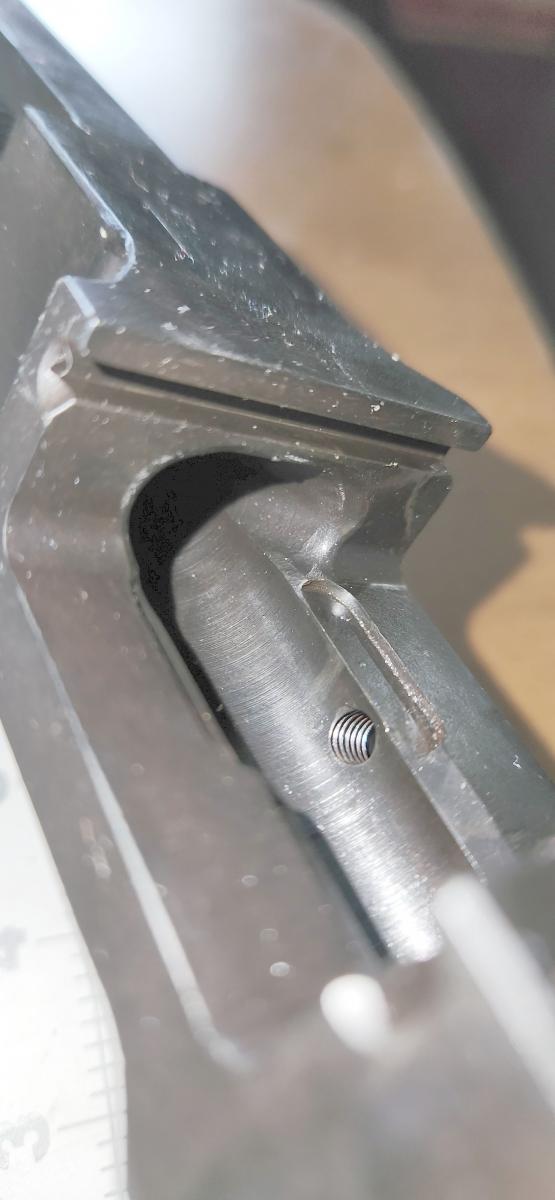

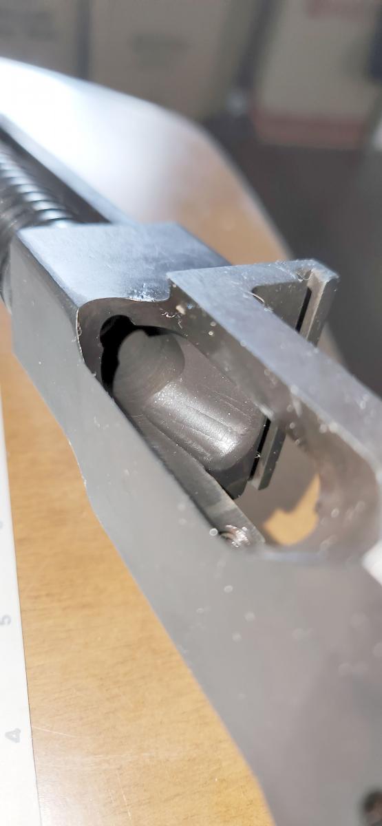

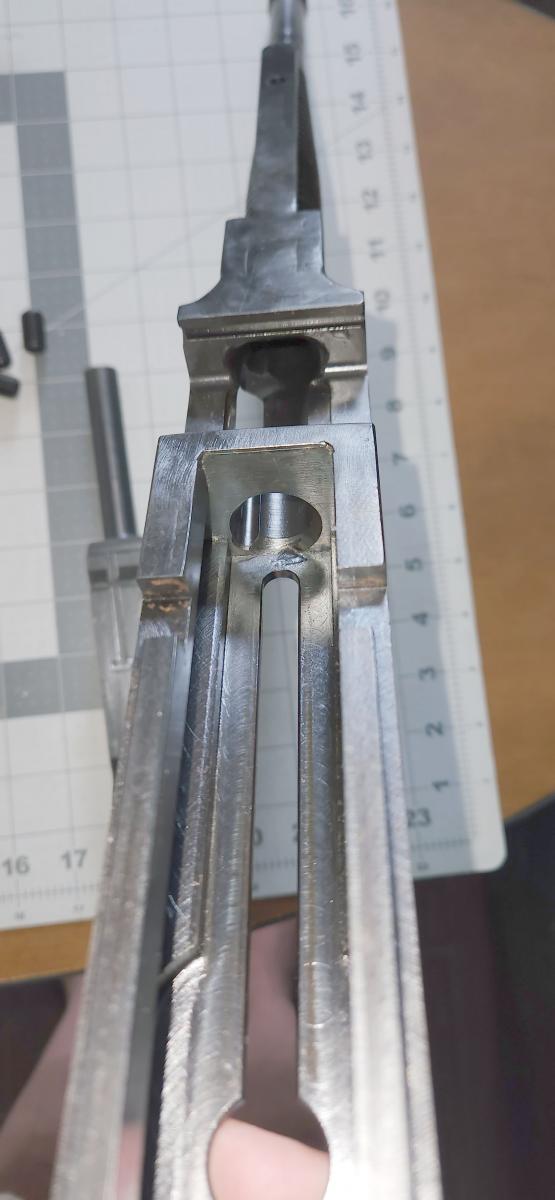

I'll leave it to others to judge the merits of this piece. I will say it is a big bite assembly wise for someone like me who hasn't done drilling, pinning or riveting small pieces.

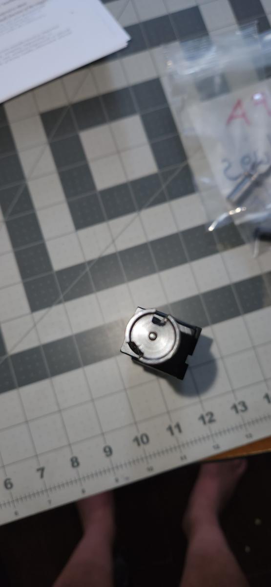

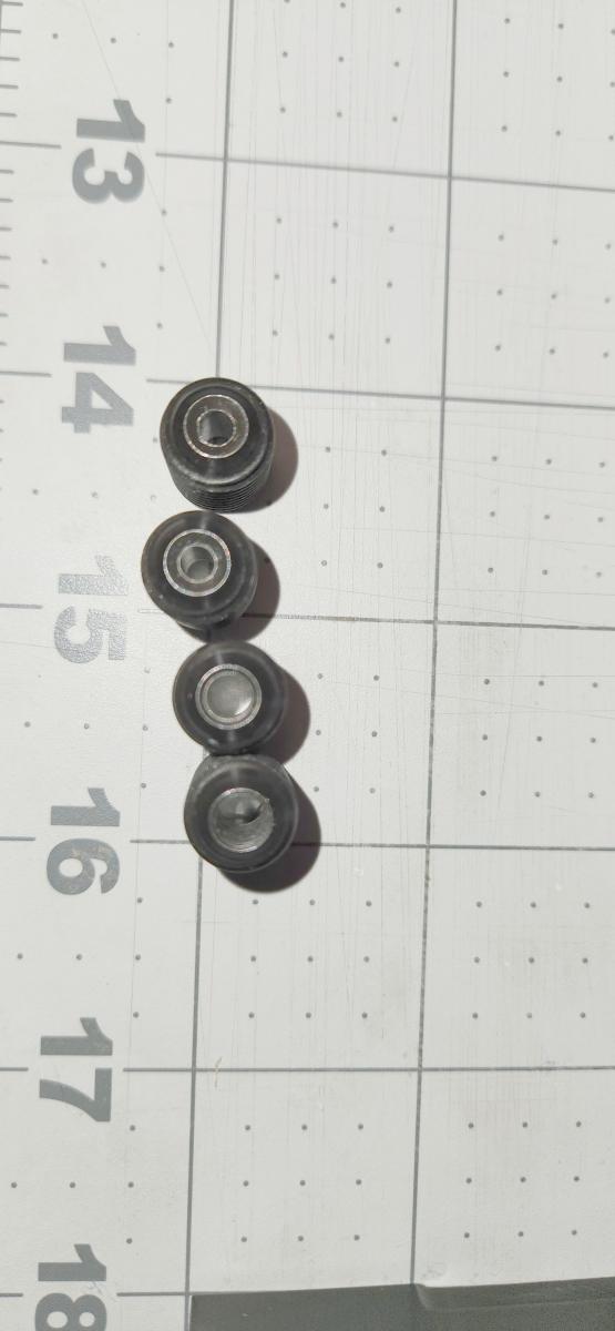

I will send an email to Indy Ord. I got a set of barrel plugs to 'tune' the gun. In the documentation there is also instructions for tuning via a set screw near the chamber that is marked 'tune' I think.
Also attaching the NFA letter. The Indy patent number is clearly visible in the NFA letter which has some diagrams and description of operation.

Thanks for sharing these photos and PDFs with us on this kit. It is very interesting to see how the whole setup is done and even how the bolt handle is retained/indexed in the bolt and receiver when fully assembled. Is the IO M1928A1 BFONG kit in the white or is it blued and my eyes are just playing a trick on me? If it is unfinished, does it come standard without a finish, or did you specifically ask for it to stay in the white so you could finish it to your preferred finish?
The finish is blu, I emailed indy ord for advice to get the lower, sights and compensator to match. The appearance is Blu so I don't think it's sandblasted, I did ask if was sandblasted.
The white appearance in the photos is because they were rather dark. I just put the lighting adjustment on full blast to bring out the details. The knob is unfinished.
I don't have anything threaded to put in the hole on the left side opposite the ejection port, so I asked about that too.
The hole is for the ejector. You're probably supposed to use an original GI one.

Ok, just confusing that the provided instructions give specific directions on using the plugs, then seperate directions for calibration using a marked set screw.
I'll just assemble it and see where I'm at.
