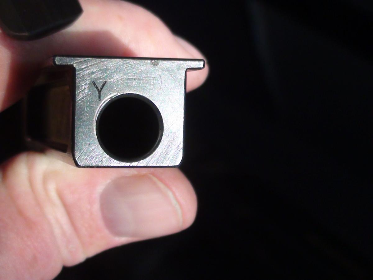

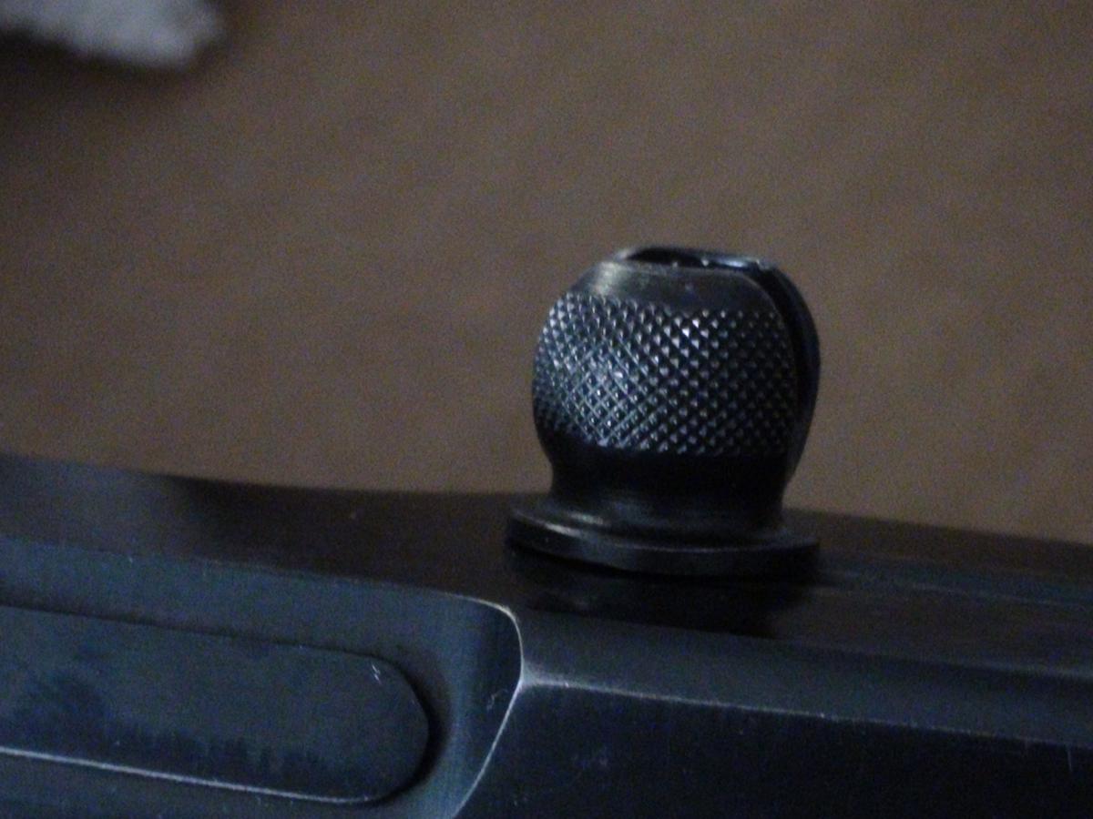

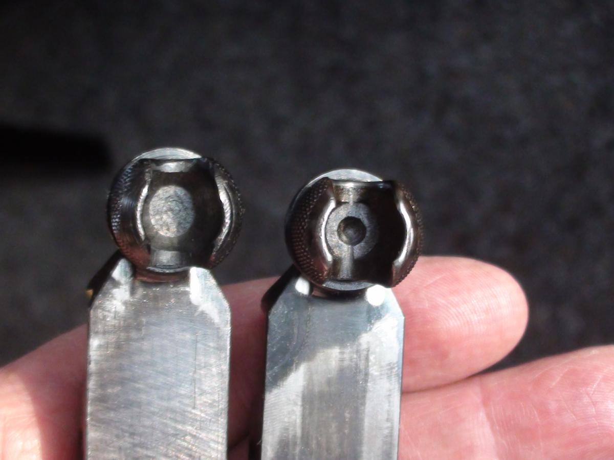

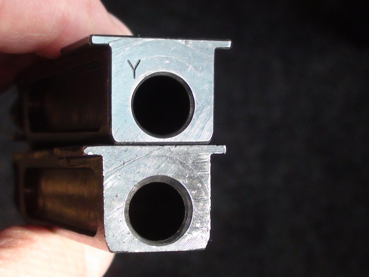

bug Posted February 2, 2014 Report Share Posted February 2, 2014 A friend has a beautiful 12K Colt navy. He mentioned to me that it had a 1 pc actuator. I could hardly wait to inspect it and satisfy my longing to finally see and handle one of these things. The knurling looked great and surely Colt. What do I find on the back of it? Yep, the big Y. I checked the archives but it wasn't clear what the Y is for. I don't think Yale&Towne made actuators for AOC. This particular Y is oriented 90 degrees CCW from the one pictured in the archive. Anybody know what this is?? Link to comment Share on other sites More sharing options...

gijive Posted February 2, 2014 Report Share Posted February 2, 2014 Arthur, I just checked out the link to the previous thread on the Y marked actuators. The one pictured certainly looks like the Colt style knurling and ball shape. Could the Y be merely an inpector's stamp and not Yale? Yale was a WWII contractor and obviously had the "Y" contractor code assigned, but the Colt style actuators were made before WWII, so the Y doesn't necessarily have to represent Yale. What do you think? Link to comment Share on other sites More sharing options...

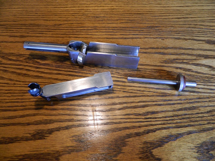

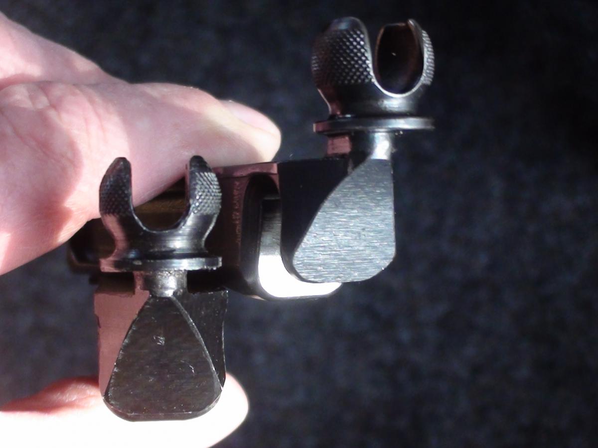

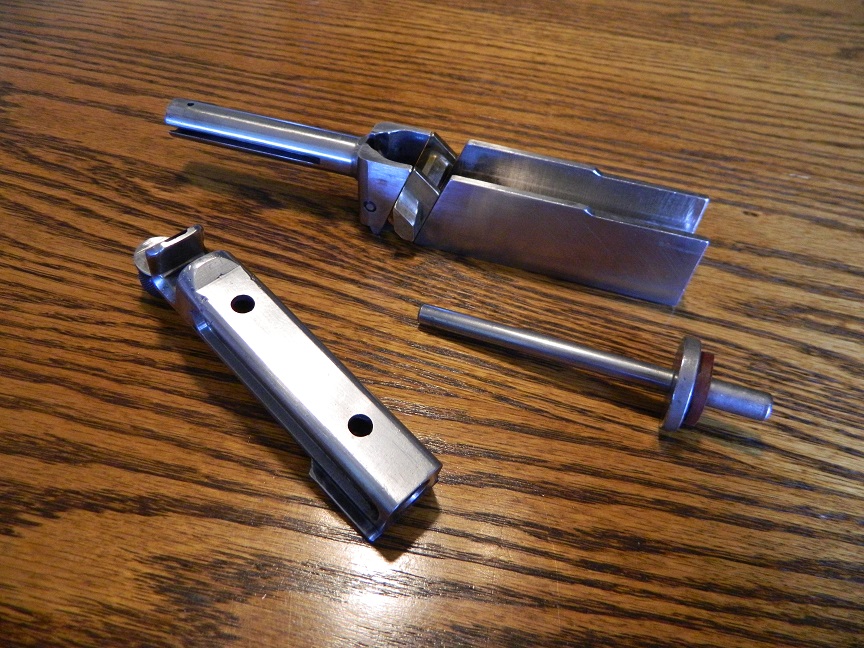

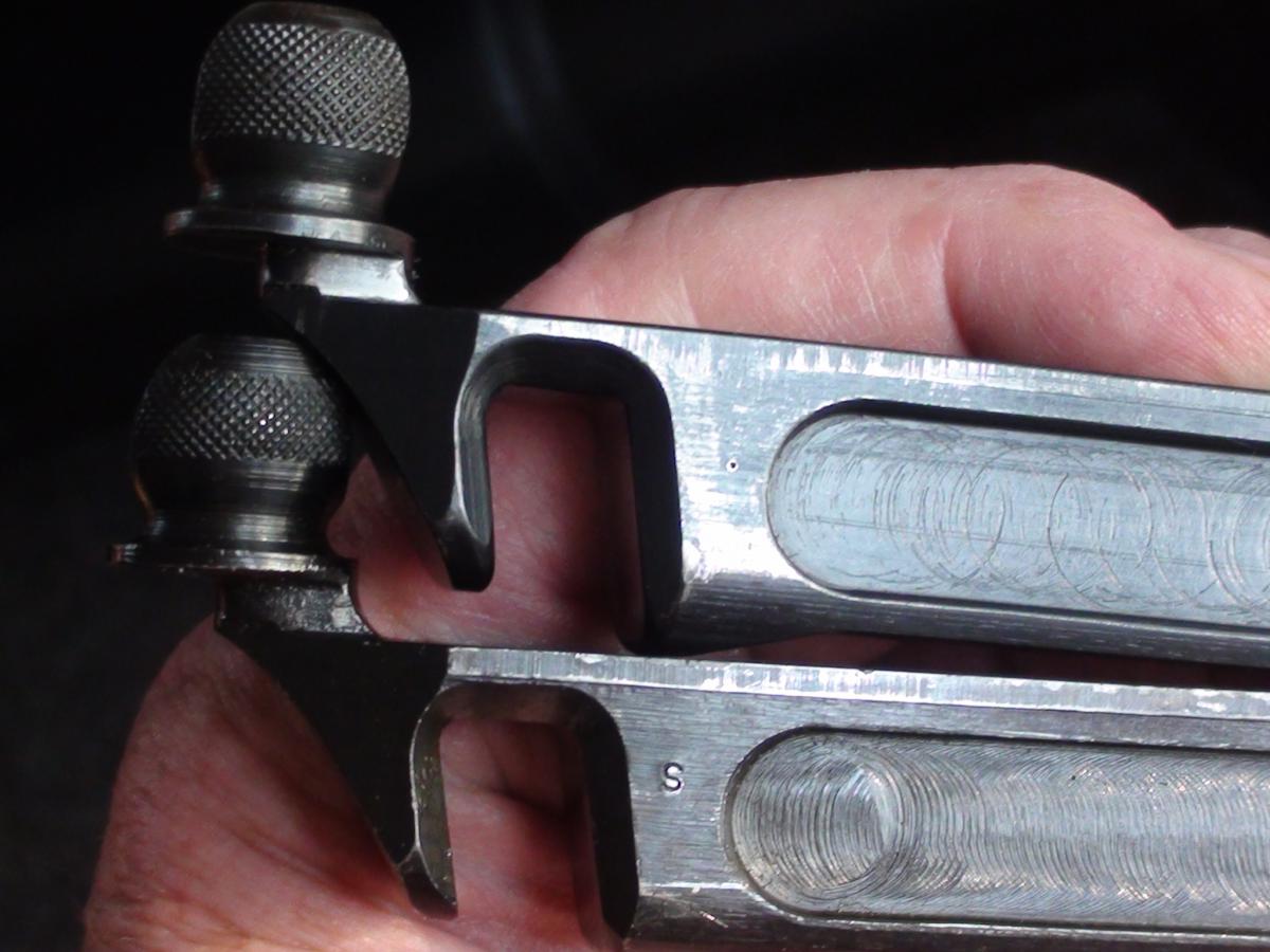

bug Posted February 2, 2014 Author Report Share Posted February 2, 2014 Need pics of the rest of the actuator to determine if it is indeed a Colt part from 1930's. Does it it resembles the two actuators with the "Y" stamp discussed here: http://www.machinegunboards.com/forums/index.php?showtopic=12142&hl=%2Bcolt+%2Bpiece+%2Bactuator&do=findComment&comment=101230To my untrained eye it looks a lot like the Gutter rat pictured one.I managed to get a few pics of the thing with my Savage unit for comparison but it was done quickly... #1 Unit in gun#2 Y unit above Savage#3 Same#4 Same#5 Sav left. Y unit right Link to comment Share on other sites More sharing options...
Arthur Fliegenheimer Posted February 3, 2014 Report Share Posted February 3, 2014 Arthur, I just checked out the link to the previous thread on the Y marked actuators. The one pictured certainly looks like the Colt style knurling and ball shape. Could the Y be merely an inpector's stamp and not Yale? Yale was a WWII contractor and obviously had the "Y" contractor code assigned, but the Colt style actuators were made before WWII, so the Y doesn't necessarily have to represent Yale. What do you think? It does seem that the "Y" that has now shown up on several possible 1935 era actuators for the Colt Navy has nothing to do with Yale or any Ivy League institution............. Perhaps it is an inspector's stamp. That we will ever know what the initial stands for may be as remote as discovering the names that are represented by the "D" "C" "Z" "F' "U" "O" "P" found inside Colt receivers/frames. What we do know about this 1-piece actuator is that it was blued, weighs 6 3/4 ounces, has a .49 inch cove width on the weight and the knob knurl width is .30 inches. Link to comment Share on other sites More sharing options...
