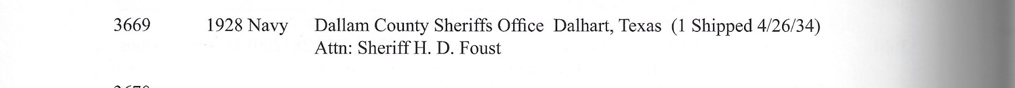

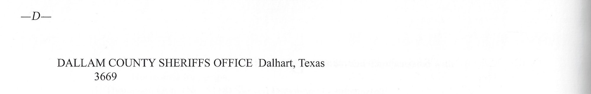

Your gun has the following information posted in Gordon Herigstad' s, Thompson Submachine Gun Book. These two volumes have the most thorough information on all 15,000 Colt Thompson Guns. Your gun has a smaller, First Type Compensator, which is correct for the sale date of the gun. All Colt Thompsons were made without compensators and had them added.
