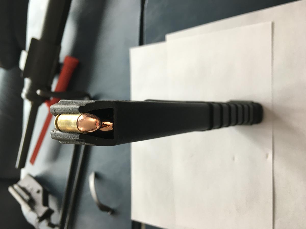

Blanksguy Posted April 19, 2020 Report Share Posted April 19, 2020 John in IN,When you set your Grease-Gun up to use those TAPCO MPA 9mm Magazines...…….are they single-position-feed magazines like the Sten (and 45ACP Grease-Gun mags)……..or are they two-position-feed (?). Maybe a clear photo of the top of a loaded magazine for us to reference.....and possible help sort out some owners with issues setting their Grease-Gun up in 9mm (?). If you have an original 9mm Grease-Gun Magazine-Well sheet-metal adaptor...…..could you put a few measurements to this hard to find item...…..maybe height, width, depth...…...and maybe the thickness of the sheet-metal ._ _ _" Sooner or later (even though only a few would be bought)…..someone will take the time to produce a good replica of this. Regards, RichardSUS Army, RET Link to comment Share on other sites More sharing options...

John in IN Posted April 19, 2020 Report Share Posted April 19, 2020 As far as the magazines go, I think they are the usual GG double stack, single feed design. I also have a Tapco loader which works great, but the regular .45 loader works well too on these 9mm mags. I'm not sure where all of these mags went?? They used to be all over GB but seem to have dried up for some reason. I'm sure it wasn't because of GG 9mm conversions! John Link to comment Share on other sites More sharing options...
Blanksguy Posted April 19, 2020 Report Share Posted April 19, 2020 John in IN,Thank you very much for those photos......they really do help. On the TAPCO Magazine.....to me, it appears to be a single-center-feed type magazine as are the original Grease-Gun magazines....and those for a standard Sten-Gun. Last, could you post a clear photo of the magazine-well-adaptor inserted from the bottom of the magazine-well for us (?)…...TIA. Regards, RichardSUS Army, RET Link to comment Share on other sites More sharing options...
