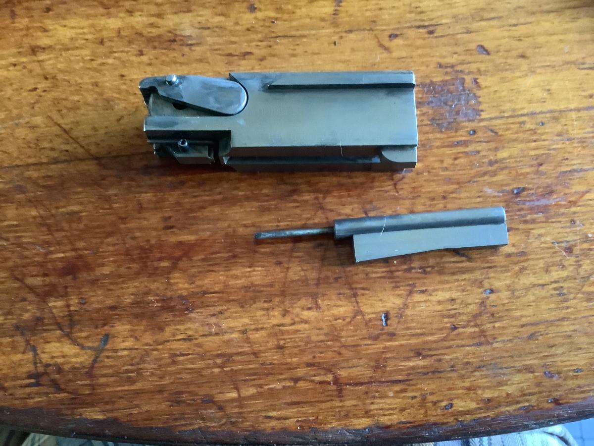

BRMCII Posted March 21, 2022 Report Share Posted March 21, 2022 (edited) I have examples of the FA 1917, 1919a4 and a semi A4, and they are striker fired, closed bolt.I've never heard that the M2s were open bolt.I assume they are also striker fired since that's the system used on the others.Pic of striker and A4 bolt. Edited March 21, 2022 by BRMCII Link to comment Share on other sites More sharing options...

BRMCII Posted March 21, 2022 Report Share Posted March 21, 2022 (edited) Does your bolt have a spring loaded striker? I doubt it.I would assume from seeing that video that all of the the FA M2s are open bolt, then.Not the semis though..... Edited March 21, 2022 by BRMCII Link to comment Share on other sites More sharing options...
Got Uzi Posted March 21, 2022 Author Report Share Posted March 21, 2022 It has a striker that was brazed solid to the bolt assembly. I had to cut it loose as the firing pin didnt stick out to impact the rim AND it would have been in the way to file the rim slot on the bolt face. It appears to be setup as an open bolt gun and would fire as such but idk if its correct or not. First one Ive had my hands on so idk. Link to comment Share on other sites More sharing options...
