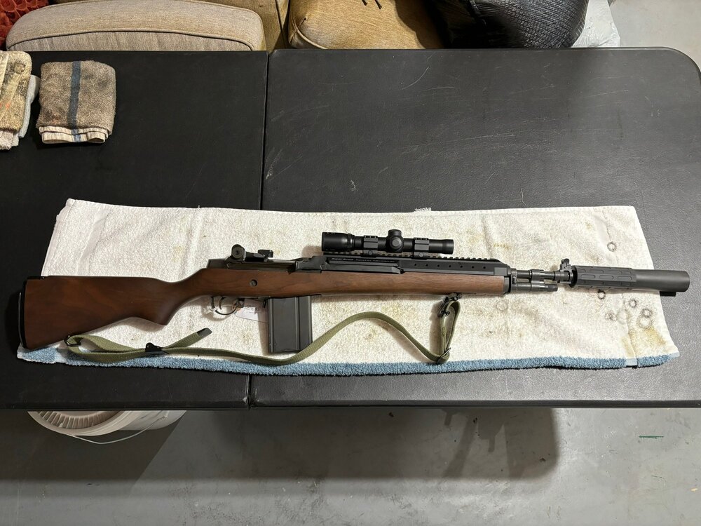

Rekraps Posted February 22, 2023 Author Report Share Posted February 22, 2023 (edited) On 2/21/2023 at 8:36 PM, johnsonlmg41 said: How did you know you wouldn't get an end cap/baffle strike? Or did you just take the gamble? The M1A (M14) are, as you know, not designed for suppressor use. The Flash hider and corresponding end barrel threads are not always concentric. So.... to your point, I use an alignment rod to gage concentricity when mounting the suppressor. My success rate on these projects is about 50%, meaning that of the nine M1A's I own, only four were manufactured with the threads concentric enough to allow for the can alignment. This is why I have dedicated M1A's for suppressed. Here's a photo of the complete rig. Very nice shooting gun. Edited March 3, 2023 by Rekraps free up space Link to comment Share on other sites More sharing options...

Rekraps Posted April 3, 2024 Author Report Share Posted April 3, 2024 Pic of finished product. SA M1A Scout Squad, with GemTech One, using S&B 200gn subs. This ammo runs excellent.... but remember, the gun must be hand cycled. Link to comment Share on other sites More sharing options...

Rekraps Posted May 13, 2024 Author Report Share Posted May 13, 2024 Did a bit of backyard plinking with my M1A set up with a GemTech One can. Used S&B 200 grain subs and the thing is really quiet. Manual cycling of course, but accurate as heck out to 100 yards. It's interesting shooting a .308 round and there is a time lag between the shot and the bullet hitting the steel plate. See the pic of my gun above, however I really like this set up. The Burris 2.75x Scout Scope is a perfect match for the gun and the ammo. Link to comment Share on other sites More sharing options...
